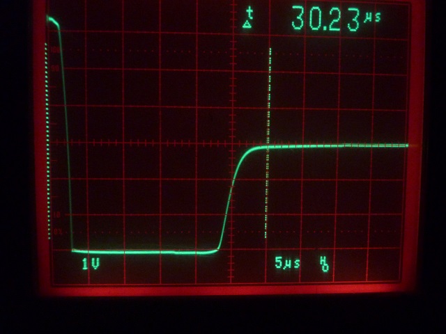

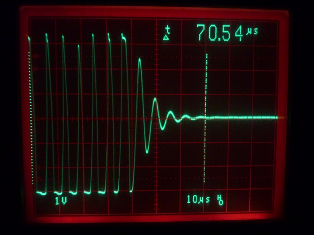

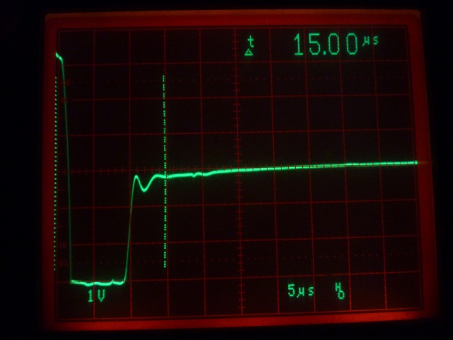

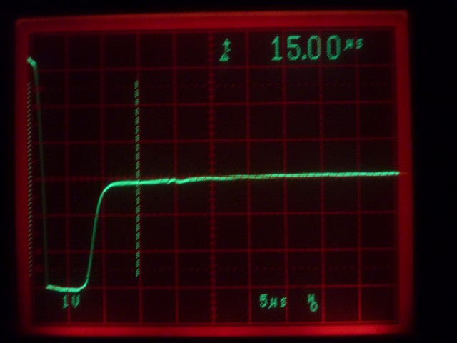

    I have been trying alternative mosfets as some newer devices appear to have a better spec than the IRF740 which I have used for many years. The latest device tried is SiHA22N60E which at first glance appeared to be very suitable. i.e. Vds 600V, Rds 0.23 ohms and Coss (output capacitance) of 90pF. By comparison the IRF740 has Vds of 400V , Rds of 0.55 ohms, and Coss of 330pF at 25V Vds and Vgs 0V.
    Another transistor that works well is the P5NB40 which also has a Vds of 400V and a much lower Coss of 72pF at a Vds of 25V. The Rds is a bit higher at 1.5 ohms though. This device is good for short sample delay times as the lower capacitance in parallel with the coil/cable results in a higher ringing frequency and a higher value resistor for damping. However, for both devices the Coss is voltage dependant and rises for lower values of Vds. In the case of the IRF740 the figure rises to around 600pF and the P5NB40 to 110pF at 10V Vds. 10 to 15V Vds is that which is likely to be encountered on a PI metal detector.
    In the case of the SiHA22N60E the value of 90pF is for Vds of 100V and which reduces to 73pF at 480V. Below 100V the Coss rises rapidly such that at 10V it is about 3000pF: an unacceptable figure for a PI transmitter. Ringing, with a 300uh coil and 1.5m of RG58 coax (100pF/m), is severe due to this high value of added capacitance. Damping of 150 ohms is required rather than the 1K for the P5N40. Substituting a P5N40 mosfet gives a smooth recovery as seen at a two stage x1000 gain preamp o/p.
ID:	371214 P5NB40 with 1K damping. Click image for larger version
ID:	371215 IRF740 with 1K damping. Click image for larger version
ID:	371216 22N60E with 1K damping. Click image for larger version
ID:	371217 22N60E with 150 ohms damping.
    Looking at the Coss capacitance graphs, it does appear that running the mosfet at a higher Vds can be beneficial in minimising this unwanted capacitance. For the IRF740, 20V appears to be the value below which the Coss starts to rise fast. For the P5NB40, 15V would be a good voltage as the Coss is still below 100pF, but rises fast below 10V. These voltages may give rise to excessive current in low resistance coils unless low repetition rates are used. The next task is to raise the coil resistance and/or insert series resistance such that the mosfet can run at the higher voltage but maintain a reasonable pulse current and repetition rate.
    Eric.

              The MUR460's arrived and I tried one out this evening; first with the 22N60B which has the highest capacitance at low voltages. Fantastic! it worked, and remained working. I tried a considerable assortment of mosfets of different voltages and Rds-on resistance. All worked fine with the diode, IRF740 too. A FQA24N60C seems a good candidate and another one tried was 17N80. I have made a jig that I can just plug in mosfets without turning off the power supply each time. Got quite a shock when holding the tab of the 17N80 and accidentally touching a ground point.

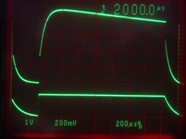

                    This is a new investigation for me, and fascinating it is. I managed to get some sensible pictures of what is going on at the junction of the mosfet drain and the series diode. At least they make sense of the voltage that is stored in the output capacitance of the mosfet. The top trace is the voltage, where one large division = 100V. (100M resistor to a x1 probe) It rises to about 450V and then drops to about 380V at the start of the next pulse. The transistor used is a 24N60C which has 650Vds and a Coss of 100pF for Vds above 100V. Rds is typically 0.14 ohms. The coil current is shown in the lower waveform and measured across a 0.1 ohm resistor in the coil return. peak I is 2.4A. Without the diode this transistor would not be useable due to the high Coss at low voltages. The supply here is 10V where Coss is about 3000pF, which you certainly don't want across the coil. I am surprised that there appear to be no high current, low Rds, mosfets on the market that have a built in series diode. The High Coss must be a disadvantage in other applications? I am wondering if the slow rise to maximum Coss voltage is due to capacitances in the probe circuit. 100M and 1pF gives a TC of 100uS. I have a high voltage x100 probe coming next week which should give a more accurate picture.
                    Eric.

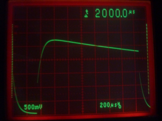

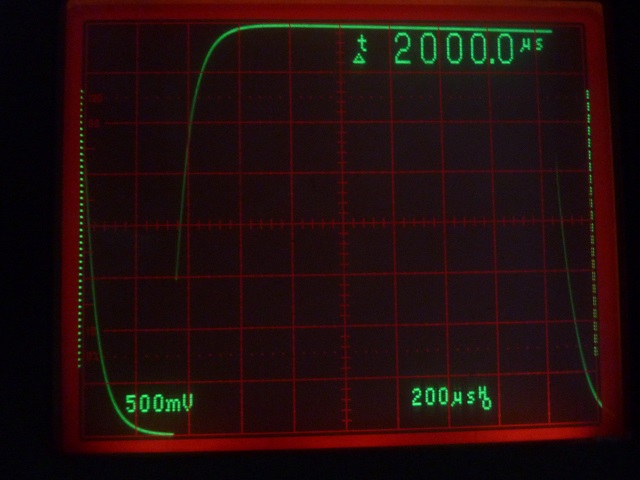

                              Being in an experimentive mood, I thought I would see what effect adding more capacitance to the Coss would have. I added 1000pF in the form of a 350V polystyrene capacitor between source and drain of a 24N60 mosfet, and then a humble IRF740. The result was surprising. Below are scope shots for the IRF740. First, without the 1000pF and the second, with. With the capacitor there is no measurable drop between pulses of the 400V, and we are getting the full 400V instead of 275V as in the first shot. The 24N60 had similar results but a slightly lower voltage. The receiver waveform showed no change in either situation. Counter-intuitive but it appears to work.
ID:	355591 Click image for larger version
                              Eric.
