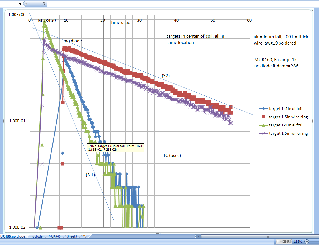

    A chart I posted few years back. I have been using a diode for a long time with my testing and the detector I'm playing with. Can sample sooner. Looking at the chart, don't see why there would be a difference in detection distance with the targets charted. Think higher amplitude with no diode is due to a higher charge volts(no diode drop)? Would expect a difference with a target time constant around 1us(1 or 2 grain nugget). Maybe I'm missed something?

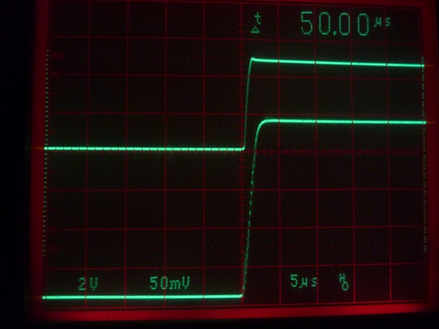

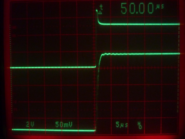

      Being in an experimentive mood, I thought I would see what effect adding more capacitance to the Coss would have. I added 1000pF in the form of a 350V polystyrene capacitor between source and drain of a 24N60 mosfet, and then a humble IRF740. The result was surprising. Below are scope shots for the IRF740. First, without the 1000pF and the second, with. With the capacitor there is no measurable drop between pulses of the 400V, and we are getting the full 400V instead of 275V as in the first shot. The 24N60 had similar results but a slightly lower voltage. The receiver waveform showed no change in either situation. Counter-intuitive but it appears to work.
      [ATTACH]48311[/ATTACH] [ATTACH]48312[/ATTACH]
      Eric.
      Surprising indeed! It would appear by the fact that the receiver waveform showed no change, that the added 1000p added across drain-source had no effect on the capacitance seen by the coil/damp circuit... interesting. Also, it appears that the bleed-off (without the added 1000p) is probably occurring across Cdg as it is the primary contributor of Coss (according to documentation I have read on MOSFET theory, Coss is made up of primarily Cdg plus body diode capacitance). It would be interesting to know the in circuit dynamic resonant freq of the coil and then calculating the capacitance seen at the coil. I think you could increase Rd untill you got significant ringing and then adjust scope trace to only see the ringing and use the FFT view to see the frequency. All of this is extremely interesting and like you say... "counter-intuitive". And I really like the last observation... "but it appears to work"!

        Series capacitance such as putting a diode (with it's capacitance) in series with the coil and MOSFET will limit the capacitance as seen by the coil due to the fact that the total capacitance will always be slightly less than the smaller of the series capacitances. Example: a 1000 pf in series with a 100 pf will be calculated to be 90.909 pf. From my experiments, anything you can do to reduce the total capacitance as seen by the coil design itself, coax cable capacitance and TX circuit will allow a higher Rd value which in turn will allow earlier sampling. Once more point that I saw on Eric's forum was a research article that said that to fully stimulate a target the discharge coil TC (coil inductance divided by Rd) should be 5 times faster than the target TC. Herein lies the reason why detecting small 1us TC targets requires full stimulation to assure maximum sensitivity to these targets. If a 300 uH coil has a 1000 ohm Rd the coil discharge TC would be 0.3uS. This would be good for a 1.5uS target. The best Rd for this 1uS target would be 1500 ohms to fully stimulate it.
        The next issue is the coil diameter relative to the target size and TC but requires understanding how to do this critical balancing act to maximize the total performance on low TC targets. Eric was one of the first PI designers to use the Lock-in Amplifier effect to integrate many RX samples to improve the signal to noise ratio and detect very weak signals normally lost in noise.

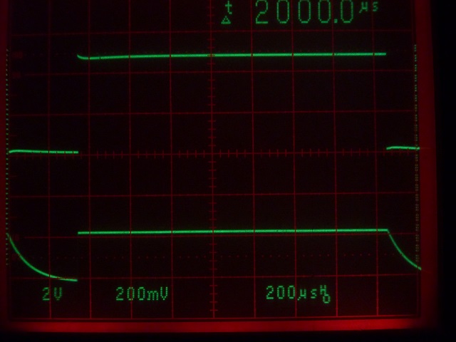

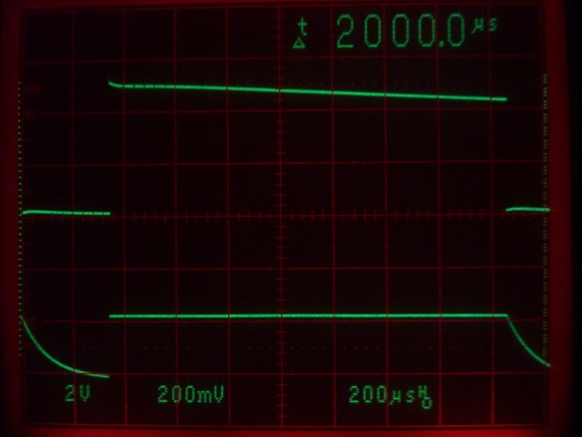

          A few more quick tests today. I have a few 2000pF polystyrene caps in my component store so I had 2 in series for 1000pF; 1 for 2000pF and 2 parallel for 4000pF, and 3 parallel for 6000pF Using a IRF740, I get 400V for 1000pF, 350V for 2000pF, 300V for 2//, and 260V for 3//. Since the back emf charge is the same, it make sense for the voltage to go down as capacitance is increased. For the internal Coss, as it is a voltage dependent capacitance, could it be that as the charge leaks away, the capacitance rises, giving of itself a drop in voltage, hence contributing to the slope when no additional fixed capacitance is used? None of the above capacitor values has any effect on the RX recovery for which sampling could occur at 10uS with the coil and cable used
          at 2A peak coil current.

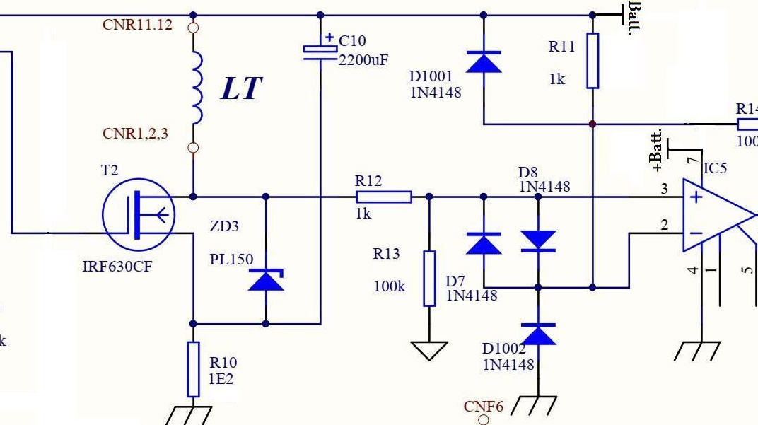

                    I am having diy Pulse Star 2 on the bench these days.
                    It shows up great potential in course of the "depths" , considering what i can see now in experimental conditions.
                    And when i say "deep"; i mean literally "deeeeep".
                    Also very agile and fast recovery on targets (LF411 in front end).
                    Fet is IRF630.
                    However... there is a 150v/2W (i put 180) zener diode across the fet.
                    How about that? Any free thoughts?
                      Zeners are quite noisy.
                      However Pulse Star 2 doesn't seems to me like a device doing early sampling (probably more like >=20uS at the lowest setting) so the zener effect won't be important.
