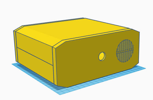

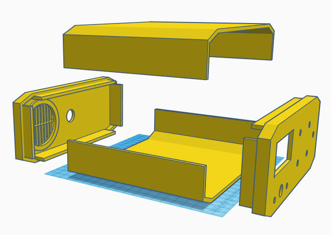

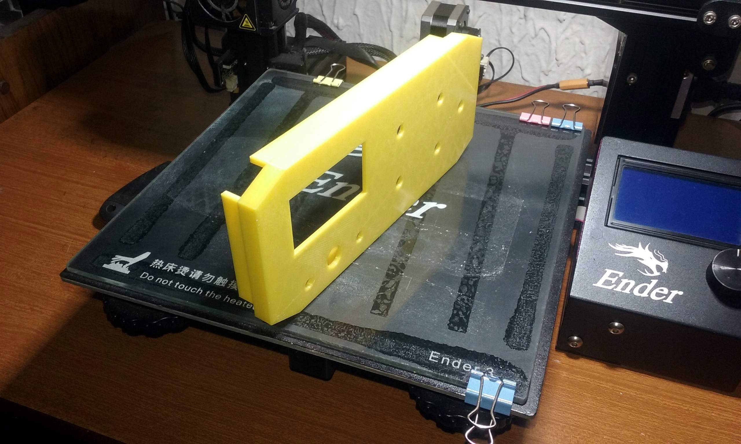

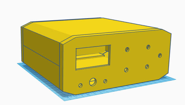

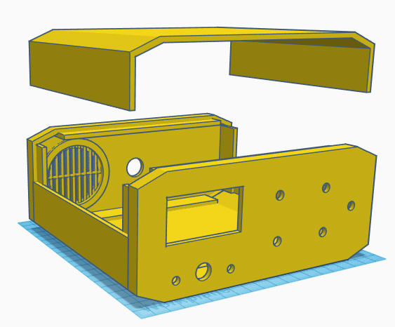

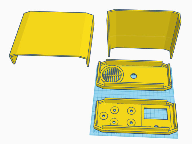

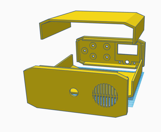

                  This would be third attempt to draw enclosure for Pulse Star.
                  It is not that hard to draw 3D objects. But it is very tedious to make it that right so parts not to print for days.
                  First two attempts gave me "~2 days" approximated duration of printing some parts!!! Hell no!
                  So i had to "break down" larger parts to smaller. Lot of trade offs.
                  Now this is more acceptable respecting the printing duration.
                  Panels will print within 6-7 hours each, upper and lower sides within 9 hours each! LOL!
                  This of course if we are alright with acceptable printing quality and moderate smooth surfaces.

                    Awesome enclosure desing!
                    You must have a perfomant calculator to draw these 3D models .
                    How greath is the durability of the 3D printed plastic material?
                      It can be great if prepared well. If "sliced" well.
                      Kids in USA are making real shooting guns from filament.
                      3D printing is not a joke; it's almost a "science".
                      Needs certain learning curve and lot of practice.

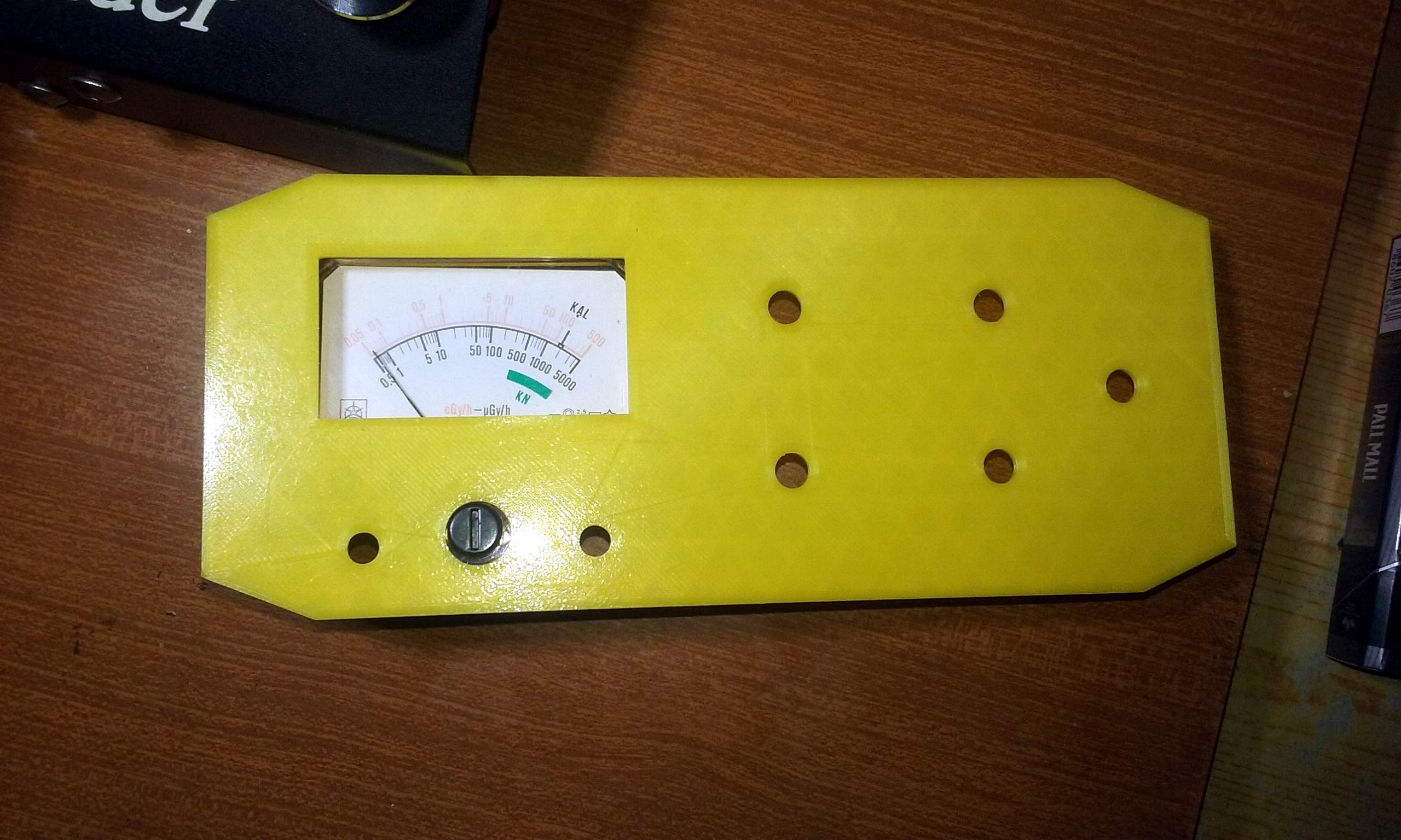

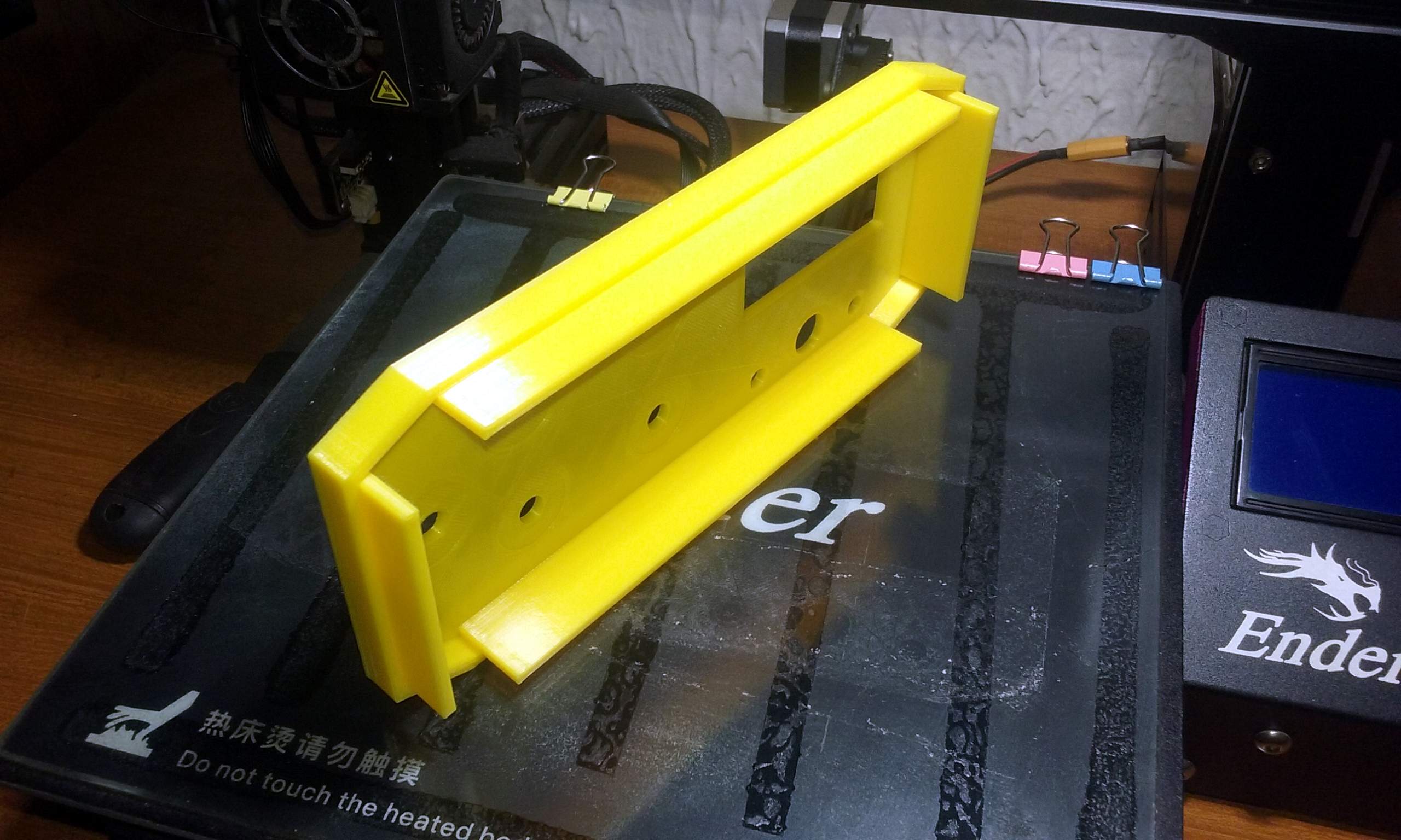

                            First piece finished after ~6 hours.
                            Smooth, robust and quite alright.
