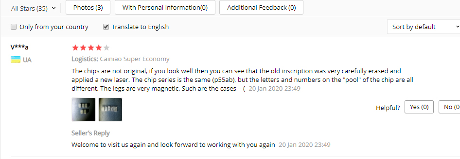

    chinese manufacturers must do original LF357, not fake they do now. then we will get good reasult.
    this is one and primary MAIN cause of all troubles. i can give you million customers' reviews screaming that the chips are fake.
    in this state of China manufacturing actuality novaday that is lowest and unhonest we are not able to get the stabile parameters of the deepers.

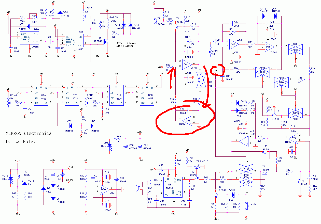

      kt315 You are right. It seems that lf357 is hard to buy. Of course, in addition to the chip, the circuit design is also critical. Can we add some control circuits, such as the problem of temperature drift?
        this schematic was projected to protect from any kind of drift, so why it is so complicated. nothing critical.
        your problem is in my opinion you do not wish to devote attention to right shielding of housing
        in full measure. i told much times that if shielding is absent people get just headache. this price for the carelessness.
        you must remember always - original DP is working and working perfect. if your DP is not working good
        thats only your problem. also, you use poor acubattery. made in China, eah?
          I can't understand how dp prevents drift, it has no circuit design to prevent drift
            first stage is UNICAL. this is way to kill drift of opamp in EVERY time period. open surf open bara open MPP. you DO NOT SEE THIS WAY NOWHERE!!!
            DP IS UNICAL ADVANCED SCHEMATIC. i tell you about one way you must see other.
Name:	Delta Pulse_sch_oldie.gif
              Thank you, kt315, what is the role of the line from t2 to 4538?
                please do not do me brilliant member with 100000 posts. you have to learn yourself because
                i am not professor of Preston university technology cathedra. my job is street wiper.
                open the link and read https://www.google.com/search?q=basi...h=842&biw=1280

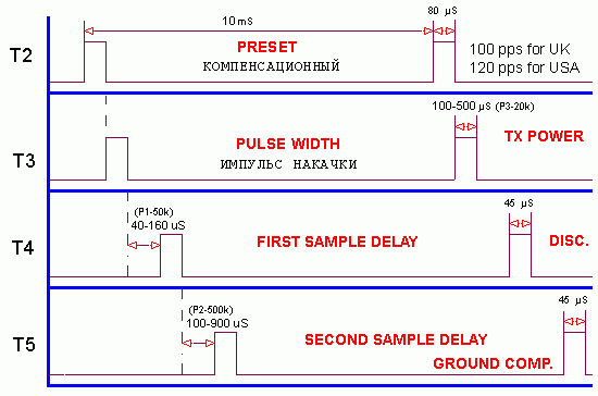

                  When metal is near the sensor, overload occurs and the signal disappears. The node on transistors T2 and T3 generates pulses varying in length, which move all the strobes away. When there is no overload, these transistors do not participate
