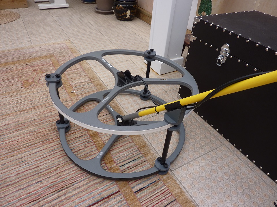

            Can anyone provide a solution to the impossibility of using pulse detectors under high-voltage lines? How to eliminate the interference of high voltage wires, thank you
            A very effective way of eliminating overhead power line noise is to use a differential coil arrangement as in the picture. Lower coil is mono TX and RX. Upper coil is identical, damped the same, and is for noise pickup. It is fed into the opposing input on the preamp and cancels the noise picked up by the lower coil. The other method is a figure of 8 type coil, but the response is more complicated.
            Eric.

              Thanks for advise mister Eric.
              As i see from the picture main requirement is to keep both coils on the same position to avoid phase dismatching. I think what if keep just a small and lightweight coil fixed anywere on the shaft instead of standard big one, but i guess this simplification may do circuit more complicated.
