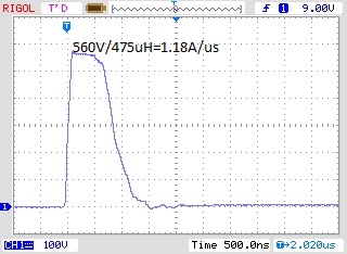

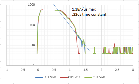

Scope picture of Tx off with constant rate(160us on, 1A peak), picture with log V to show time constant(adjusted damping).
Coil TC(.22us), AWG19 open TC(2.8us), AWG19 closed TC(28us)

Let's see If I understand right. When you say TX, cc 5ms, I understand that your TX pulse ramps up for 20us, to 0.5Amps, then maintains the current constant for 5ms (-20us) then drops to about 0A in 1.8us. (It looks as if there is some avalanche on the mosfet).
So I understand this as 0.5A/1.8us= about 0.277A/us.
To get the ampere-turns for the field strength, we would need to know how many turns on the TX coil and the diameter of the TX coil.

The coil Tx above was done with constant rate 160us on time with 1A peak. The coil is fast so mosfet does avalanche at about 560V. Not sure what you are calculating, I'm thinking di/dt=E/L. 1.18A/us at avalanche or 2.1ma/us at 1 coil Volt. Only time decay rate is constant is at avalanche. Maybe wrong?

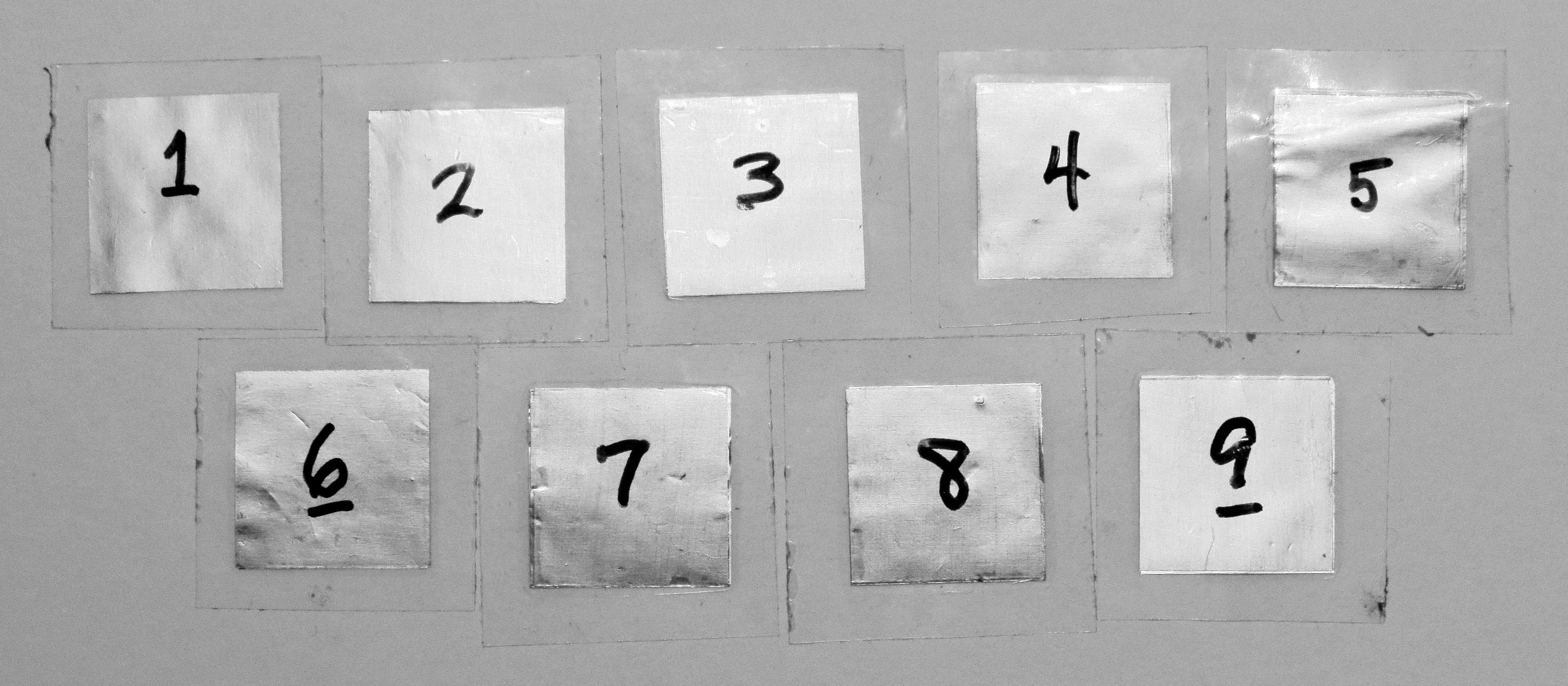

I make test targets out of aluminum foil, each is 1" square with thicknesses of 1x, 2x, etc up to 32x.
On a VDI machine they progressively read foil up to about a zinc cent. In theory you could keep increasing the thickness and match silver coins. In fact, I have an aluminum token that exactly matches a silver dollar on a V3.
And if you pound silver thin enough, it will read as aluminum. Point is, with eddy responses any metal can mimic any other metal.
