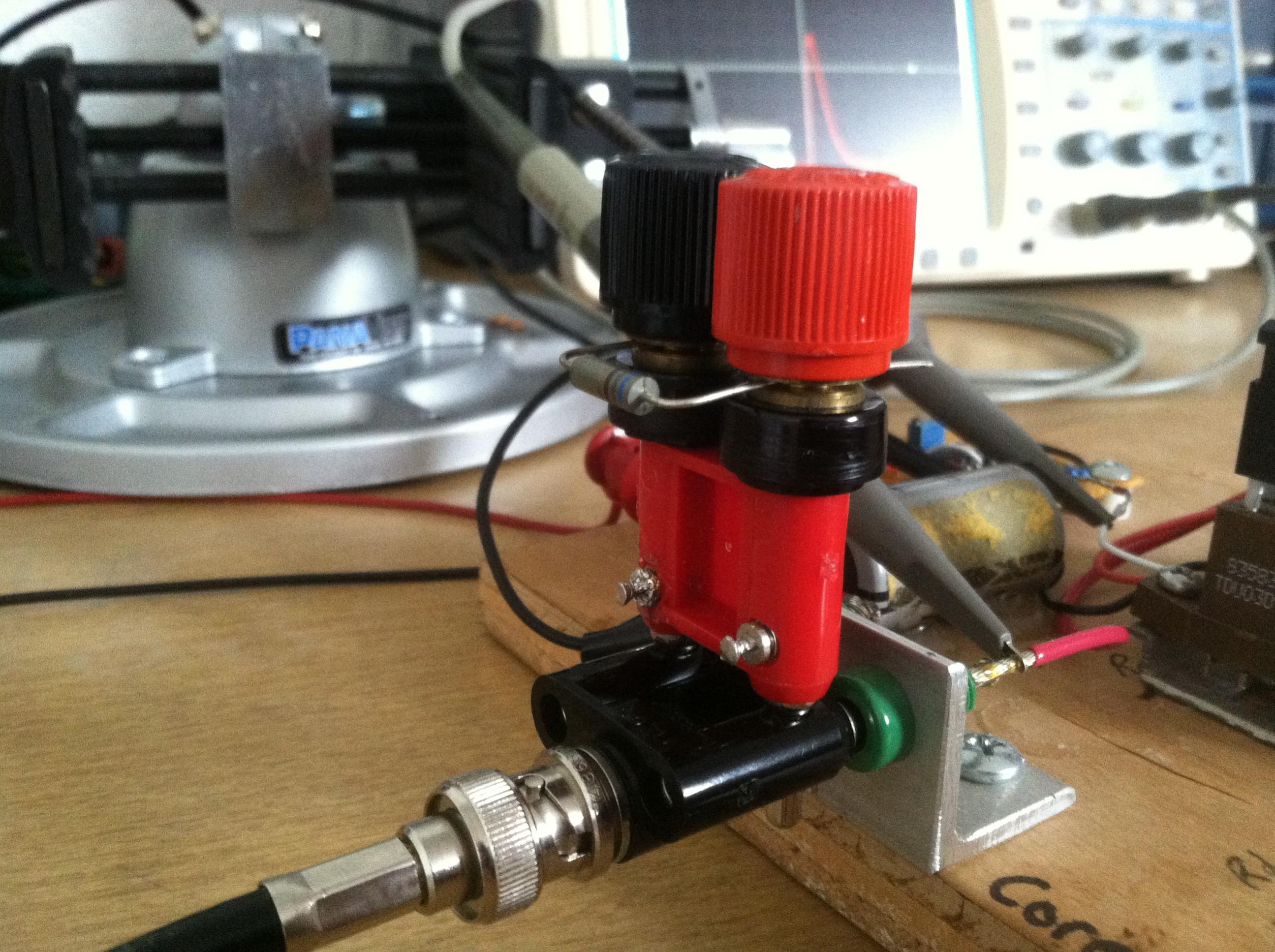

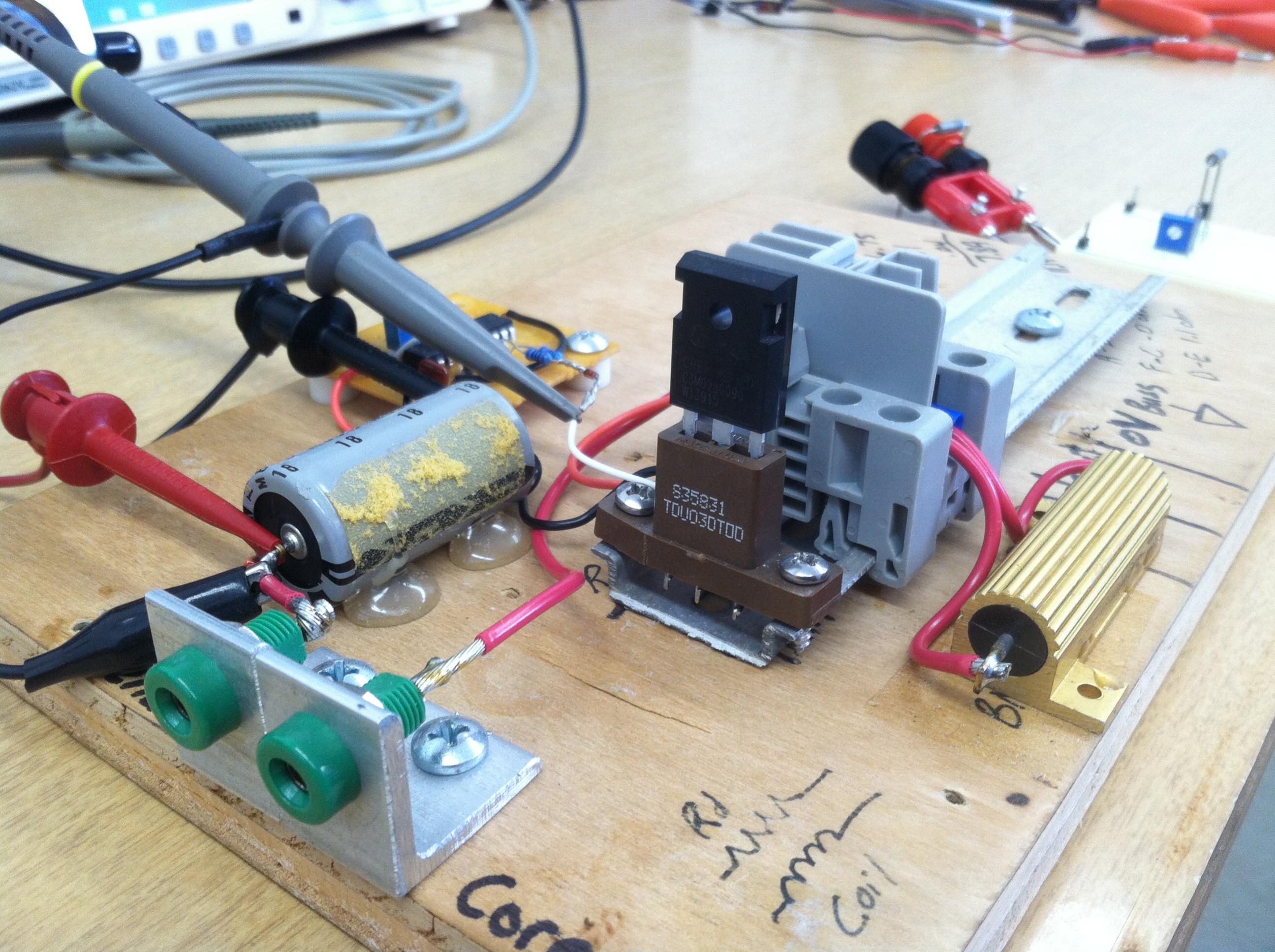

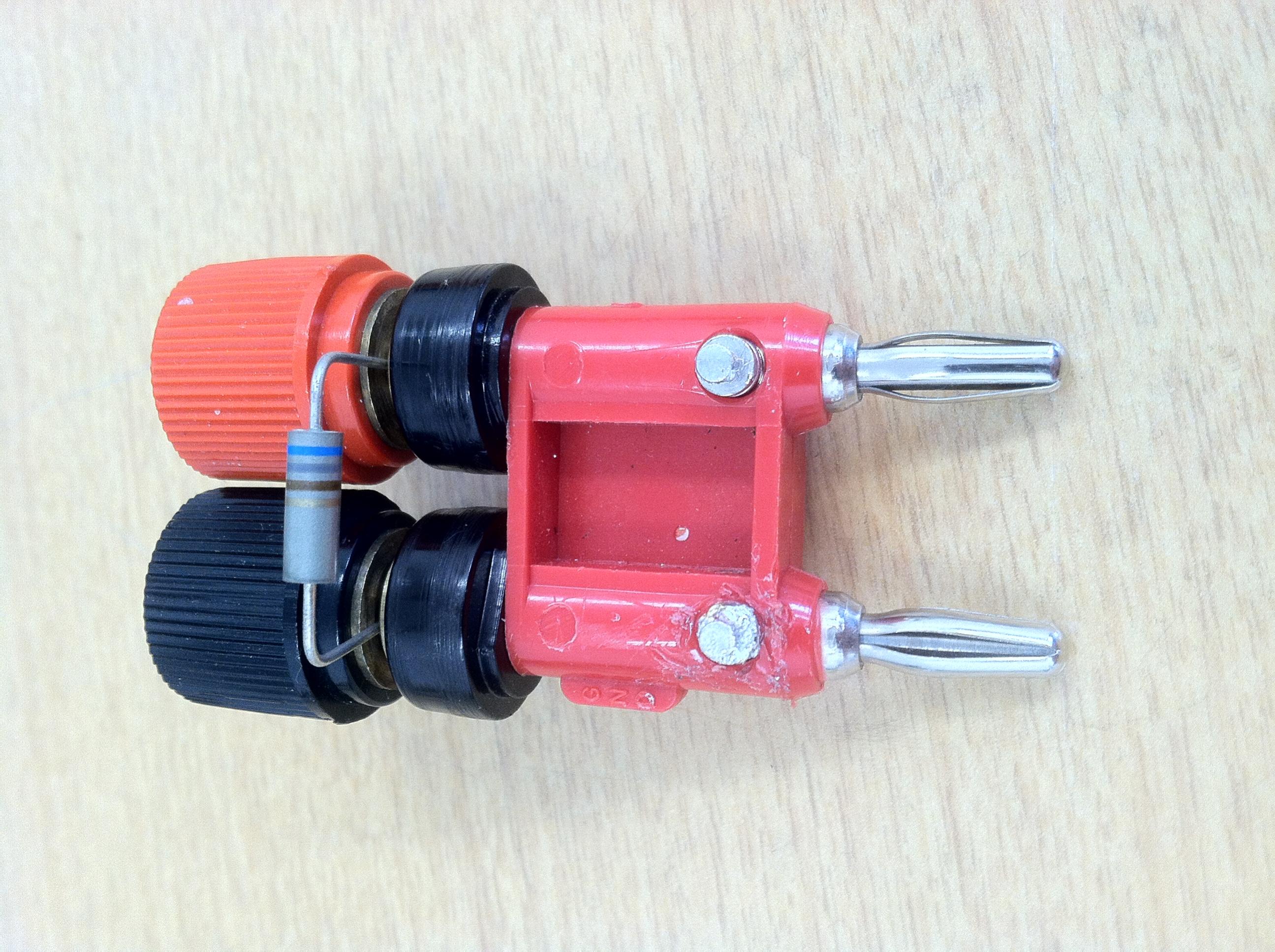

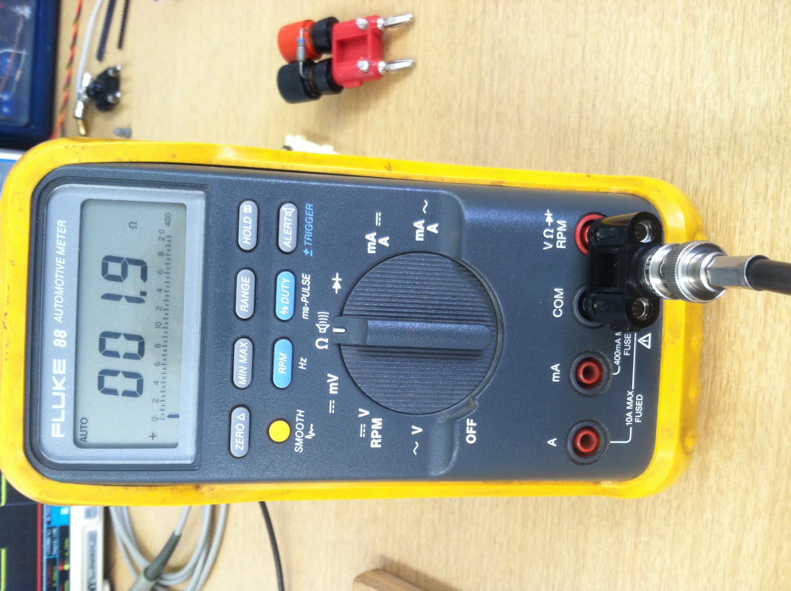

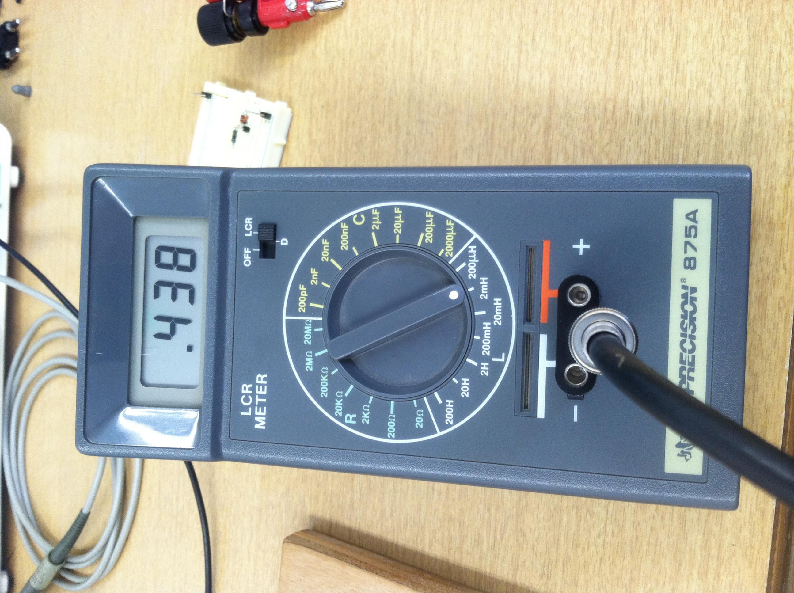

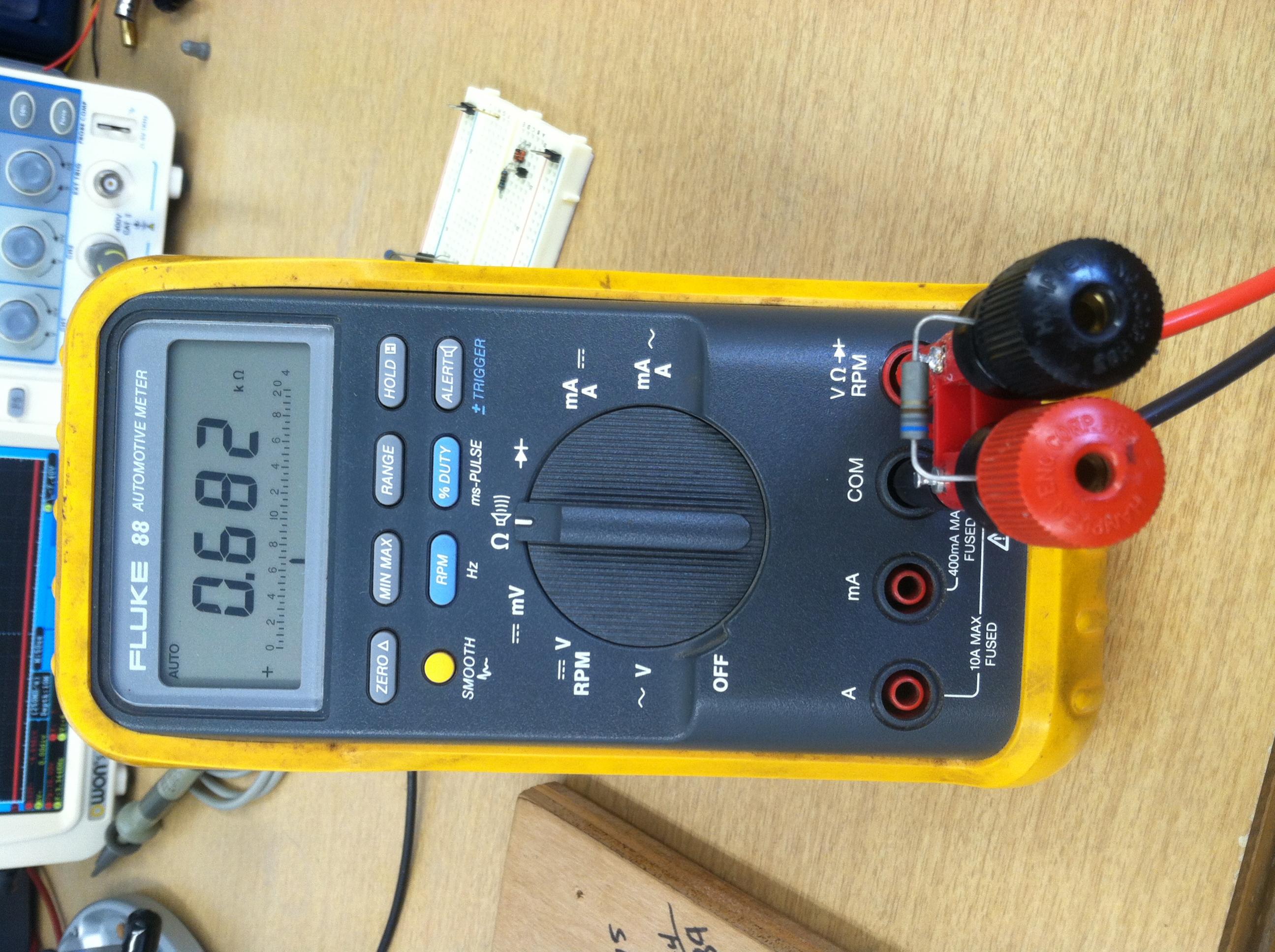

    I put together a circuit idea I had for an active damping circuit, and tested it this morning. I'm going to post pictures over a few posts' so I can describe what is happening. The setup is on my test fixture 12 volts. 150uS Tx Width. 3kHz Frequency thereabouts. 400uH Coil, 2R Coil Resistance. 10R Series Resistance. Cree SiC Nch Mosfet 900V. I have banana jacks on the fixture,with a bnc adapter,most of my coils use bnc. There is an adapter with binding posts' with a 680R resistor mounted for the standard config of 680R across the coil.There is no parallel 1K ohm and inverse parallel diodes in this test. The test circuit is built on the breadboard,and wired to the bnc adapter. The test circuit is an scr MCR22-6 1.5 ampere rms rating with very high 150 ampere for 2uS rating. 1N914 diode connected to the gate,1K resistor,and 100K trim pot in series with the resistor to control gate current and thus turn on delay.680R Resistor in series with the anode,cathode connected to 0V. The circuit allows the flyback to rise to a high voltage of your choosing adjustable with the trimpot. When the scr fires it connects the coil to 0V through the 680R damping resistor and latches until...? Dont know,dont care,it will certainly turn off on the next Tx which will reverse bias it. It also blocks current in the damping resistor during Tx,so you get more bang for your buck there also. 680R not critical value I tried several and this is the highest value that will damp the coil,there are probably gains to be had by trying different values,and scr firing delays to get it down to 0V the fastest. I am seeing critically damped flyback in under 5uS.
    Here are some pics of the coil measurements,and the damping resistor.

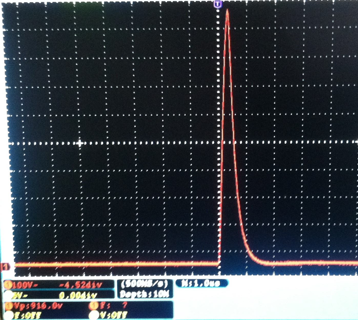

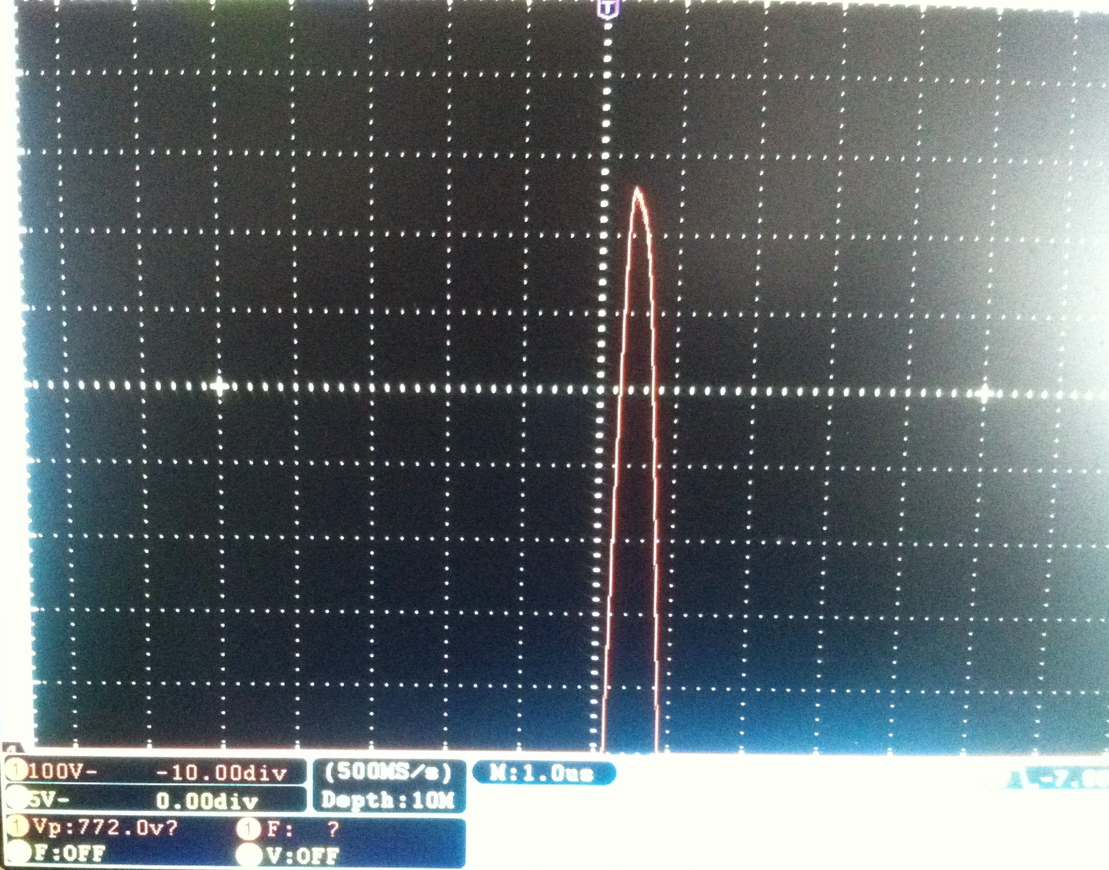

      Undamped flyback scope is on 100V per div and if you look you can see it is -10 divisions so the center graticule is 1000 Volts, so that's 1,272 Volts the 772V on the screen plus the 500V you cant see.

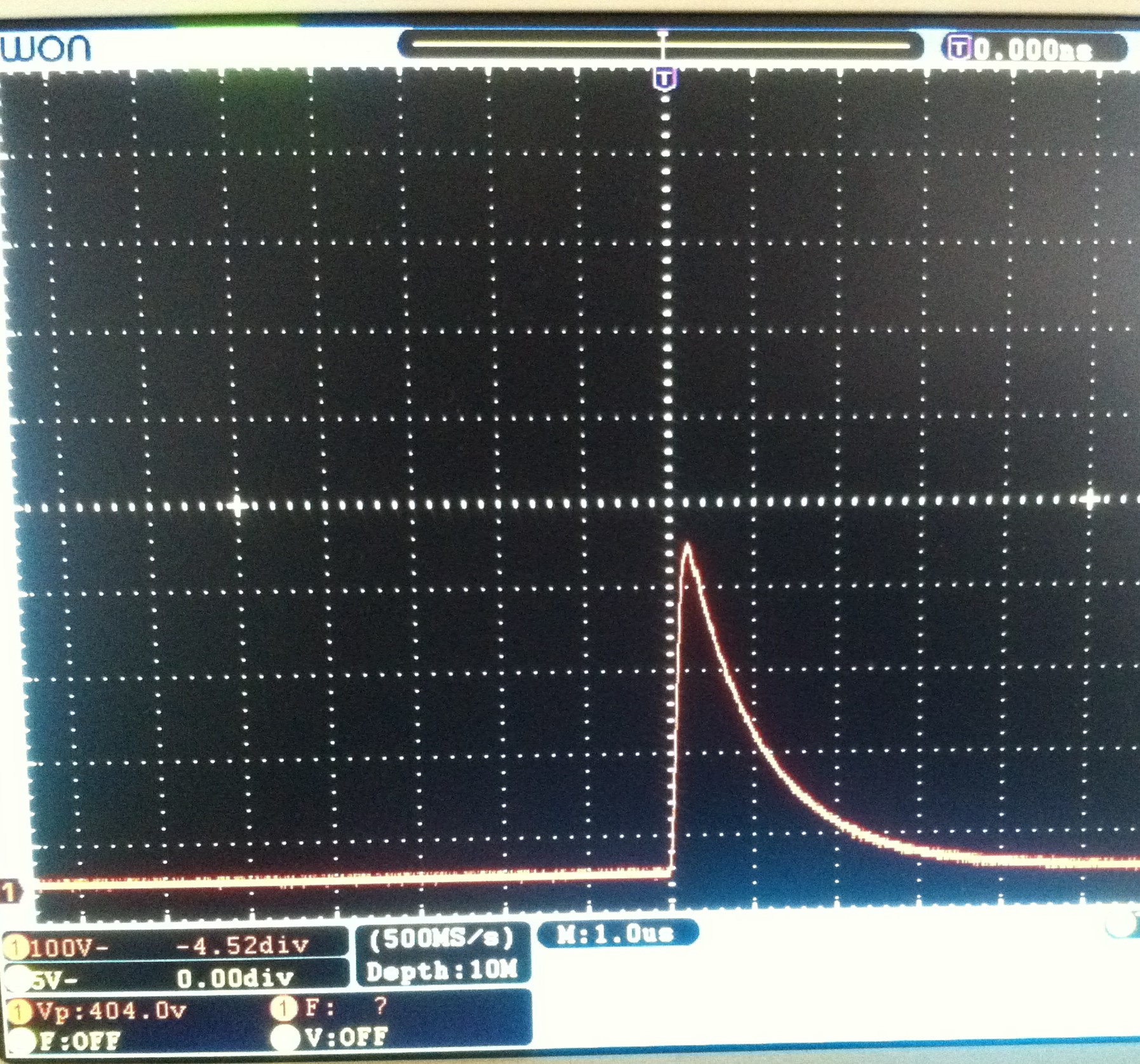

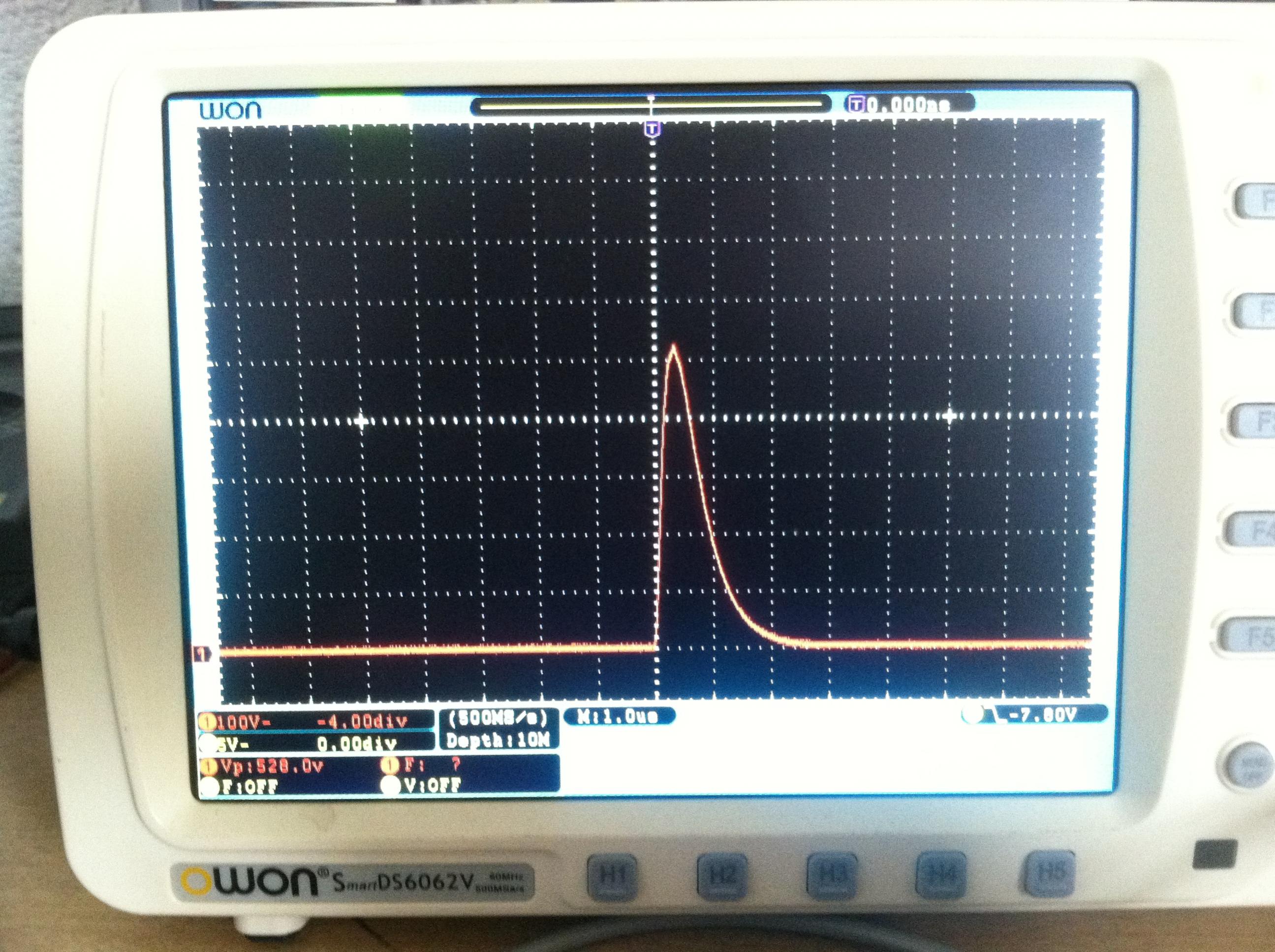

        Now I have connected the 680R in the usual way across the coil. 528 Volts flyback and a nice decay curve.

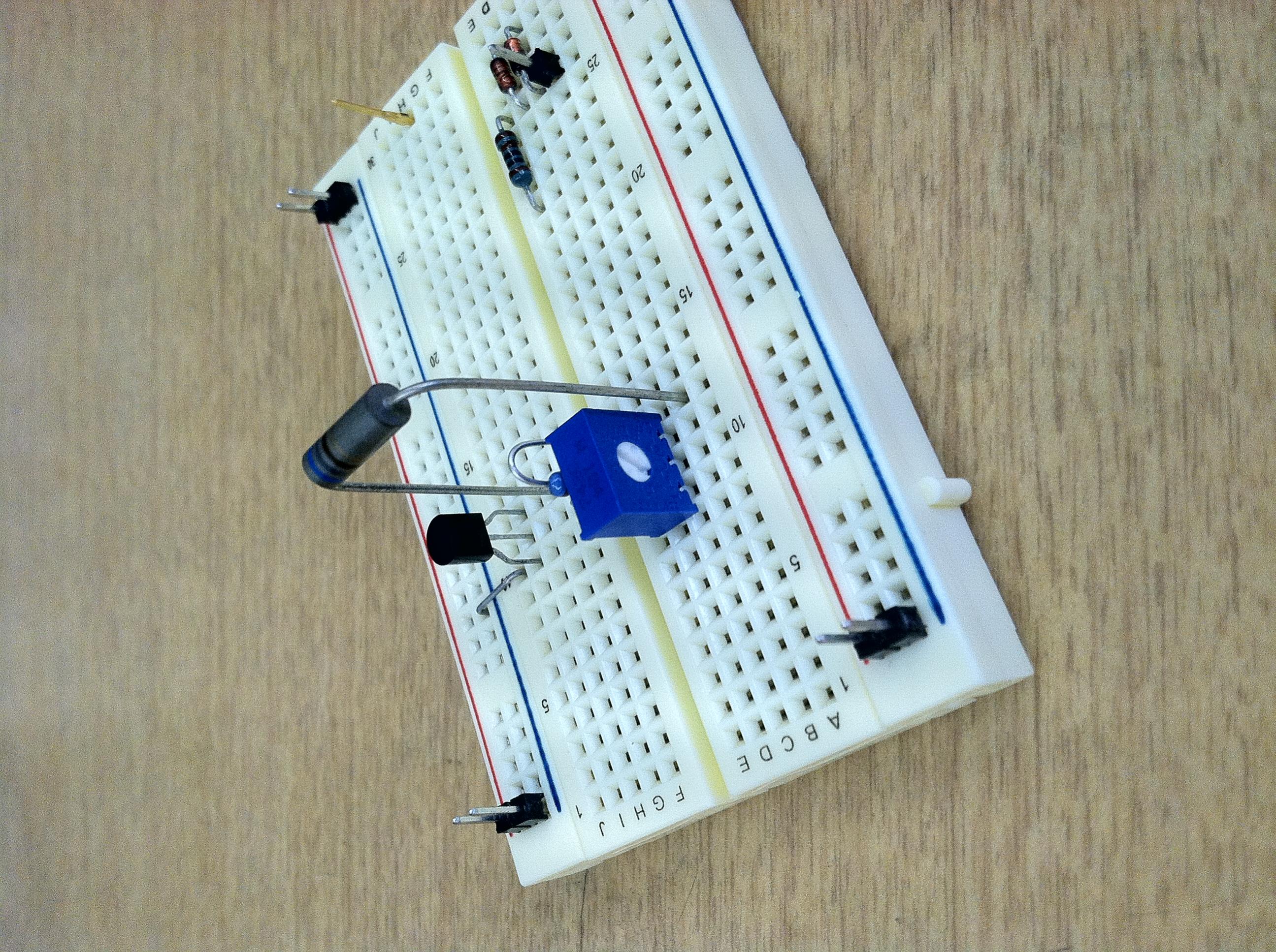

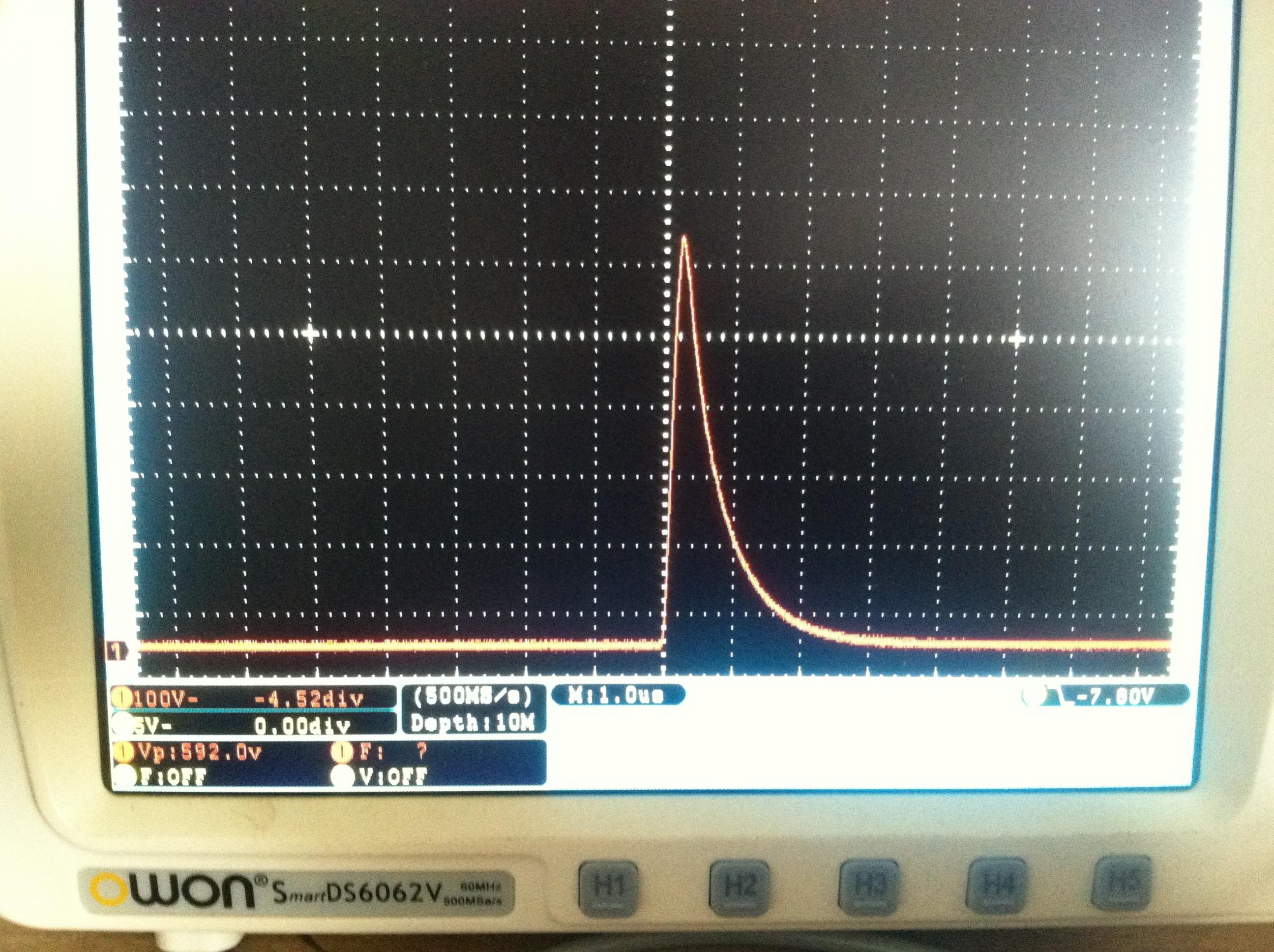

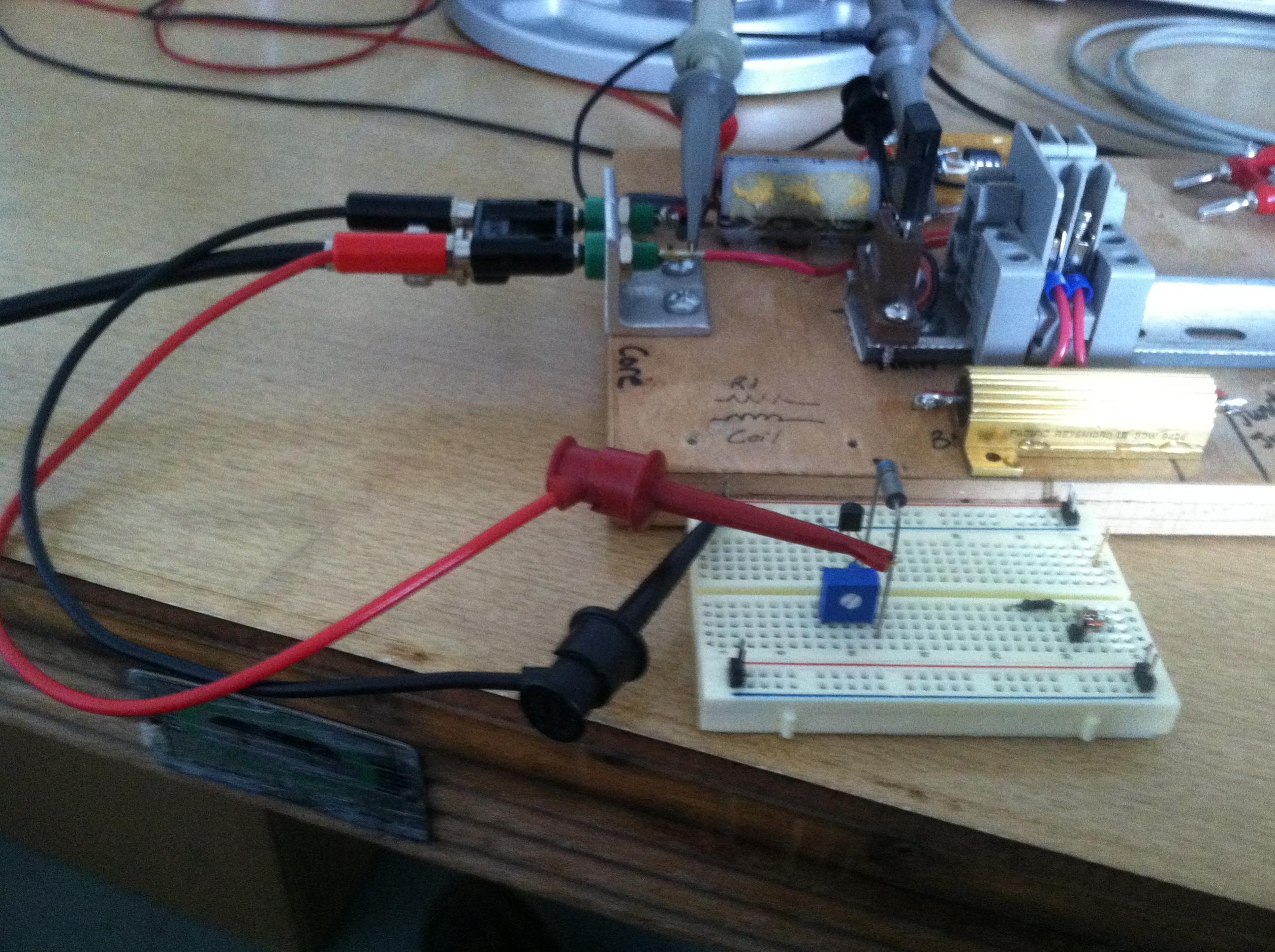

          Now I have connected the active damping circuit. One pic is a high 900 Volts adjustment,another is the minimum delay 400 Volts,and the other is an arbitrary 592 volts.
            You can see the higher you let it go before you hit it with the damping resistance the faster it will come to zero. If you have a very keen eye you will have seen in my 900 volt adjustment the voltage goes below 0V just. High gain preamp will have that in the basement. I either need to fire the scr sooner,or use a lower value resistor. You might also be wondering why a 900 volt Mosfet will not avalanche at 1272 volts of flyback,I can't answer that one except for production tolerances variance,most mosfets,and igbts I have seen avalanche higher than the datasheet value.
