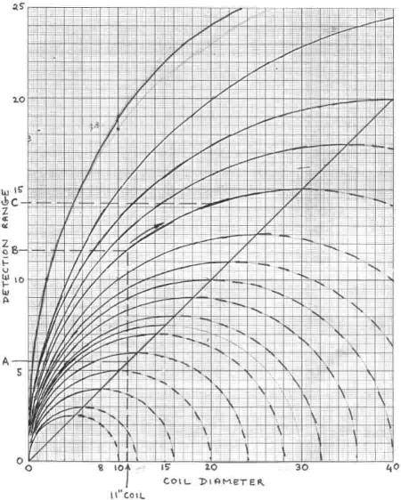

                For me, this thread seems to continue subjects raised in the 'Detection distance for nickel and quarter' and 'Single capacitor integrator switch'. I did some tests with my board that has the long sample pulses and I have now settled on 100uS samples as being the best for quarters without any significant loss on nickels. The space between samples has been set at 500uS. I started with the TX pulse of 350uS width and p.r.f. of about 500/sec. Start off peak amplitude of 4A and using a 8inch diameter mono coil of 310uH, I can detect a nickel at 13inches. This is using a new version of the 1C sample/hold arrangement that is perfectly balanced without an additional IC. It is an ideal match for the cross coupled inverter stage that was discussed in the other thread. Noise performance seemed greatly improved as a result.
                Using my range versus coil diameter chart, a 20inch coil would increase the range to 19inches for a nickel. Going to larger coils gives diminishing returns and more noise pickup. A 36inch coil would just about give 24inches range Better to stop at 20inches diameter and put up the pulse current. Four times the pulse current would give x1.26 improvement in range, so we would be running at 16A. Things will then be running hot, including the coil, but it can be done. The 19inches range with the 20inch coil then becomes 23.9inches, which is close enough.

                      Eric's chart ?

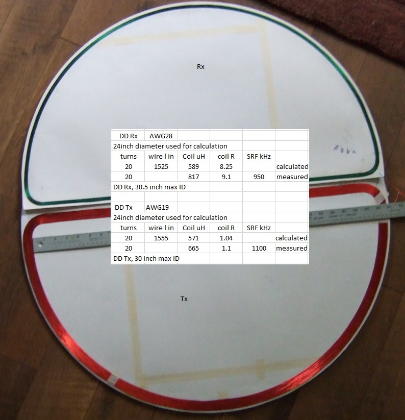

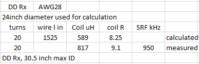

                          Finished the DD Rx coil. Used DD picture in ITMD as a guide for the template. Used 24inch round for calculations. DD coil has 30.5inch max ID. Looks like should have made it a little smaller, maybe it will be all right. I'll include a picture when I finish the DD Tx.

                                Finished the Tx coil. Next, put it together. Have a Tx circuit with 1A peak for testing. Need to make Tx circuit for 4A and greater. Still wondering how to absorb coil Tx off power. DD coil: Tx on time=300us(about 2 quarter TC's)2.2W. Tx on time=450us(about 3 quarter TC's)3.7W. Any thoughts?
                                Documenting coil build. Wondering what effect adding shield has. Anything else?
                                Rx calculates 34pf, Tx calculates 31pf. Wasn't expecting them to be as close to the same.
