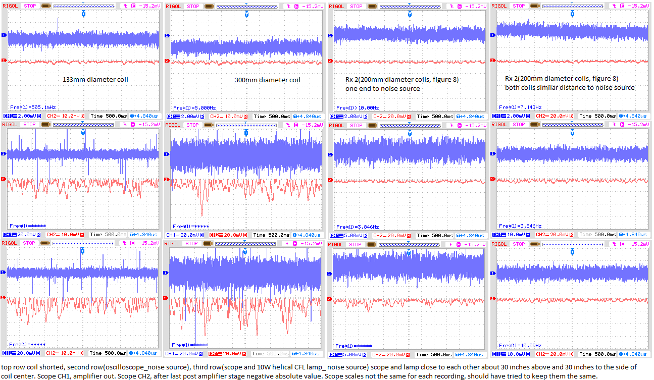

    Along my journey to create the best PI machine using regular electronic components (i.e. no ADC's or microprocessors etc.), I have reached a point where my limiting factor to better sensitivity (SNR) is the need to eliminate/reduce EMI that is picked up by the search coil.
    Does anyone have any useful and practical design ideas/tips that I can look at please?

        What does integrator out look like if AC Mains is the source of the noise? Does the noise repeat or is it random. I tried adjusting sample rate, didn't see a reduction in noise. Maybe adjustment was too course. Some scope pictures. An example of what I see. Need digital scope or CRT with persistence to see 5sec trace. Think need 5 or 10 sec trace to see what is happening. Need to look at integrator out. Some thoughts maybe correct maybe not.
        Scope and lamp probably not the only noise source.
          If just AC Mains then there will be a 'beat' frequency that is the Sum & Difference of the pulse and AC frequencies.
          As the Pulse rate is adjusted the beat frequency decreases until it becomes DC- no interference.
          Your scope shots are shows 'random' type noise. CFL lamps typically have a switching power supply that is not frequency controlled and can have lots of wide band noise. Nothing you can do to keep this out of a detector except lots of distance since a PI detector is basically wide-band.
          ONLY single frequency (AC mains, etc) can be nulled with pulse rate adjustment. Wide band Noise can not.
          FYI: There are many CFL lamps sold that do NOT pass FCC or CE emissions standards. These are actually illegal to be sold but are sold in many places. Ham Radio operators commonly find these 'bad' CFL lamps disrupt radio communications. Only solution is throw them away.

              No I don't have a scope pic since there is much other noise in my workshop and is it is an old analog scope that does not do well with very slow scan rates. The Beat would look like a slow Sine wave if ONLY AC mains pick up.
              If it picks up broad band noise then might not see it.

                          A figure8 Rx coil is the best way I've found to reduce(not eliminate)random noise.
