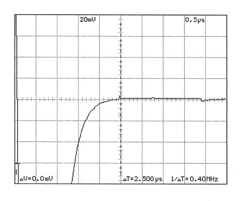

              I looked up some of the information I have on the development of small object PI detectors in 1996.
              As already mentioned the coil is very important. I made several different types of coil i.e. ferrite cored, printed circuit, and standard wire. The details of a standard wire coil (this was a rectangular figure eight with overall dimensions of 160 x 220mm. The winding were 2 off 80mm x 220mm side by side. Each had an inductance of 30uH and a resistance of 2.3ohms. Wire was 30AWG wire wrapping wire with Kynar insulation. Screening plates were made with 1mm Tufnol sheet painted with two coats of conductive paint. RG179 coax was used and the maximum length possible was 1m. 0.5m was used in practice. I also made a 100mm diameter round coil that worked OK.
              TX pulse width was very short at 7.5uS at a very low pulse current (39ohms in series with coil) but very high rep rate. Preamp IC was OPA620 with a gain of 25. Today I would use a OPA1611. Standard diferential integrator and following circuit.
              Preamp response was clean and sampling started at 2.5uS with a sample width of 2uS. Click image for larger version
ID:	357800 You can just see the glitches in the response at 2.5 and 4.5uS at the start and end of the sample.
              Eric.

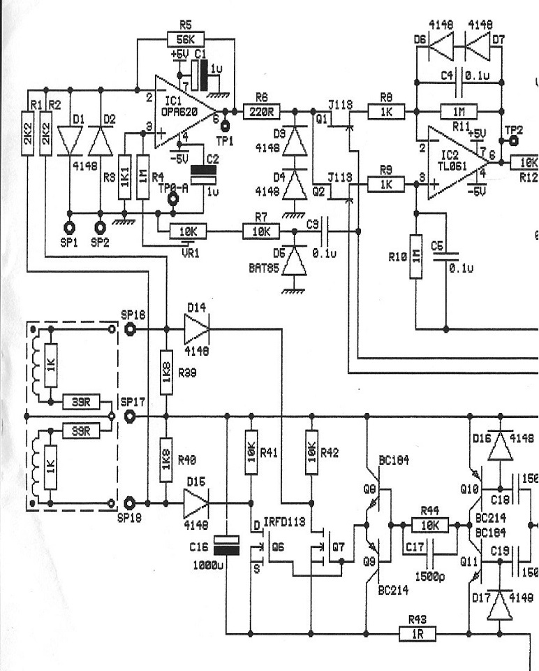

                  What model Goldquest do you have? Does it have a 4017 decade counter on the pcb and a IRF112 or 113 as the Mosfet? If so, that is the basic arrangement for a detector with a short delay. The clock frequency control alters TX width, delay, sample pulse width and pulse rate all with one control. If you want longer pulses, all changes in proportion and current draw stays the same.
                  It would be good to check the area you want to search with a standard PI to see if the ground suffers from iron mineralisation. If it is, then very short delays and short pulses will still be a problem.
                  If I were making such a detector, I would house the TX with reservoir capacitor and preamp in a small waterproof case about 30cm up the shaft from the coil. Supplies, pulse and sample generators, display, audio etc in separate box with controls at the top of the shaft with a multicore cable feed to the TX/RX box.
                  Here is the TX/RX and integrator circuit I used 24 years ago with pseudo figure eight coil. Single mono coil could run from just one Mosfet. Click image for larger version

                      Thats very smart Eric, do you recall what voltage you would set TP1 to was it zero volts ?
                              Yes, that is correct. I will have to look at a pcb to see if there was an offset trimmer. Make take a while to find a board as they are in a box somewhere. The trimmer shown injected an attenuated 1st sample pulse to back off surrounding metal in one application. I seem to remember selecting IC's that needed little if any trimming.
