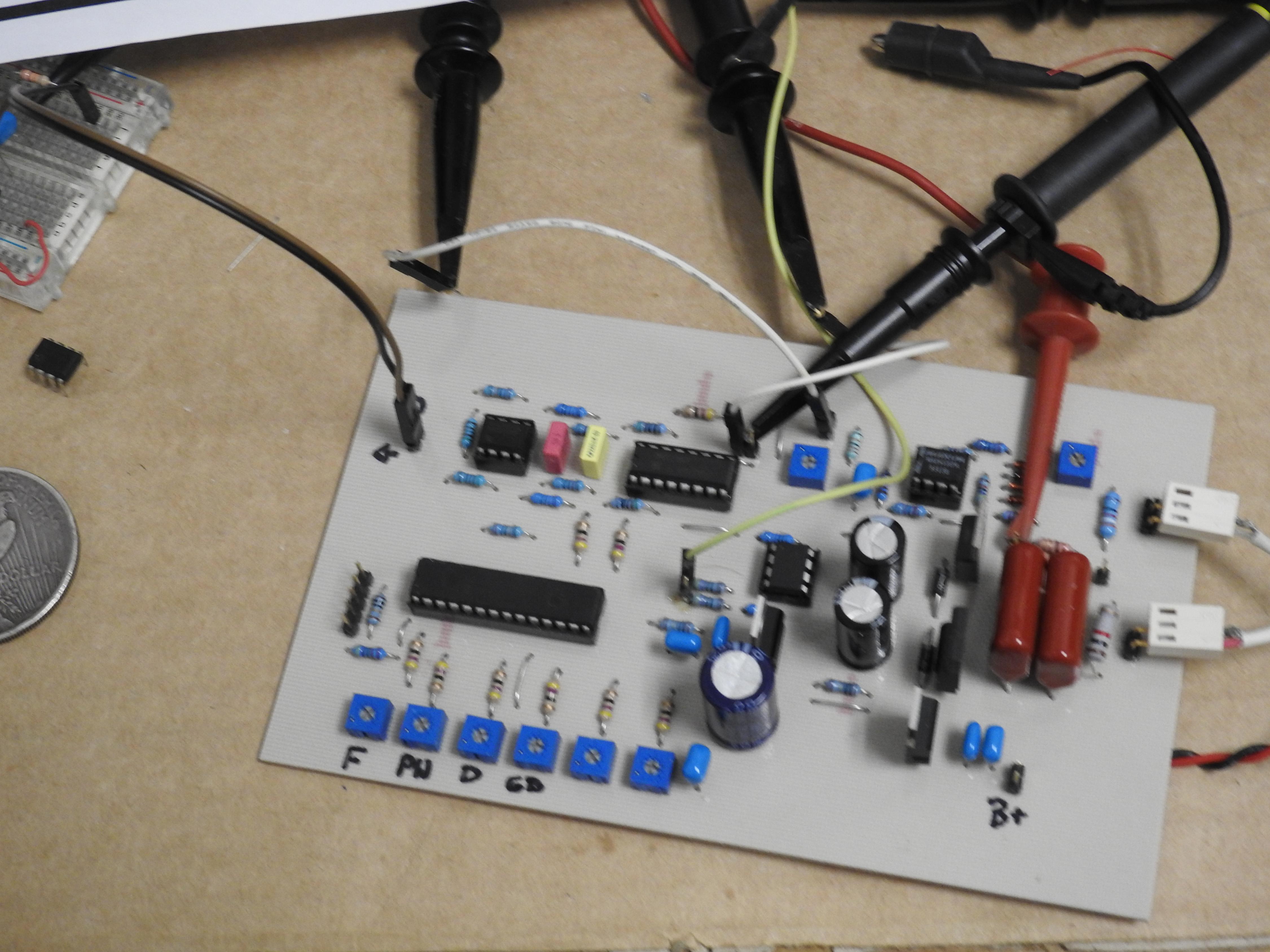

          I made some good progress over the weekend. I built a complete front-end with Tx, pre-amp and demodulator. Unfortunately it can only take two samples/phase. This really needs four to six samples to exploit all the possible signals. I was able to balance a coil with little problem. The other day I had problems nulling a coil due to a sloppy setup. The coil is not optimized, I used magnet wire. Will redo with pvc stranded this week sometime.

          See video for target responses. The sample during THS set to ground balance for various ferrites and some hot rocks. The second sample is taken after the flyback and is combined with the first in a differential demodulator. Ferrous objects give positive or negative, depending on orientation. Non-ferrous always the same. Lots of possibilities.
          Coil tx 540uH, rx 400uH. Tx pw=100us, samples 10us. Power supply current about 160ma.

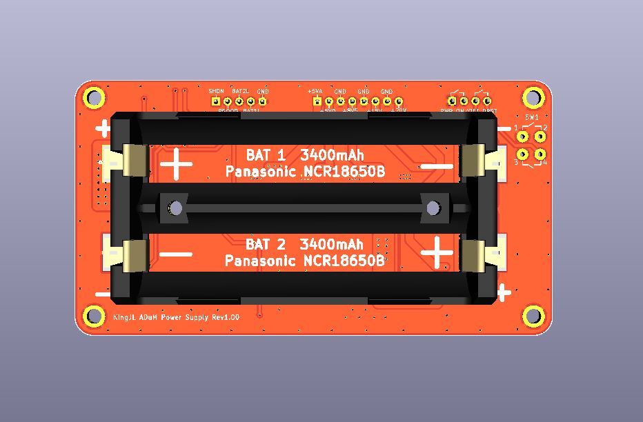

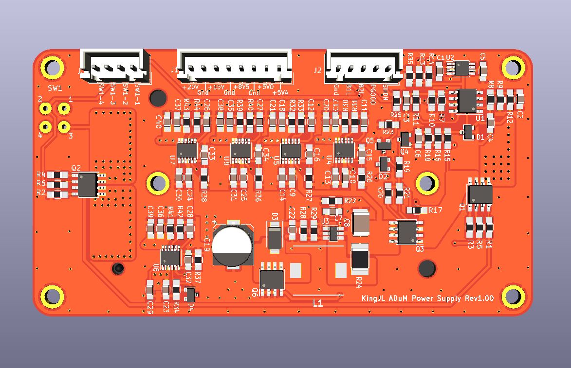

                I have been working with KingJL on his Bipolar TX design and we are moving at a reduced pace due to KingJL moving house and my work commitments and home renovation over the last couple of months or so.
                The power supply board is designed and I sent those off for manufacture, received them a week or so ago, now just waiting on some parts from Digikey then I'll load some, test and send some to KingJL.
                Once the PS board is loaded and tested I'll post the schematic and board files.
                KingJL has been busy with finishing off the main board as there were some possible changes to the ADC and reference, I'll let KingJL update on this but it is looking very nice.
                  [ATTACH]50909[/ATTACH]
                  [ATTACH]50910[/ATTACH]
