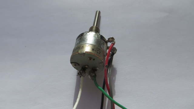

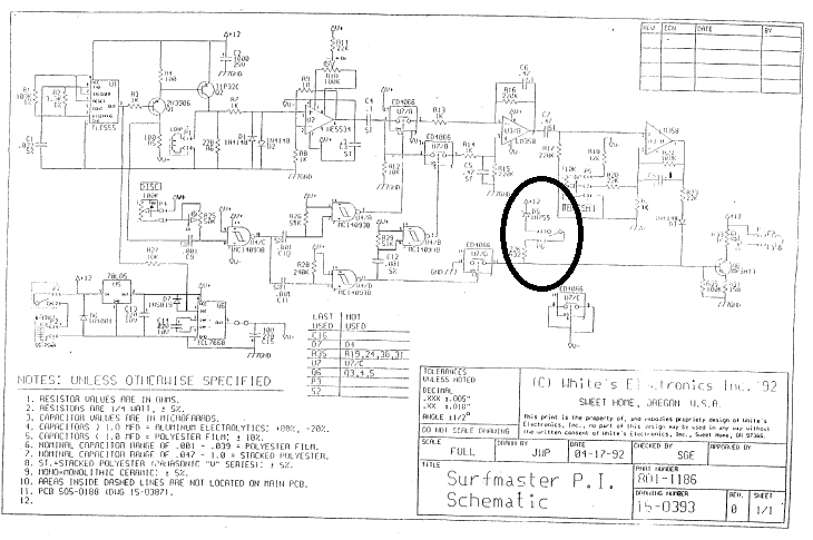

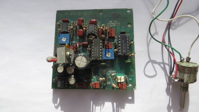

    hello, little question about my original SMPI from whites which is broken, the tuner
    potentiometer is brand clara mexico 10 kilo-ohm with an on / off switch, on my knob when
    the potentiometer is closed, it leads and when I open it, it is cut which is the
    opposite of an on / off switch, on the attached original diagram *
    and on my PCB, it is the P6 which is positioned between the
    zener D5 and the resistorr R32, so, normally open or normally closed, thanks

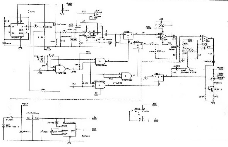

    in batt chk position is closed. click... opened pins... you may tune...click... you hear a zoom... batt voltage is norm...
      smp? again

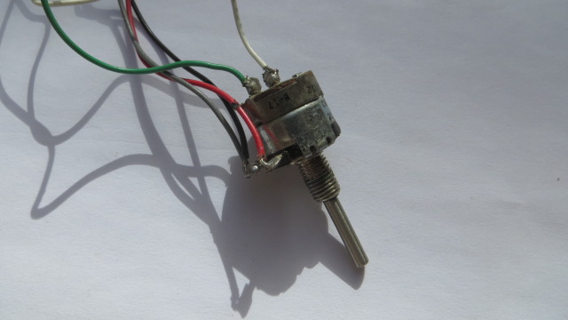

      good evening and thank you but I misunderstood your answer, I summarize, when the detector is off the tune pot switch is closed as in photo 1 and when I turn the pot, there is a click and the switch opened as on photo 2 what cuts the signal, is this normal given that for me as a repairer of electronic devices a switch is normally closed when stopping cutting all signal and creates a contact when we turn its axis with the sound of a click which establishes the passage of a signal, on my potentiometer, it is the opposite , thank you
        ok. first point. switch closed, it is First Position, yea? then a voltage from power supply, positive potencial,
        go on output speaker driver. you hear constant zoom, if BATTERY VOLTAGE LEVEL is hight.
        U7/A clatsz clatsz on GND... from U4/D... you hear the Modulation of THE potencial/DC/power.
        second point. you turn the pot and ... click... you tune the pot in same position.
        switch opened. you hear a reaction on metal/target. this is work state. THE Hunting.
        what is not clear for your understanding?
        on the sch. CLOSED IN CCW [position]. COUNTER CLOCK WISE.
          hello , now it's clear , thank you very much
