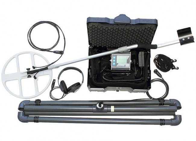

            In that search they are using an older Lorenz Deepmax X. Here's a newer version costing $6,999. You can understand why I don't want to spend that kind of money on a long-shot search unlikely to produce results.
            https://www.kellycodetectors.com/cat...etector-system

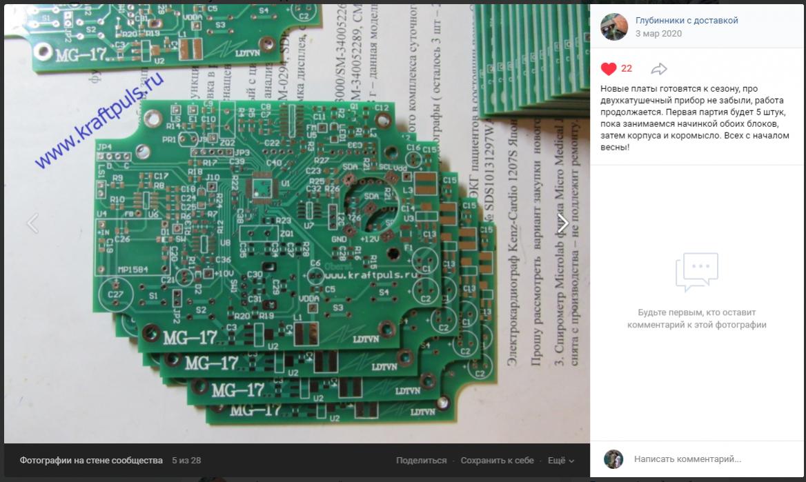

                    went on link given me by this guy. ok. those boards MG-17 https://vk.com/metaldetection?z=phot...69581_00%2Frev
                    reading the comments it is PI detector.
                      dead link
                        dead link
                        screen shot
                        try open this site http://www.kraftpuls.ru/pages/mg17.html
                        This device is gradually moving from development to testing, video can be viewed below by links:
                        ANNOUNCEMENT
                        FIRST TESTS
                        Principle of operation:
                        МГ-17 operates on impulse induction. Short pulses of low frequency current (200 Hz) are created in the transmitting coil, which create a primary magnetic field. It causes currents on the surface of the target metal object, which decay exponentially, creating a secondary field, and it is detected by the receiver of the device. Then, directly from the receiver, the signal is transmitted to the processor and matchmaking takes place. Such direct digital processing made it possible to obtain high stability and selection of "black-color." The rate of attenuation of currents in the metal depends on many factors. First of all, from the specific conductivity of the metal and from its shape and thickness.
                        This is used to cut off small objects, since in them the current attenuates much faster than in large ones. Therefore, the reception is delayed to cut off the metal fines.
                        Depth and stability of detection is achieved due to pulse technology of spool search and separation.
                        There is also a ground balance and slow auto-adjustment, this allows you to get rid of the search interference that is characteristic of static mode.
                        This is a very easy to operate device, on the principle of "on and off." Adjustment during operation does not require, but if necessary, you can change the threshold and volume. He is not afraid of hooks of the frame against the bushes, that is, there are no false positives from hooks, and even more so when walking.
                        Depth of detection of some objects:
                        Helmet German М-35 1.7 m
                        Gas mask tank xxx m
                        Shovel Fiskars big xxx m
                        Canister 20 liters 2.5 m
                        These results for the standard air test in the field (it makes no sense to check in the room due to interference).
