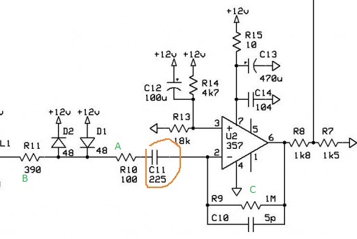

          What is the advantages and disadvantages of AC coupling the pre-Amp?
          what i think right now:
          advantages:
          1) reducing DC offset picked up from ground
          dis:
          1) not being able to take EF sample? because of capacitor discharge
          and when used with the inverting input of the OP-AMP, which resistor sets the cutoff frequency?
Name:	felezjoo - Copy (2).jpg
          A, B or C?

            AC coupling the preamp is required to remove the DC offset of the input signal (usually when coil voltage decays to 12V and not to GND). You are still able to take an EF sample. In the attached circuit R10 and C11 form a high pass filter while R9 and C10 form a low pass filter. So both resistors A and C set cutoff frequencies of those filters.
                Thank you lucifer
                basically it's needed when the coil decays to another voltage level than the analog ground (op amp ground)
                I was wondering if there is any other use for it because I have seen in other places that they use it but doesn't seem to be any reason for it.
                or maybe they didn't know what they're doing.

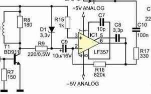

                example:
Name:	2_Modified Sandbanks - from Ivconic - Copy.jpg
                signal will decay to GND (+12) here
