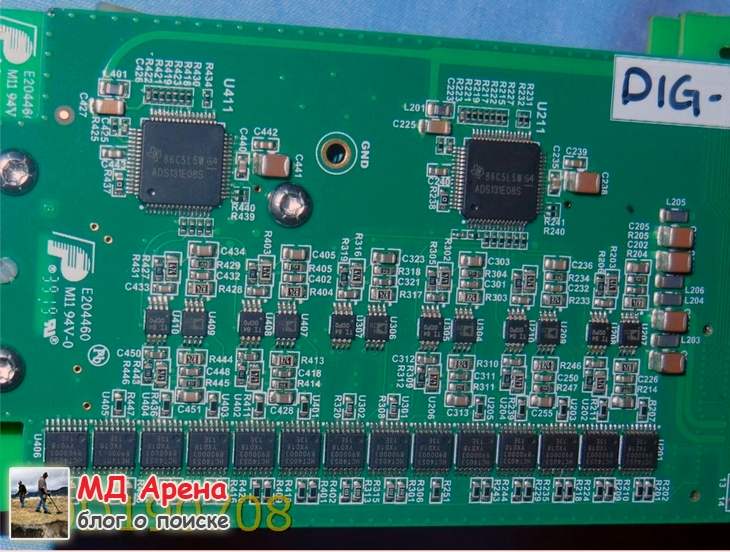

        Yes, I also saw a bunch of HCT4053 gull wings in a row, plus another row of what I'm guessing might be comparators?
        Actually, there appears to be a row of two different chips paired together. (6 pairs)

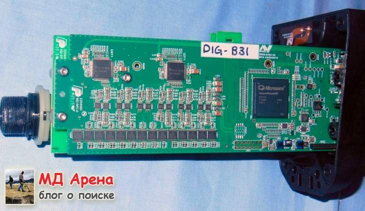

          Hi I'm also in
          so 14 MUXs followed by 6 pair of 8-pin Analog goodies then all go to 2 x 24bit 8 channel Delta-Sigma ADCs.

          I can't see the traces from those ADCs going directly to the SmartFusion 2 FPGA but they're probably doing that, I wonder if there is any thing on the other side of the board, isolation?!

          now the thing is the last two 4053 MUXs on the left must don't have the analog pair sooo...not sure!

          I don't find any info about those two SSOP8 packages but one of them seems like TI 640CP0 which is non sense.

          now the question is:
          1) are they using sample and hold technique and then reading the output of those SHAs with ADCs?
          2) or just Multiplexing the Pre-Amp out puts to some multi order band-pass filters then to the ADCs?
          the first analogy is the right answer I believe because the ADCs only have 64 ksps which is clearly not enough for direct sampling the Pre-Amps and if they wanted to do that, they would do it with the ADCs directly
          so with that being said, how many samples are they taking ?! too many MUXs and each has 3 x SPDT switches, doesn't fit!

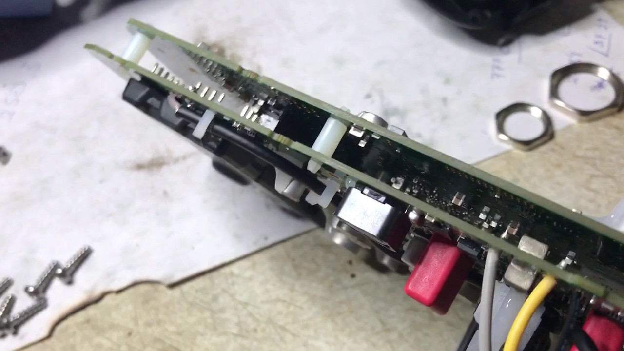

            this type of close together dual board construction has been common in the GPX6000 and GPZ7000 series recently
            I wonder how they connect together, can't see any headers, maybe flex PCB ribbon? or expensive high frequency board to board connections?(don't think so)

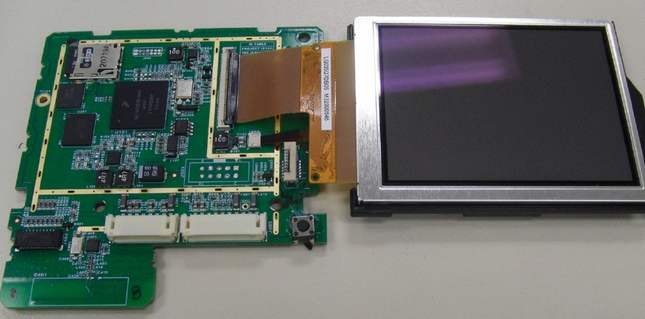

            GUI:

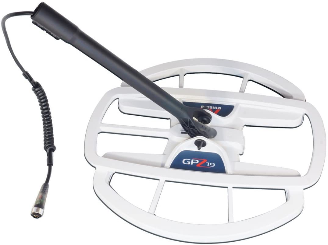

            and the HEAVY coil:
