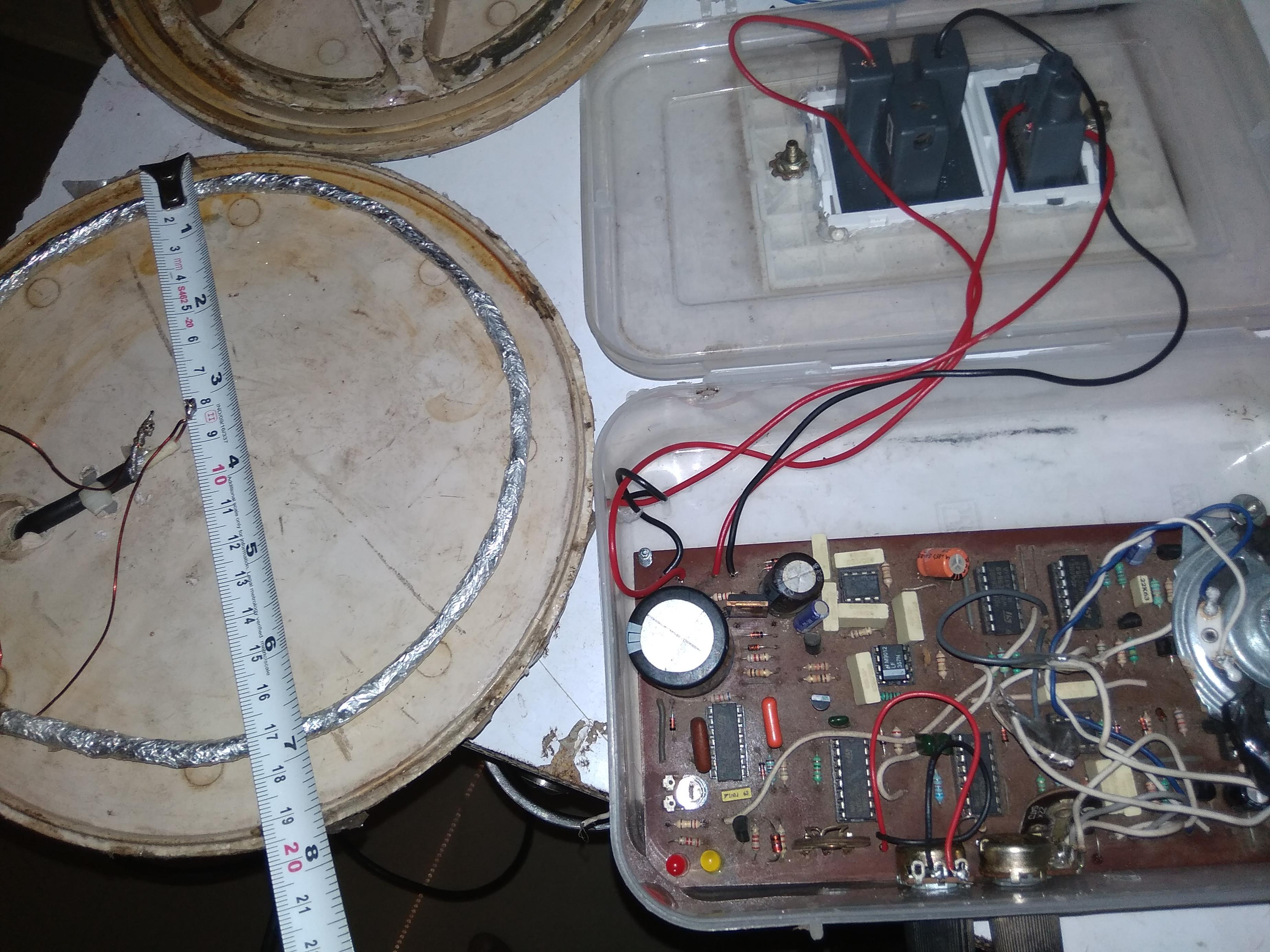

    I made delta plus it working very good in free air detecting range near about 9 feet at ms iron sheet of shade and when I went for testing, I saw that it is detecting everything, inside the stone, broken broken bricks of wall under ground metal detecting is critical how to clear wher is metal ???

        detector is no more sensitive that is working good & stable but searching in underground metal it indicate false signal
          Originally posted by rajesh View Post
          [ATTACH]55028[/ATTACH][ATTACH]55028[/ATTACH]
          is there a gap in the coil aluminium foil
            1. do NOT use the foil for shielding of a coil - !!!!!!!!!!!
            2. you MUST shield the housing INSIDE, using GRAPHITE spray or graphite powder with glue.
            3. you MUST connect THE shield layer to +E
            all examples of RIGHT shielding is HERE https://www.geotech1.com/forums/album.php?albumid=102
