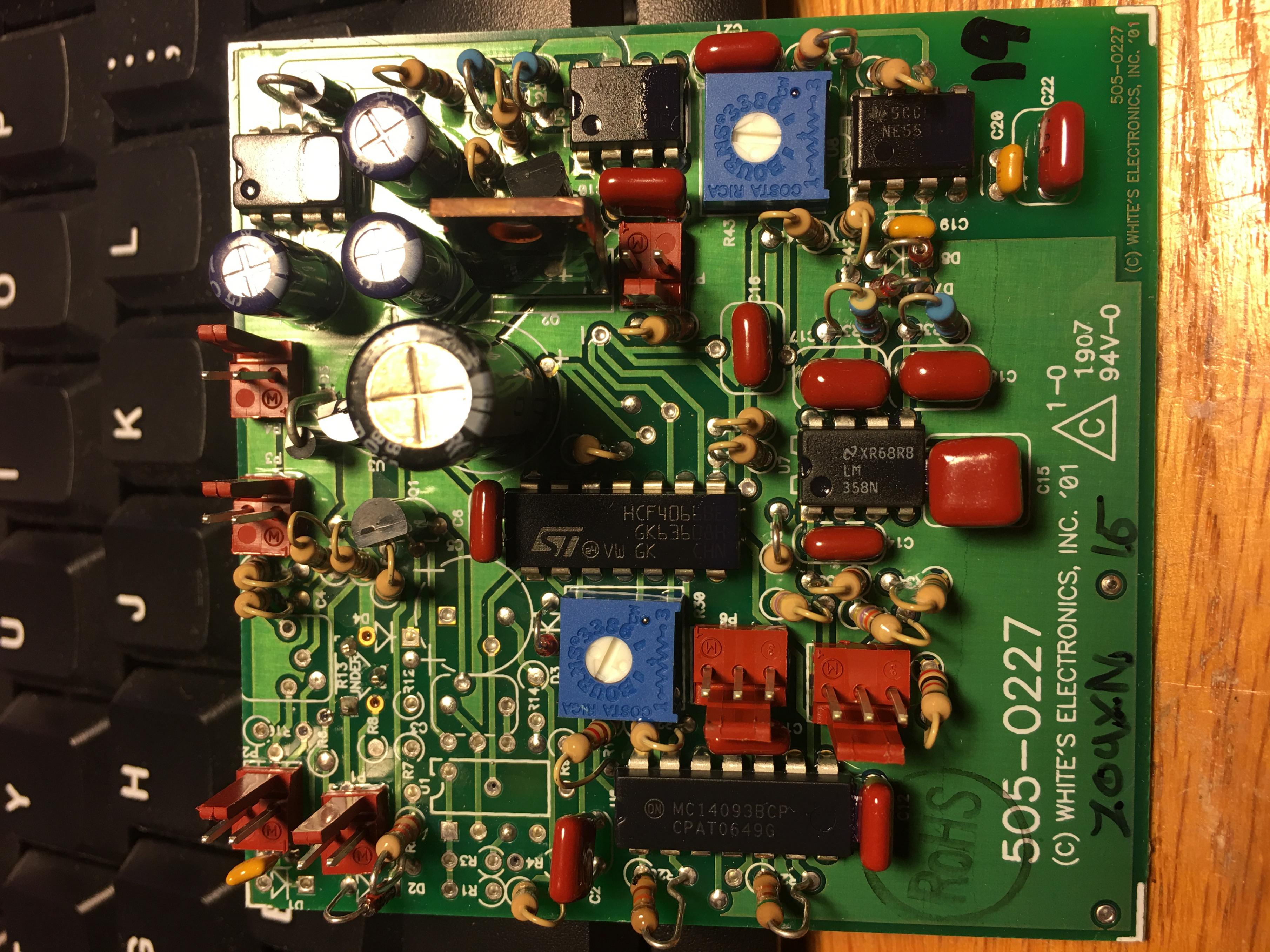

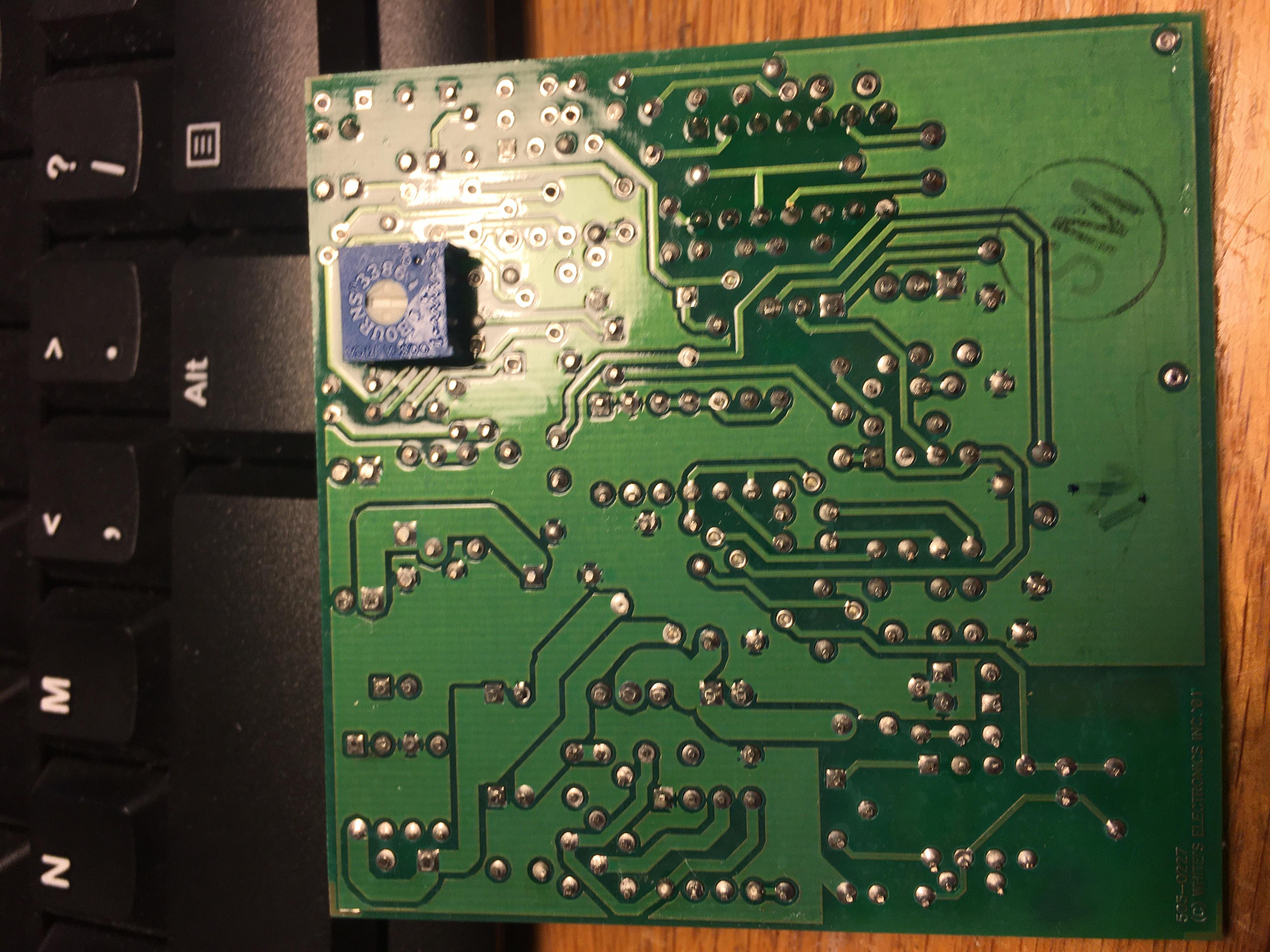

        anyway you have to open a housing. send pls pics of board.

              KT315 I will definitely upload some pics of the pcb here for you to analyze.

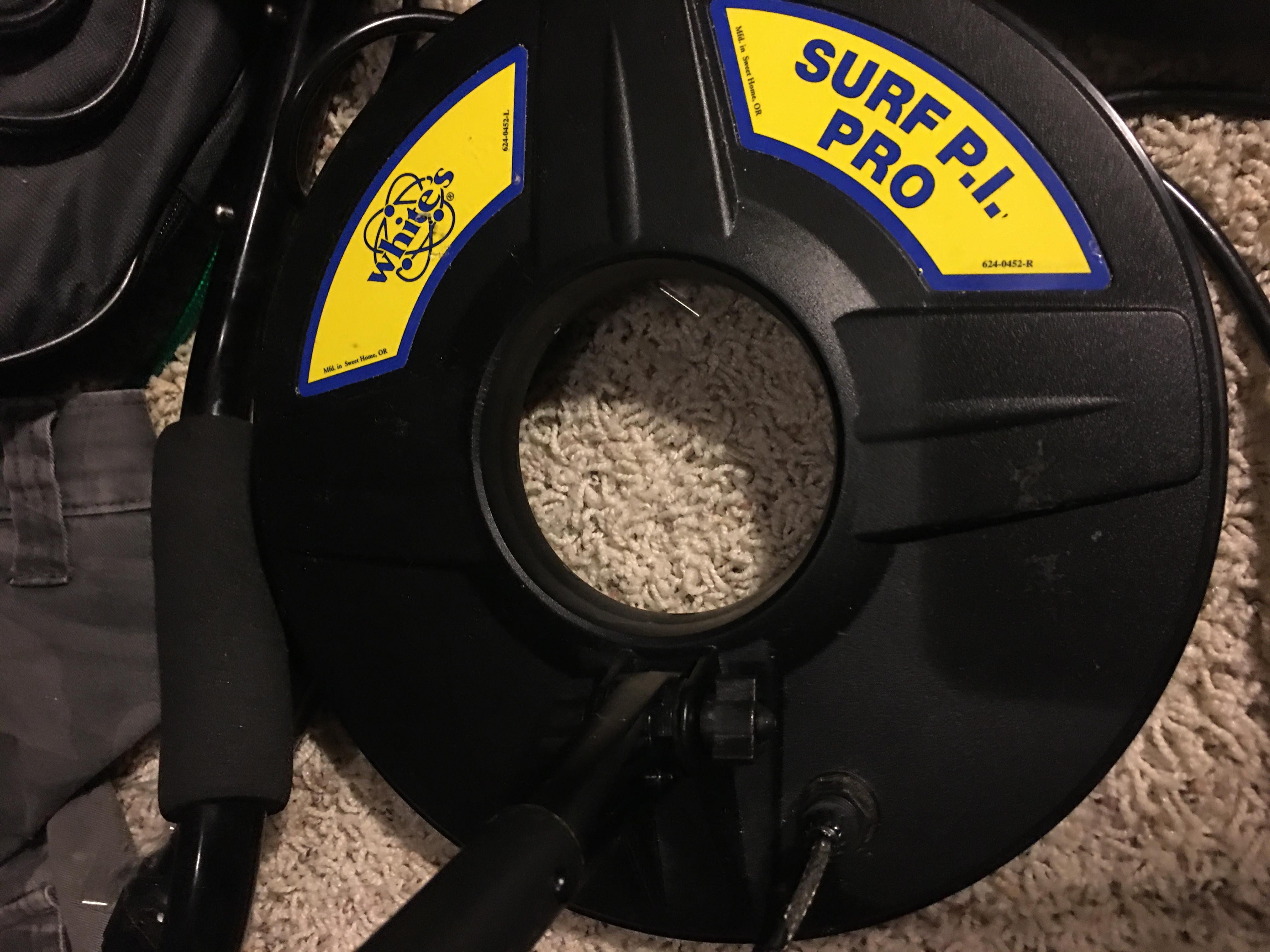

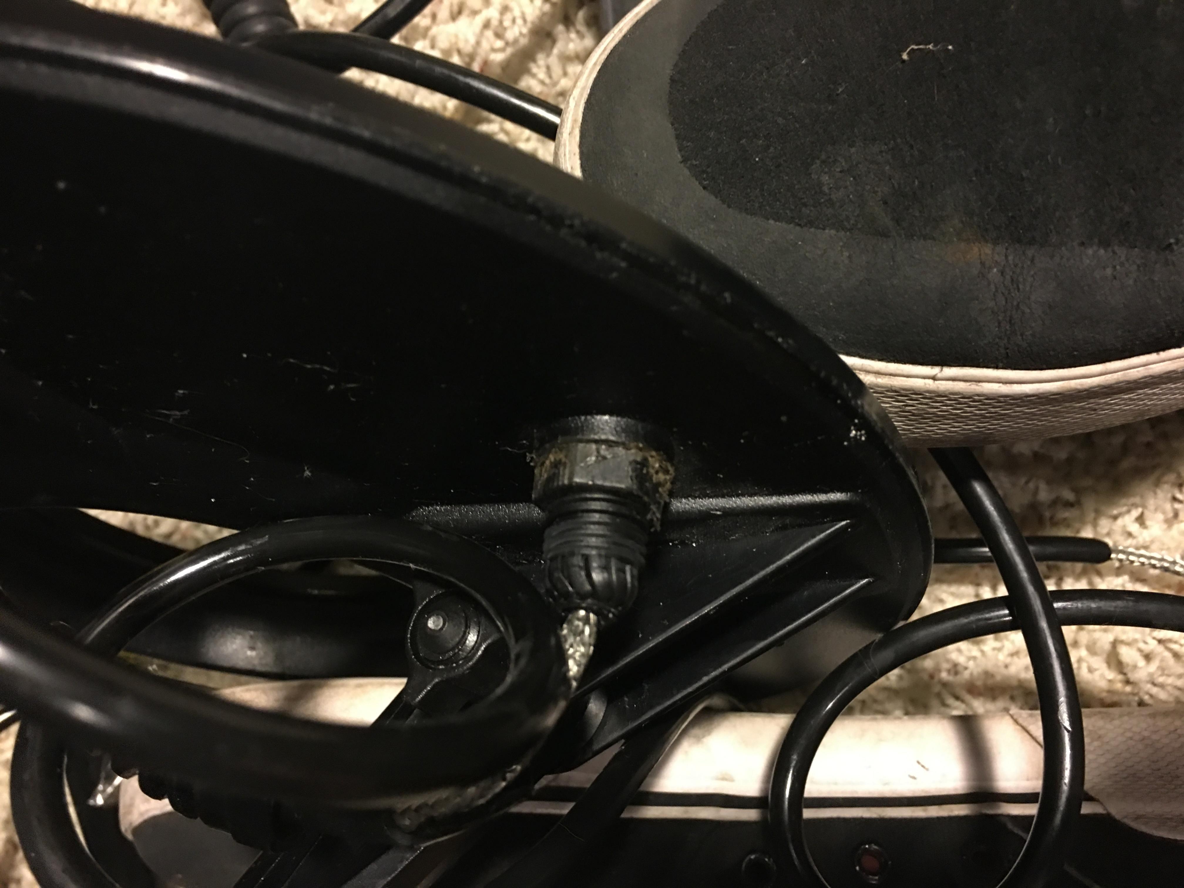

                  Coil is as expected and trashed, the rest of the unit looks new.Click image for larger version

                    I believe this is the foam filled coil as Carl mentioned, unit got better air test than my home built

                        thank you for pics but pls more light. https://www.geotech1.com/forums/show...here-share-out
                          I will have to go outside for more light. After work today

                              You may be in luck, that is one of the newer 950 coils. Since you said the cable was bad I assumed you had an older unit with an old-style 950 coil, which was injected-filled after the housing was glued together.
                              This 950 has a foam core but it is a molded core, not injected. So if you can split the seams it will come apart easily. Replacing the cable will also be fairly easy; you want a coax with a stranded center conductor. But you still have the task of getting it sealed again and that will be highly iffy if you want it waterproof.
