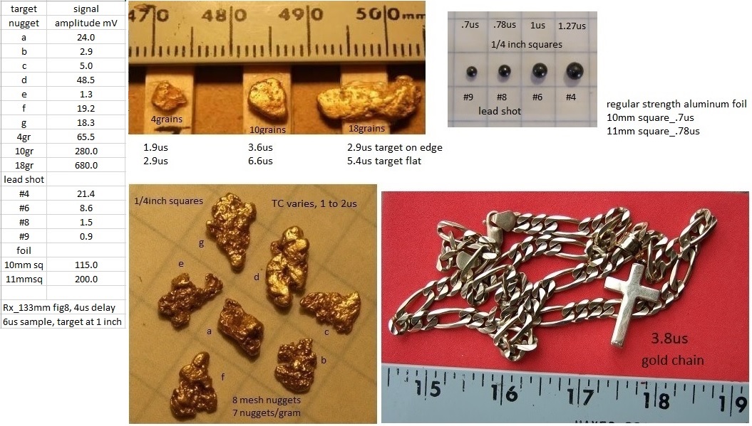

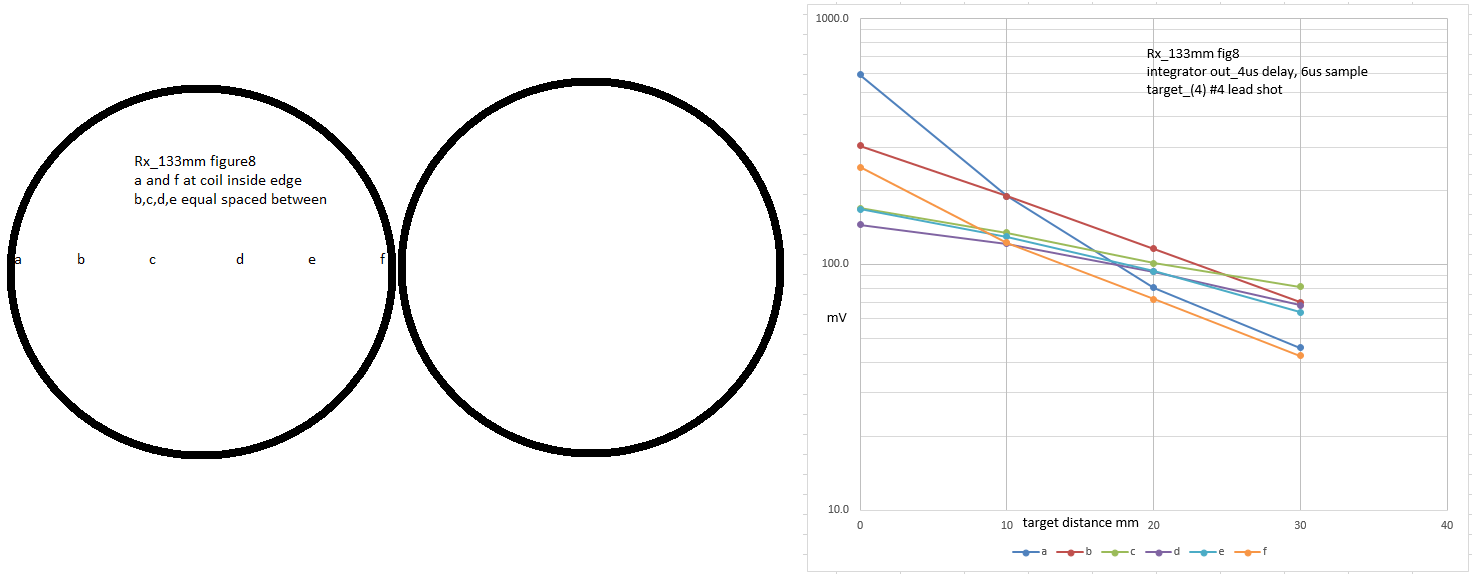

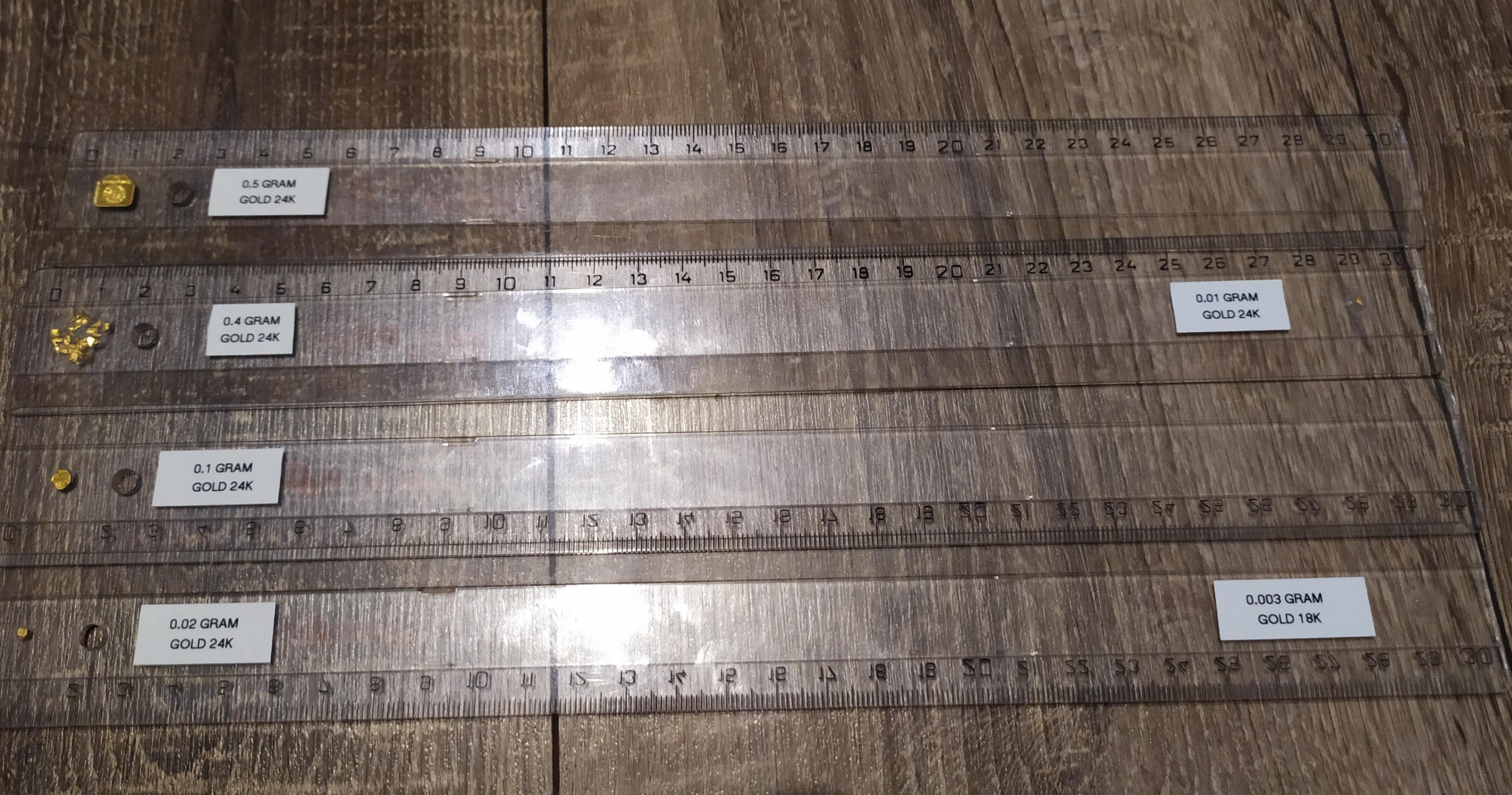

I have read some detectors can detect sub grain nuggets. GPX 6000 being one of them. Thinking #9 lead shot might be about as difficult to detect, I sent some targets to someone with a GPX6000. He couldn't detect #8 or #9 lead shot. Asked in another forum if anyone has tried detecting #8 or #9 lead shot. reply
#8 1 grain lead shot air tested on my 14" DD coil at 1" in Cancel/Normal.
#9 .75 grain lead shot was touching the left edge of the 14" DD in Cancel/Normal.
#8 1 grain lead shot air tested on my 11" mono coil at 1.5" in Normal.
#9 .75 grain lead shot air tested on my 11" mono coil at .5" in Normal.
Another reply was something similar but less distance.
The targets I sent included craft sticks with 1 piece of shot and sticks with 4 pieces of shot. He didn't detect the #8 or #9 targets with 4 pieces either, which should have 4 times the signal strength with the same time constant.
Possible reasons, higher EMI or faulty detector. Possible other reasons?

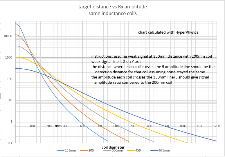

Don't know if being able to detect #9 lead shot is important. Maybe learn something trying. Using a smaller coil makes it a lot easier. Wouldn't be a good coil to hunt with, maybe a backup coil if a spot was found with many small nuggets?
