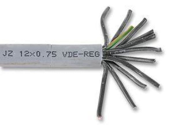

            12-way cable
            Single wire thickness 0.75

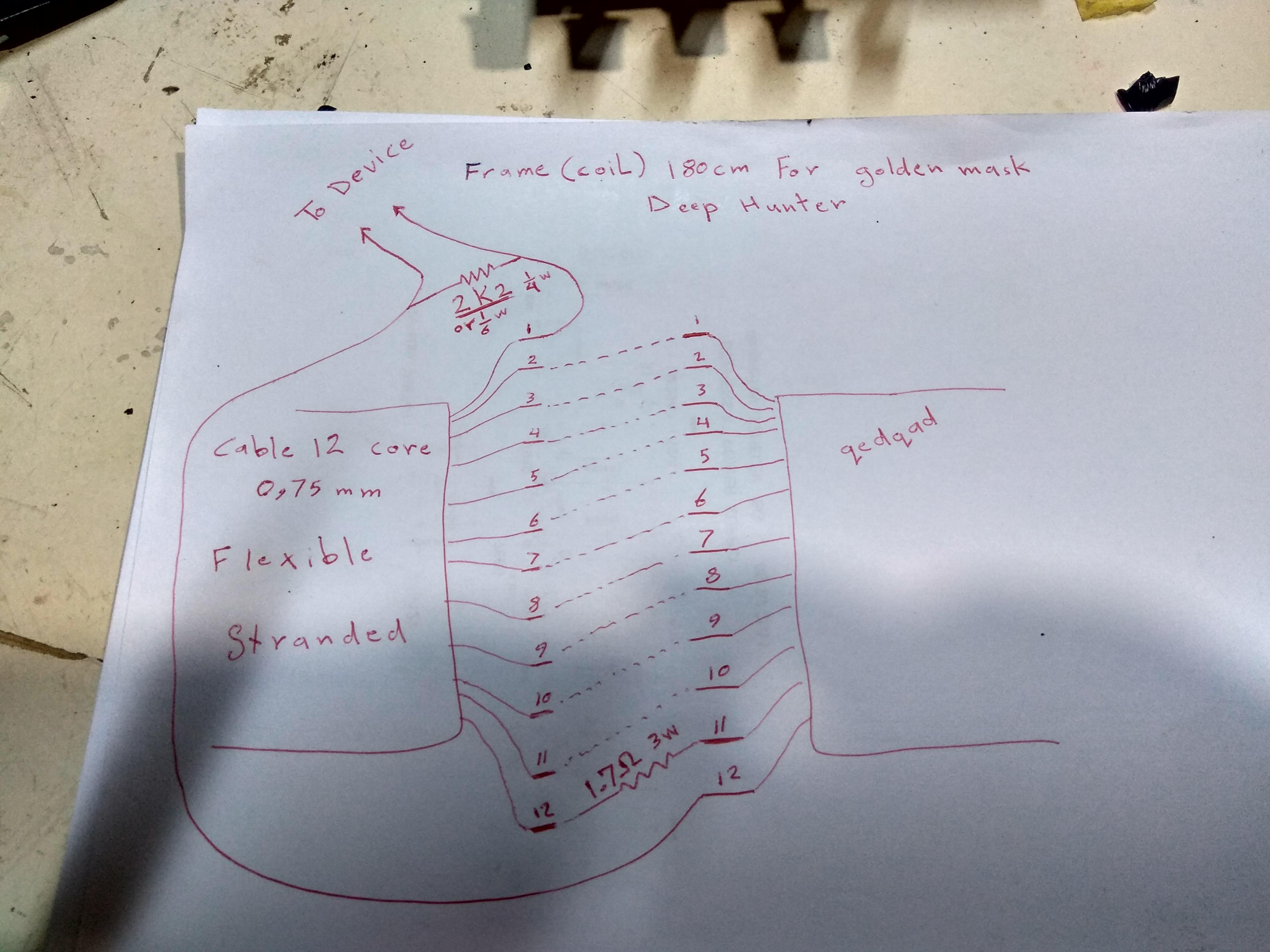

                It is clear to me from the conclusion that the information is correct. But it is not, the most suitable resistance was actually 1.7 ohms in the 1.8 meter coil. The cable was like the smaller coil, but the thickness is more than 0.75, and therefore the resistance is equal by 95 percent and more. In the small coil 125 cm it was 2.5 and in the large 2.6, the depth and stability is excellent. I tried many ideas, but I am sure that if you open the factory coil You will find it close to my result with a very high percentage. I contacted one of them and he owns the two files, and he assured me that the thickness of the large file is slightly larger than the small, and this is what I have the weight of 0.75, it is the standard measurement after 0.5
                  Frame (coil search ) 180 cm for golden mask deep hunter
                  Cable 12 core ( unshielded )
                  wire thickness : 0.75 mm
                  Flexible stranded
                  Final Resistor : 2.5 ~ 2.6 ohm
                    I do not understand what you have done. You said you used 7 turns, but your drawing shows you have used 11 turns; and the resistor is connected differently.
                    However, you seem to have made a successful coil, so I hope it helps you locate some great finds. Best Wishes.
                      from your first story you must set the resistor in parallel to one turn, while on the sketch i see you show resistor in serial.
                      delete it anyway. connect turns directly.
