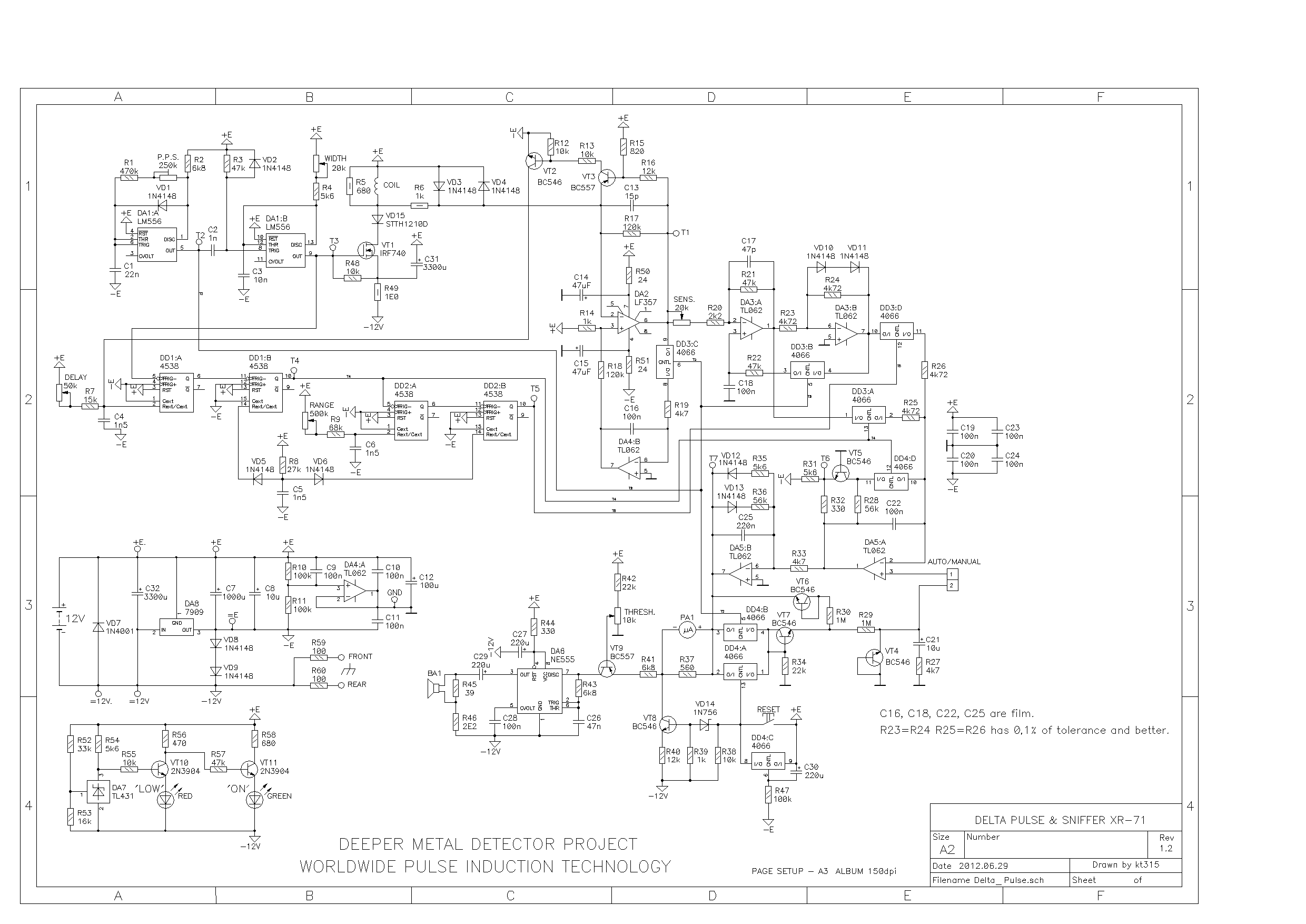

      just trial the boat τηατ l nade delta pulse, and i have problem with the ammeter the waveform should to lhave at am meter.help please
      • revised
        • very good guru,butvnot i have motion in needle of millimeter was the plan helps in was the problem that have.also i nhave normal location metal and iho at speaker

            i do not understand that you ask about do you mean you use a MICROamperemeter and it is the problem? then remove it temporary.
            • BTW uA meter don't need you at all

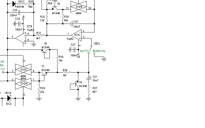

              • Hello KT315
                I think VD8 and VD9, must be removed to function properly the controller 7909.
                As the scheme of manual, automatic?
                This is what I use.
                • hello Jose,
                  7909 is a option. you can use either the diodes or 7909. automatic-manual is also will be a option, there will be a connector at PCB for the switch.

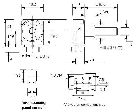

                  I need an info on potentiometers which are more popular among people - dimensions sizes.

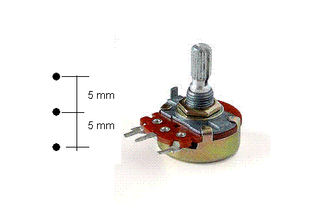

                  • Thanks KT315
                    Potentiometers attached similar picture we use here in Argentina.

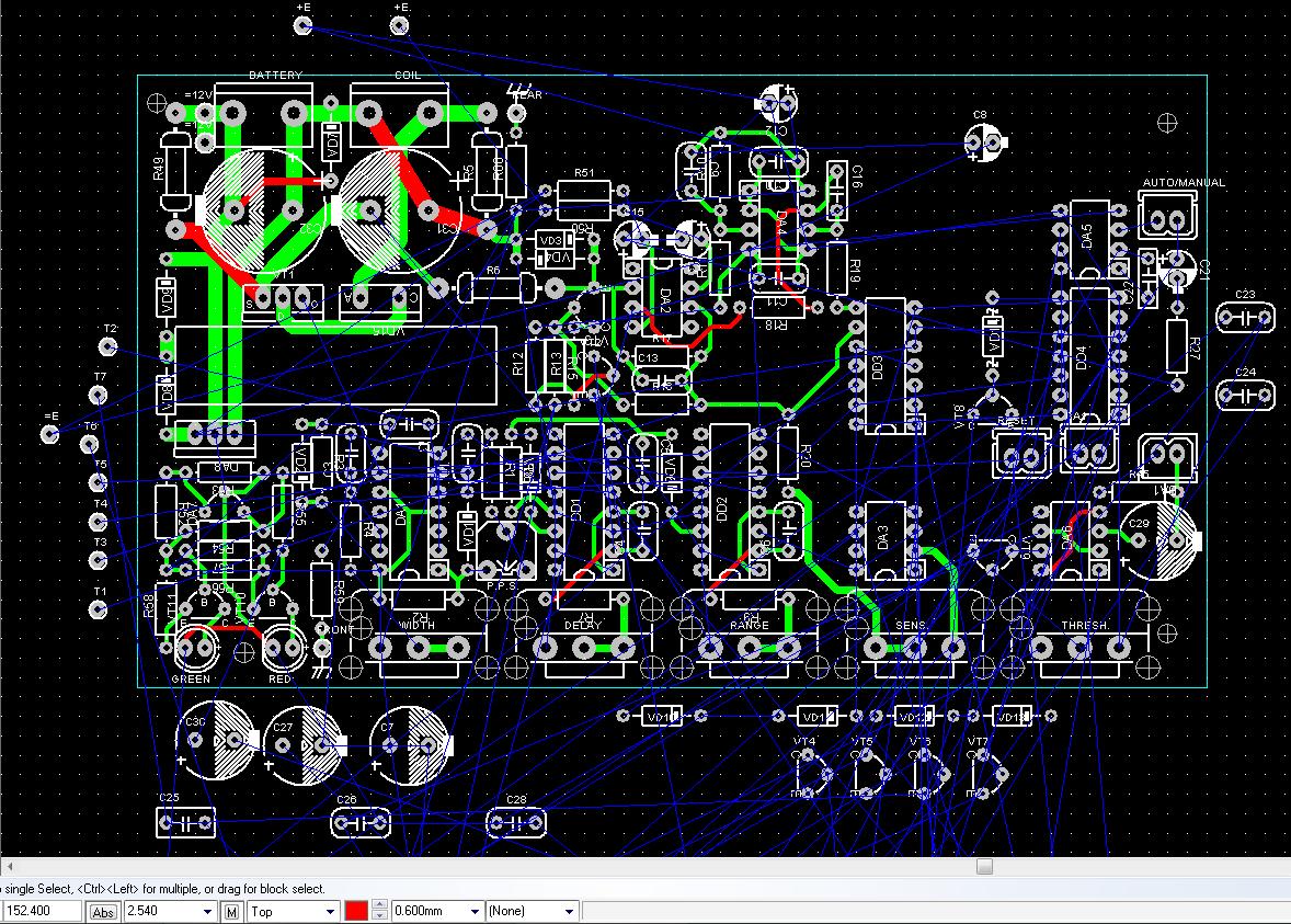

                    • senifer xr71/delta pluse
                      revised
                      hi kt 315 how to possible iron reject mod in delta pluse / xr 71 can you explain some detail next revise
                        Thanks KT315
                        attached files that i googled. can i place a resistors under the pots, for example? is there a necessary height or gap or space for 0,125W resistors?

                          • Hi kt315
                            The best choice is S16KN1 it can be used as much as possible because the depth of the Legs =0.4mm Possible to place a 0,125W resistors under the pots. and u get 0.1mm if cut the smalle metal up the leg.
