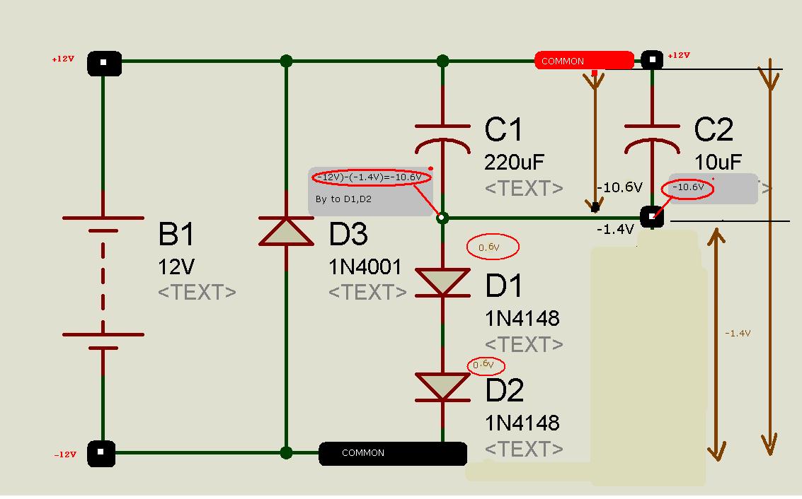

                  the role of these 2 parts 1- to get +E=+12V,-E=-10.6V.
                  2-ITS protection T2,T3.
                  3-Tr1 mean test point.
                  4-T1 is fet
                  5-Tr9 test point=-10.6V
                  best time
                  j.

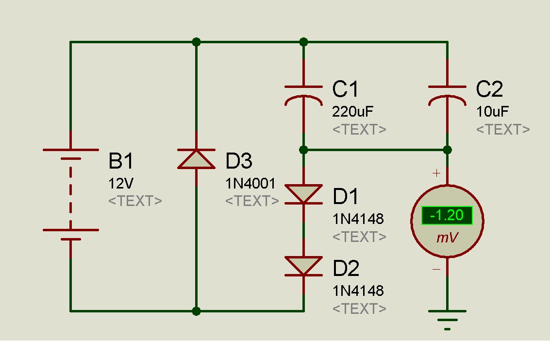

                        hi
                        could you please help me more??
                        I can't get " -E=-10.6v " there is a positive voltage here...I checked my connection, they're not wrong
                        I simulated this part and it doesn't give me any negative voltage??????????????????????
                        what's the problem????????
                        • Hi Kazem2114
                          could you please put a photo!
                          best time
                          j.

                            Thanks for answering
                            This is my simulation...It gives me just -1.2mili volt
                            • Hi Kazem2114
                              I hope I explained Thought.
                              best time
                              j.
                              • Originally posted by jap View Post
                                Hi Kazem2114
                                best time
                                j.
                                Thanks but the things that you're saying , it looks like we have 2 voltage source
                                one to give +12v
                                one to give -12v
                                because the voltage of negative prob of a battery is not -12v , it's like ground
                                Am i right?????????
                                There's no circuit for making -12v in the schematic
