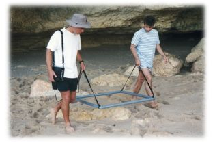

          • You guess my problem! My Delta Pulse can sensing only bigger metals but not coin sized features. And this is normally that I take a metal away, the ticking sound surrounding a delay?
            • delta pulse is NOT for coins' sized features. DP works with HUGE COILS. HUGE!

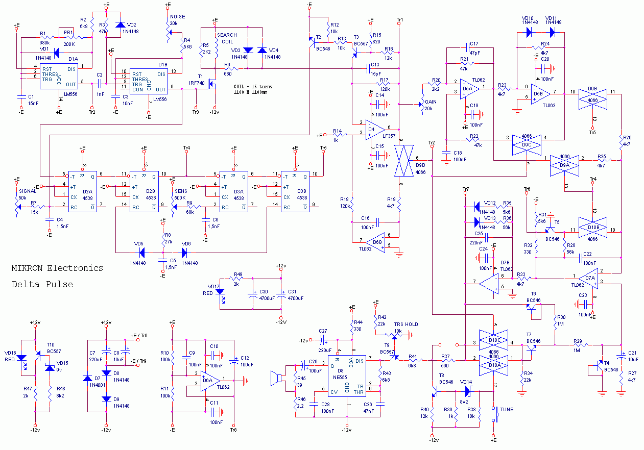

                    • Hello to all, can anyone tell me where is the reference point for DC measurements in this scheme?
Name:	delta pulse sch.gif
                      • if you take any PI schematic you will see there a reference point on +12V (+BATT). because you must sheild a coil from +12V, if you want to shield. so this bulgarian schematic is not right on reference. you may use then -12V=-BATTERY or what you want.
                        • Hello.
                          -12v, so -12 to +12 = 12V.
                          -12 to gnd = 6V
                            Hello.
                            -12 to gnd = 6V
                            Thanks for the clarification kt315 and Geo.
                            • Good evening ..
                              Can someone from here Please note the schematic point (sampling integrator) ..
                              I want to understand this part..
                              Thanks in advance..

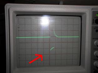

                              • Good evening again in ALL HERE ..
                                I WANT YOU TO ask about the pulse , The deformation that exists in the pulse T.X at coil UP . looked a bit picture I believe that it should not be so .
                                from what can to this is happening ..
Name:	g.s delta pulse T.X.JPG
