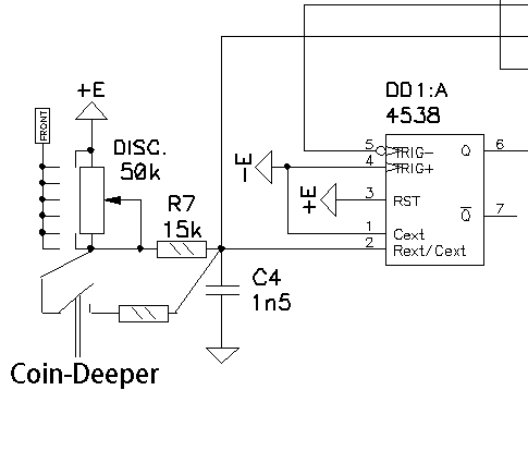

            do not see a problem to set a additional knob, simplest mod, by one click it will choice either deep cache or coins. Click image for larger version
              use two mode frequency in 500 and 130hz .PW at 90mks to 270mks .
              Taking into account what you wrote in #2636, if that is accurate I think your pulse width needs to be ~300us. Using 90us would be a waste of time.
                dear friend i use selector and i can use 155mks , 180mks , 203mks , 235mks , 275mks . i use 130hz for 1*1coil and 500hz for 45*45 or lower than this size.

                  • Some comments on my experience with Delta Pulse, I can be wrong or not, but maybe someone will find it useful.
                    Coil Shield for 1X1 mts.? , If you can use.
                    How to do it?. I do not know, try tape Scocht No. 24 and did not work.
                    Blinage in the coils is necessary 1X1 mtrs.?.
                    It is recommended that coils, weighing less than 20 or 25 microseconds delay be shielded, but coils 1X1 mtrs, generally have a greater than 30 microseconds delay, so it would not be practical in my opinion, shielding these coils.
                    Minimum time delay, in the Delta Pulse.
                    You can decrease the time delay making modifications as mentioned in the previous post by KT315, but the minimum you can get is about 17 to 18 microseconds, the issues related to the design of the front of the DP, so I not convenient to use between the MOS and diode the coil, as the main advantage of this diode, is annular MOSFET stray capacitance.
                    Instead, this dido produces voltage drop, which can affect the power supplied to the coil.
                    Coil resistance.
                    The resistance of the coil, with its inductance affects the current flowing through it.
                    High currents in the coil, producing surges that are difficult to adequately cushion, DP accordingly, becomes unstable.
                    So I think the coils in the DP should not be lower than 3 ohm resistors, including cable.
