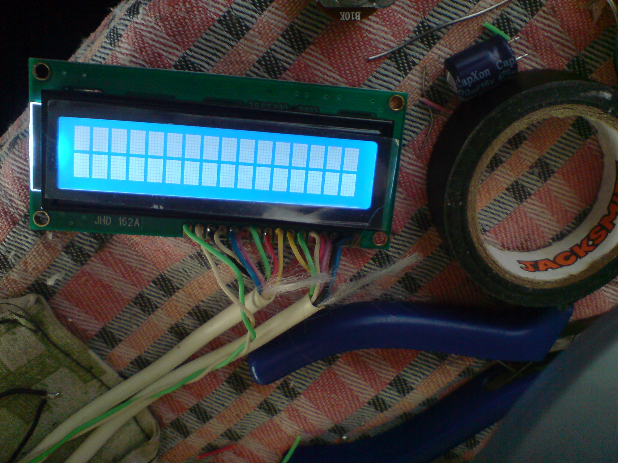

          hi
          why dont show . i try more and all connection is correct so .....i put 10k volume .
          see
ID:	342451Click image for larger version

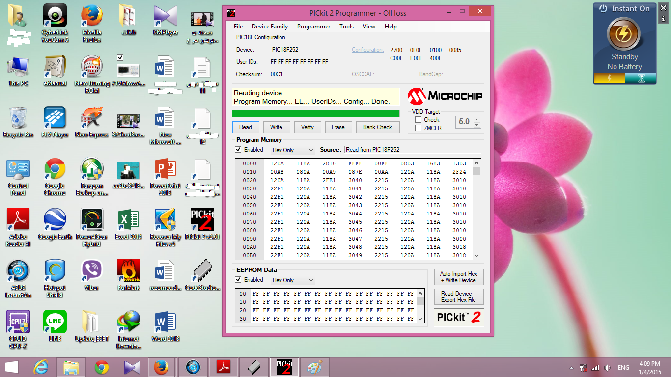

          • the programmer use ?
            Try PICkit- 2 , ver : 2v2.61 !
              hi
              see
              • Again view connection between lcd and pic 18f252 !that quartz crystal use ?
                attempt 10mhz !
                  attempt 10mhz !
                  i use 20mhz like pcb , ok i check pcb if dont ok ,i should use 10mhz!!!!

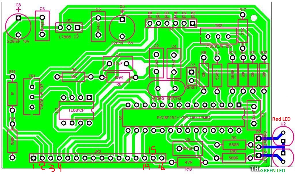

                      i certain red and green led in pic.red for nonferrous and green for ferrous.is ok?
Name:	Pulse Delta 2 with Circuit Discrimination.jpg
                      please guide me for set it (TR1 & TR2)

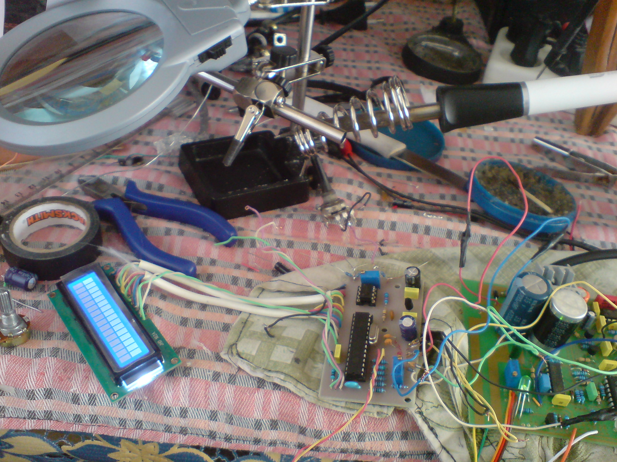

                        my problem not solve.
                          hi
                          pin 7 and 8 18f252 should connect together or no?
                          • Orbit hi
                            i program that you send here PIM 2.rar .program complete but dont work.
                            i erase it and program with this file see.but it is demo ( pcb was correct but program is not) , i need complete who is have it??
