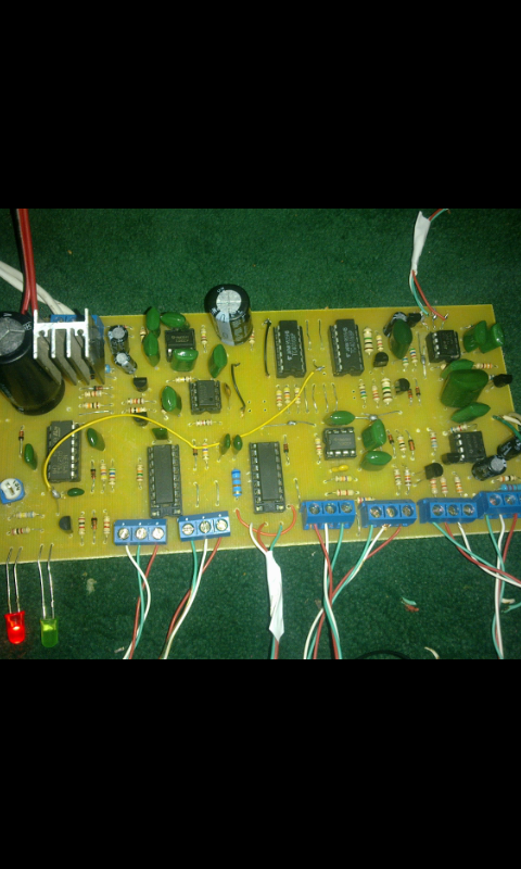

I assembled the device on a single-sided Board.
Immediately am asking forgiveness, that my of knowledge in radio electronics not strong, so can be quite elementary questions). No offense :-)
All the parameters of the component was observed.

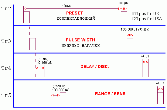

The test coil is 40cm in diameter, 24 round solid conductors mm 0.5 - 3 coils 8 core Ethernet cable soldered into a single line. 390ohm coil damper resistor. Energy consumption 130-150mA. ICS and irf740 are not heated.
When the power is turned on, the device responds to all the variables of the torsion bar, reacts to the reset button. The sound from clicks to high tones. The coil reacts to the metal. Oscillogram meet the requirements, the pulse width TP2, TP3 and intervals TP3-TP4 TP4-TP5 within the acceptable range, change the adjustment of the respective variable resistors.
The only thing I don't like about oscillograms is the pulse width of TP4 and TP5 = 25.9 us, while it should be 45us.
Can this mismatch somehow adversely affect the operation of the device? How to adjust the correct pulse width? Currently, the sensitivity to iron pliers is about 30-35cm. I'll shoot a video later. That's not much. How to increase sensitivity?
The aluminum can is 30 cm high and 12cm in diameter, the sensitivity is poor, fewer than pliers, which are much smaller. Due to what it is possible to increase sensitivity to non-ferrous metals?

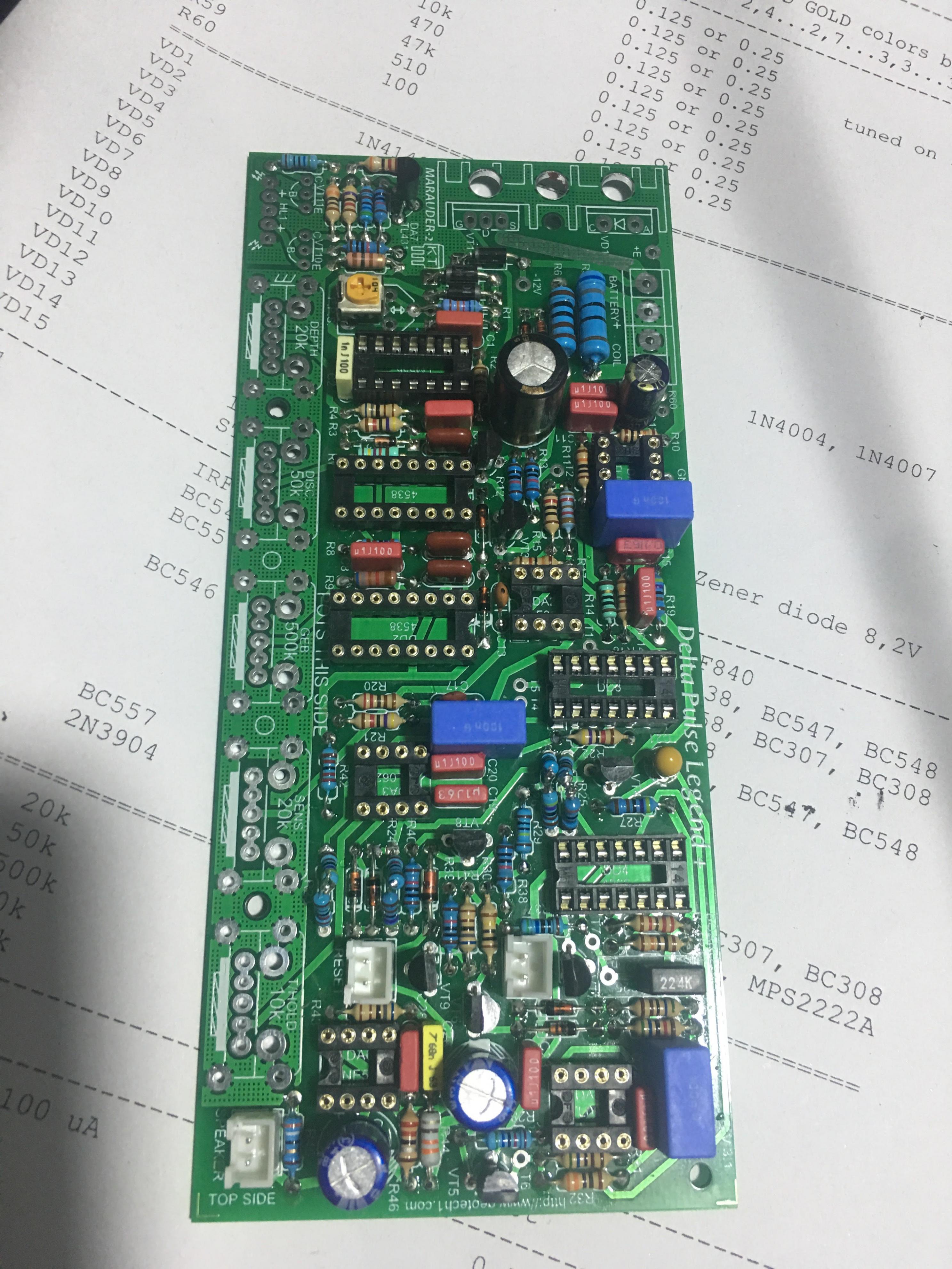

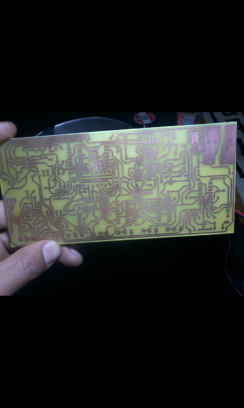

I build delta plus 2 with the turcksh pcb and the detector not working ....its detect my hands only ...if I put the j3 switch up its detect my hands ..and for down its didnt detect any thing ..
I made nice pcb and do every thing the same
the sound.noise.trashhold.sens.gain.signal. working but its didnt detect I usa 110cm coil with 16 turn and 680ohm ...pleas helpme
