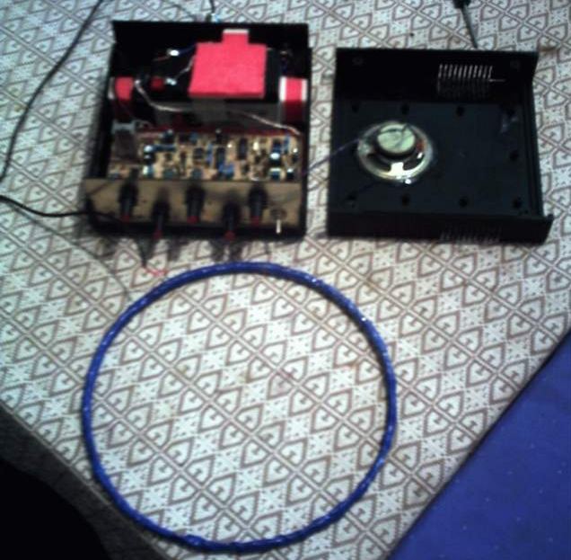

      After 10 Delta Pulses i have to admit still dont know
      everything about PI's..!?
      Nothing to do these days, it is kind a monotonous here,
      so i decided to make small coil for DP.
      I used datas from Hammerhead project:
      20cm diamm. wire 0.45mm 26 windings...
      Finally resistance is 1.5 ohms.
      Also Faraday cage applied (for the first time) in manner
      to check this coil on higher frequencies also.
      Since reistance is to low i expected fet to become very hot
      in no time. I didnt used serial resistance, just waited to
      see what's gonna happen...
      And nothing happened???? Detector is working good, fet is
      cool ???? After 20 minutes still cool???
      Oh, yes, i already put heatsink, but small one, just as
      "ornament" cose previously i ran this DP on low frequency
      with 4-6 ohms coil resistances, so heatsink was needless
      at the time...
      Still, fet is cool, heatsink also???
      I am confused! Now i do not understand this?
      I adjusted all pots here and there, made all combinations
      and waited fet to become hot - without success!?
      1.5cm bronze coin detects at 25cm distance, very sharp!
      1l paint can detects at 80cm sharp and at 1 meter with variations in
      audio...
      Small iron plyers detecting at 50cm distance....
      Not so bad at all, considering size of a coil - just 20cm...
      "Reject" pot. now working very noticeable as "Disc" on VLF's, but
      oposite;
      -When "Reject" low, DP detects all sort of metals same,
      -"Reject" on "3" , DP stop detecting Al,Foils,some coins
      -"Reject" on "6" , DP detects only iron, but very good!
      What is this? Sort of discrimination?
      Can anybody check this on other machine, i would like to
      see some comparsions...
      P.S.
      I forgot, freq. is 270Hz with this setup...
      Hi ivconic,
      "freq. is 270Hz with this setup" ok, what's TX on time ?... it's the other key factor that determines consumption... and Vcc value is another one, and then you must consider inductance/resistance and then calculate the peak current (when your fet switch-off happen) and also average power of one cycle using integral of charge function of inductor...
      Another thing that's important to notice if there will be too hot running on fet is its breakdown voltage and ...cause at breakdown, during switch-off, your fet must dissipate energy due to collapse of magnetic field, cause by Lenz law you coil store this energy:
      |e| = |L* di/dt|
      High breakdown voltage mean that your fet "opens" before of small breakdown devices (e.g. BUZ11)... then the eccess energy goes at ringing dump at dumping resistor (that become sometimes more warm than fet!).
      And , of course clamping diode that suffer forward conduction during switch-off.
      I had a trouble on XR-71 due to these facts... then have to change BUZ11, cause have it warm too much (freq. 400+ Hz), I've used there with an IRF740 (400 volt breakdown voltage!)... even if so I have more Rds on it remains cool (and now is big dumping resistor that dissipate big fraction of energy)!!!
      Best regards,
      Max
      • Hi All .
        First for Max. I work my DP at 100 to 400Hz. 400Hz is better because it has better response (at 100 hz i must move slowly the coil if the signal is low otherway i lose the object). The clocking is the same at 100 or 400 Hz. Yesterday i changed the first delay from 30us to 12us. Results....... very bad depth..... why????? i had not time to check it with oscilloscope. I believe that the problem is the coil (maybe it can't go to low). I want to minimise the max delays time so to can increase the freq to 800.... 1000 Hz for small objects detecting.
        Now to Ivica.
        How and Where are you. I have long time to write you. Of course i am very busy this time and i didn't made a tesoro GS . What about 1266 ?
        Now for DP. What are you mean reject? is the first delay Tr4 or the second delay Tr5. If it is the 1st delay then yes if we play with it we can reject some objects. At my detector i have the best results with the potentiometer about short 30....40us. The sensitivity is about the same, max 30cm for 2 euro or 1/2 euro with coil 25 cm 1000uH. With lower inductance i have a little better results but it needs lower dumper (1k/1W now i have 2k2, 1/4w) and is not so stable.
        I forgot .... with delay to 80us you can reject the ceramics.
        When i will finish the works (maybe on October) i program to construct Barracuda..... 1266 ........ and GS4. IT IS OK TO SPENT MY TIME ON WINTER.
        Best Regards
          I can suggest you only GS4 to make....others forget...Not worth!
          But you must have accurate schematic and pcb for GS4. As i heard, those posted here are not accurate!? Not sure, but heard that way....I would like to make GS4 also, but do not want to waste my time with faked schematic and pcb...Maybe you can help?
          About DP. Aside other things, only thing which interesting me is fact that fet is very cool with 1.5 ohms coil?????
          In the past i have a lot of problems with larger coils under 4 ohms...Fet was very hot than?
          Best regards!
