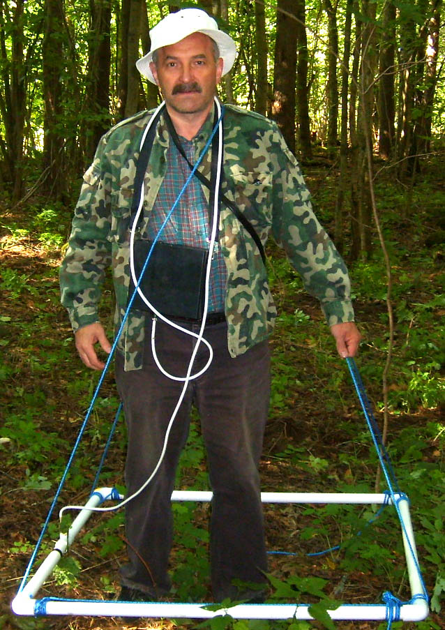

                      • a device has been priliminary checked and tested. mainly at lake. a place with something metalic at lake bottom was been observed. a device was enough stable.
                        HH
