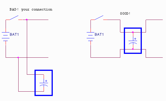

                  • Alexander, is it this pix CLEAR for you or not? can you RECONNECT your wires according the pix?
                    I see your elecronic skill is very low, you must read more technician books.

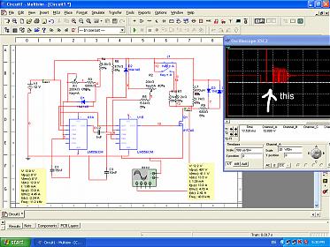

                        i want to design big coil for delta pulse and i have simulated coil parameters
                        and i see changes in the pulse (like a self-oscilation) i don't now
                        can someone tell me whwt couse this changes like in the picture

                          • Try to use a 1mH coil. Original coil is 1.1 x 1.1 m 16turns. After coil construction you must play with damper resistor. If you leave the frequency at 100Hz then the existing 2k2 is OK.
