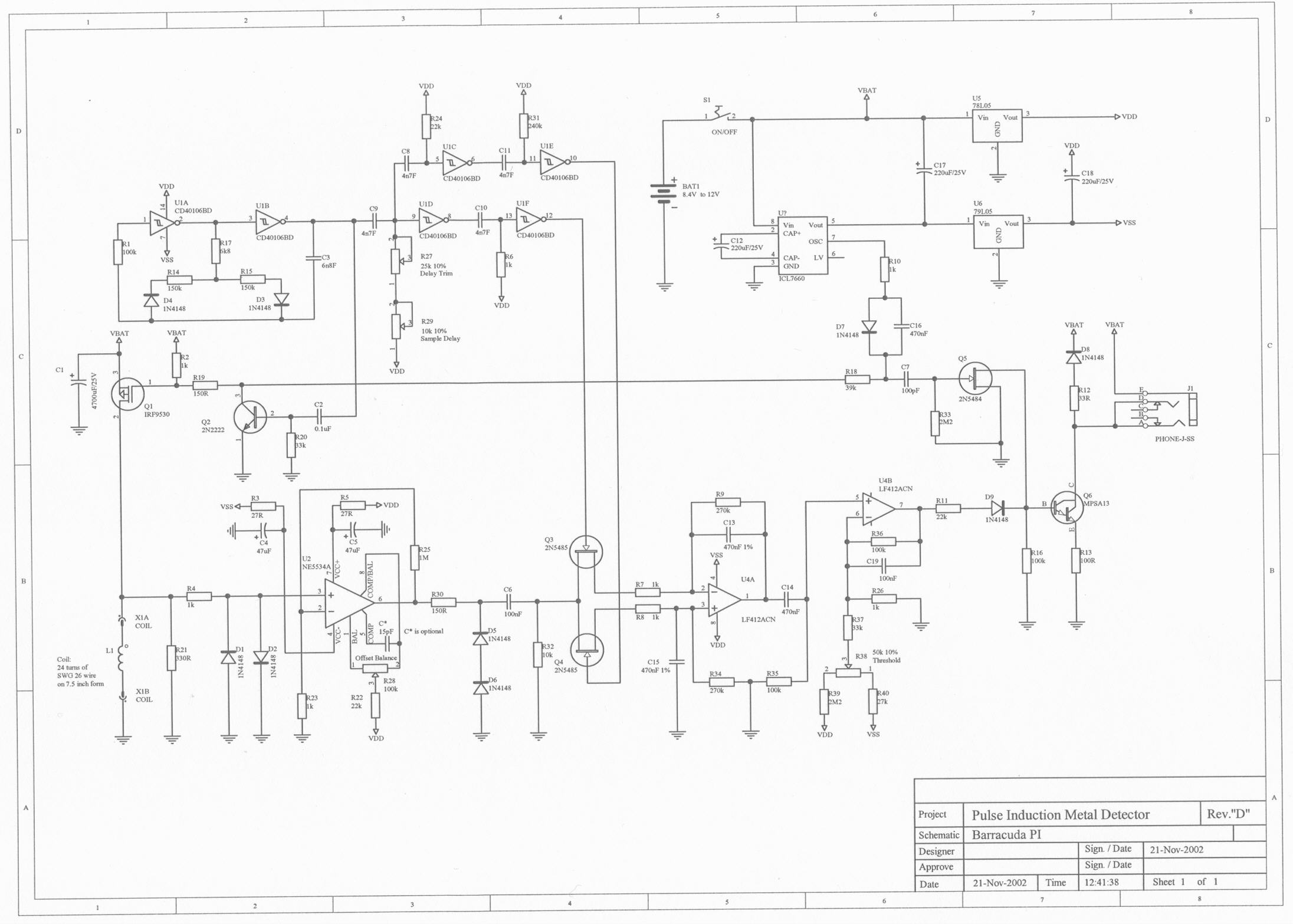

                        Hi detectoman.
                        You can build the Barracuda PI detector. It is one of the best detectors, simple and with common components.
                        For Okantex.
                        D7 (1N4001) is not important.
                        It needing to protect the detector from reverse supply.

                              thanks brother geo for these diagram gime to me, is the barracude deeper? is stable? i think the ics of barracude ,are very hard avaliable , ok geo you read the panel faraday shield, of coils, i put one information well for you of my invest
                              ok best regards geo
                              till tomorrow
                              detectoman
                              • #90
                                other diagram is the mini plus detecor ,you tink these is best?
                                ok best regards geo
