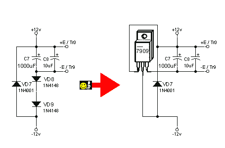

                    • did this mod, but still did not tested at nature. thinking it would be increase the stability. enjoy!
                        hi kt315,
                        you mean replace irf840 with 7909 ?
                        i find a mistake in compesant 1.5nf , now my DP is better it can detect a canet coka at 85cm , but is not stable
                        thanks for helping

                          • Originally posted by raff33 View Post
                            hi kt315,
                            thanks for helping
                            I do not mean to replace MOS-FET with 7909. you add this IC for to supply all schematic by stabilised voltage. test all accumulators - this is your problem! one AA size unit must give you 9-10 A of current on your digital tester in full charged state! if you do not get this current - you do not get the stability NEVER MORE!
