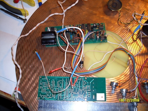

        • Hi @kt315,
          I very much like the Search Coil that you (or @Sergej ?) have made for the Delta Plus Metal Detector. And I am wondering, ... would you mind posting a 1:1 PDF-File for this Coil, because I would like to make it. And you probably also have the Specs for this Coil too.
          Furthermore, Coils like this can easily be Silver Plated, which will enhance the Q-Factor. I can supply you with a few non-Cyanide, and also Cyanide recipes for this procedure if you don't mind working with highly toxic plating bath solutions. There are two chemical ways to go:
          1 - Electrochemical plating, in which the thickness of the Silver layer may be varied.
          2 - Non-Electrical plating, in which only a microscopic thin Silver layer will be deposited on the Copper layer. The Silver plating solution may then just simply be rubbed on the Copper layer with minimal plating solution used.
          A third way to go is vapor deposition of Silver in vacuum (or in an inert protective atmosphere), but then the Photosensitive layer should best be applied only after the plating job has been done.
          Robert
          Attachment: PCB Coil made by @kt315 (or @Sergej ?)
          • hi Robert,
            you maybe in course I do not interest some topics. absoliutely. this spiral coil made in textolite specially is out my interest. the textolite has a capacitivity more than one of air - is it A FACT for you? if not... do it and Good Luck buddy... if yes... you are on right way of great sense in this our life.
            all best
              hi Robert,
              ... textolite has a capacitivity more than one of air ...
              Hi @kt315,
              Thank you for your reply!
              OK, so you are saying that PCB Coils have a higher Capacity than Air Coils do, and thus Worse Specifications. In this case, I will NOT build one like this. Then I rather spend my time building Air Coils, seeing that you say they are better than PCB Coils.
              Thank you for telling me this!
              Actually this makes sense, and it does not surprise me at all, for I have read that PCB Coils have bad Q-factors, and that's why they use Teflon and certain Ceramics to etch on the Coils instead. But then these Coils are also not intended to be used as Metal Detector Coils.
              I am now pleased to have NOT waisted my time on a PCB Coil. And I will now concentrate on a Coil made up of Litz Wire, and with a Carbon Shielding like MineLab uses. You have prevented me from waisting my time, and being very disappointed with the obtained results.
              I do not have your experience with Metal Detectors, and very much appreciate your comments on this matter, for I can learn allot from people like you.
              Robert
