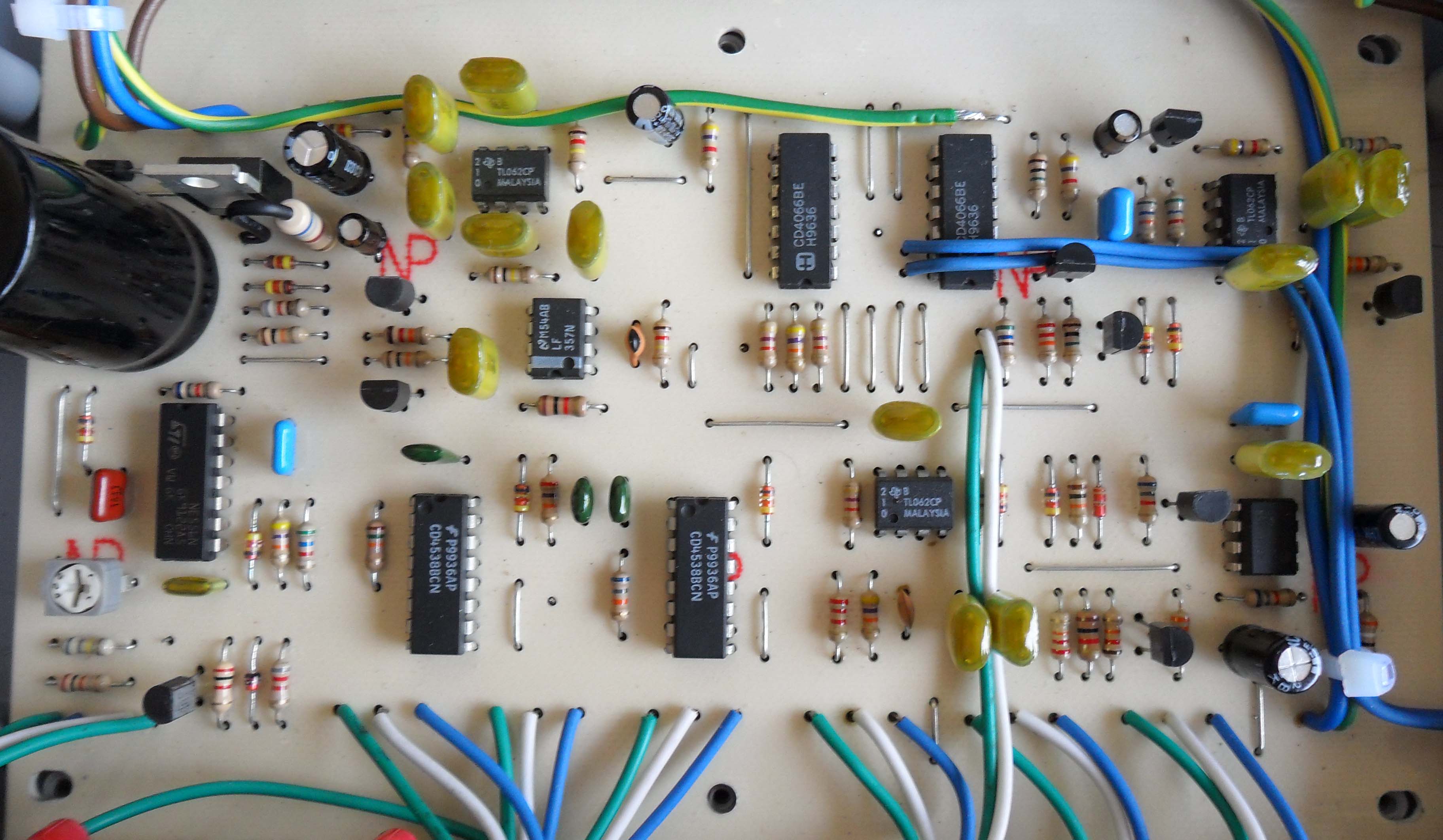

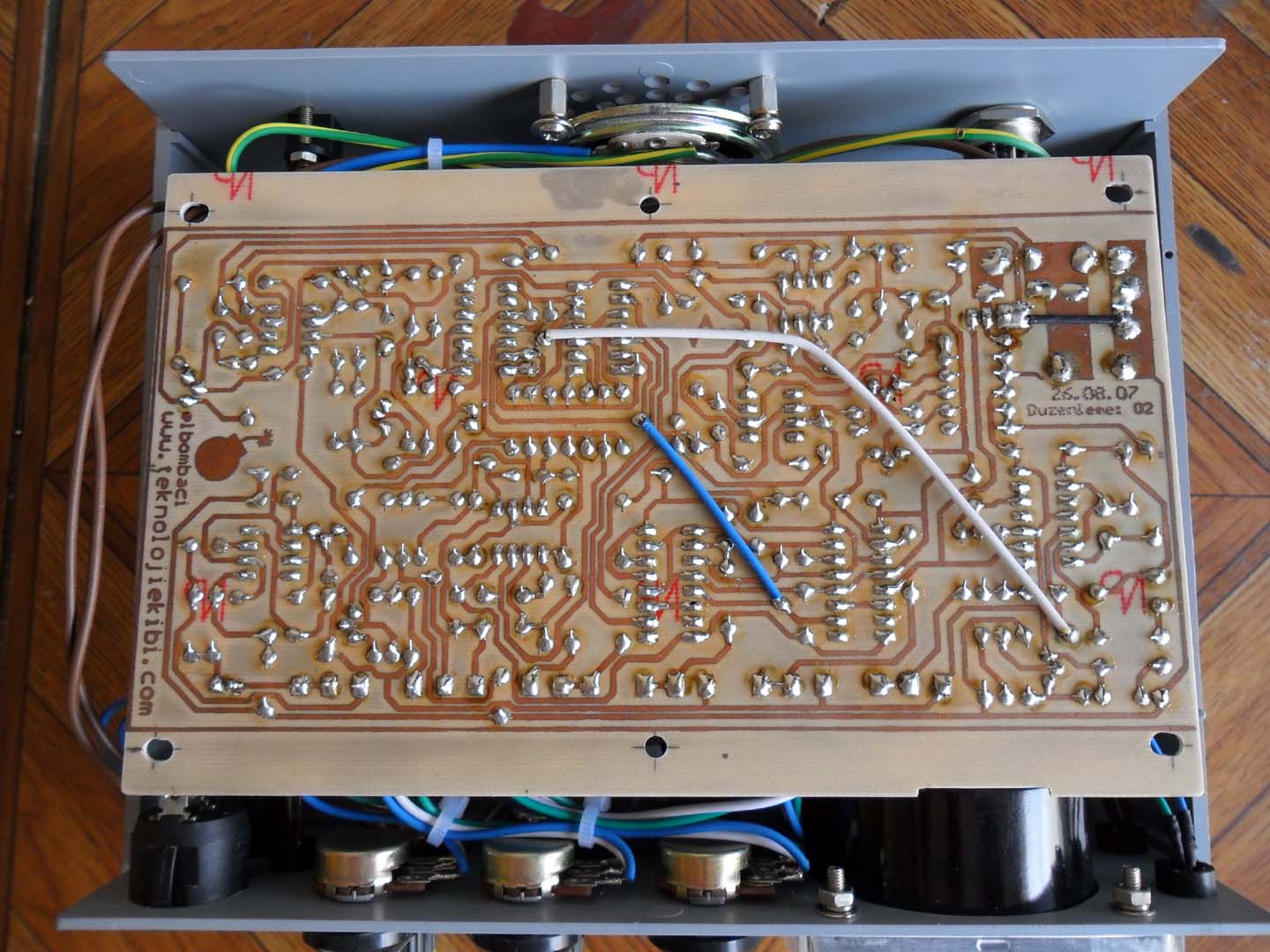

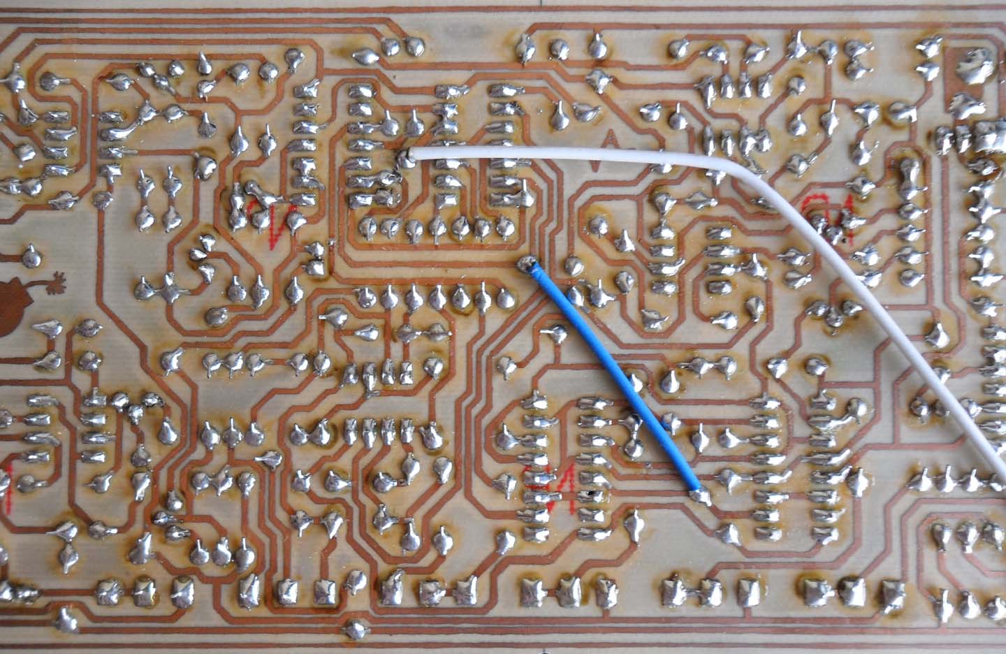

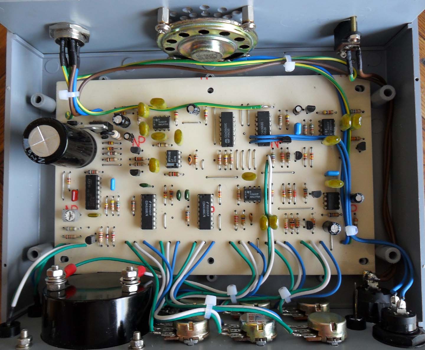

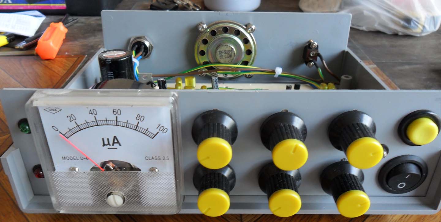

                • akademiker & raff33,
                  Thank you again for the info.
                  Here is the picture of my DP assemble, please check if I have a problem coz the unit until now is not working. 1st when I switch on the power I heard sound ( full volume control knob ) then after a sec I push the reset and start the low pitch of the sound then after adjustment of threshold and noise knob the sound became silent but never detect a metal. Thanks in advance for the advice.
                  vourvon
                  • hey you there... say why you do want use an radiator? on big PULSE WIDTH 300...400...500 usec MOS-FET is like hottie omelet. DELTA PULSE is NOT ORDINARY PI, like Surf PI for example, it works on huge PULSE WIDTH value... desolder MOS-FET. put on stand alone radiator. I will not again repeat why you have to do it.
                    • kt315,
                      Thank you for sharing and I know that is one requirement to put a heatsink, soon I will used when already have but now I'm not encountered overheating of MOSFET only warm maybe because I don't know the setting of knob also the PULSE WIDTH for 300...400...500, Can you explain how to get the pulse width and how to work the:

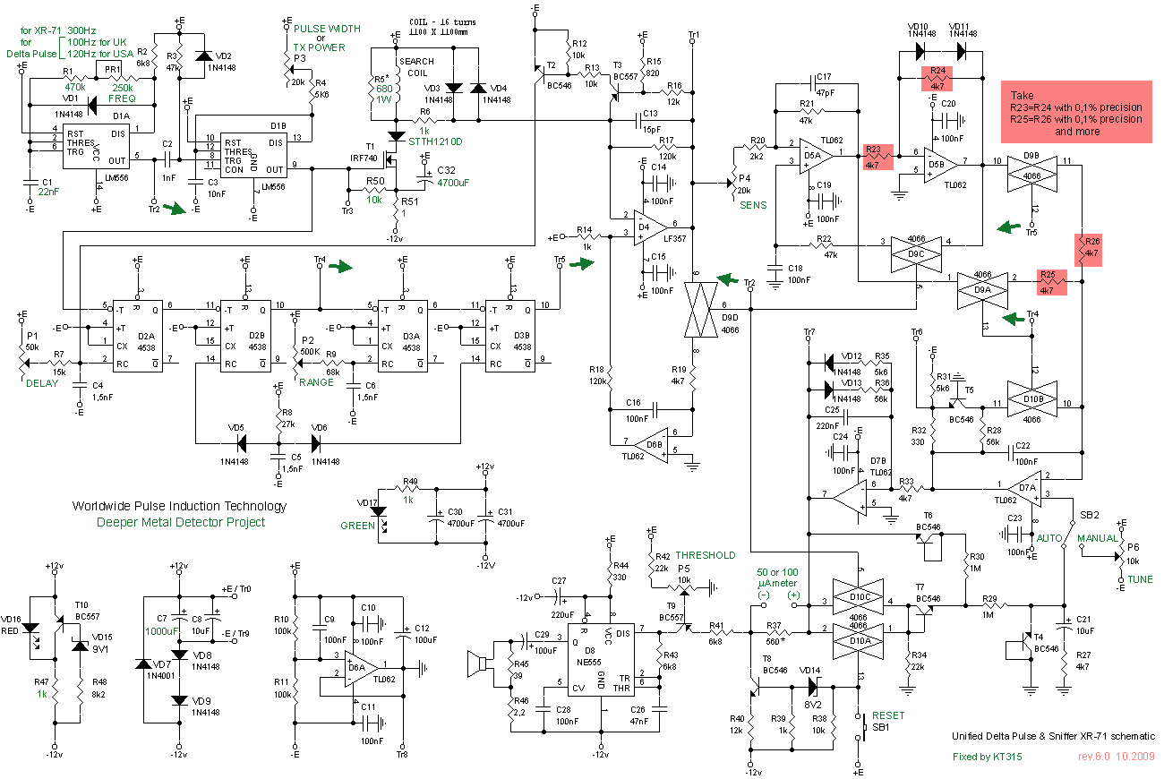

                      • where you see "NOISE" "SIGNAL" "GAIN" on the schematic here?
                        WHERE????????
                        • kt315,
                          I used this schematic. Anyway to align to your post schematic here is the controls:
                          1. Pulse Width or TX power = ???
                          2. Delay = ???
                          3. Range = ???
                          4. Sense = ???
                          5. Threshold - ???
                          Thanks in advance.
                          vourvon
