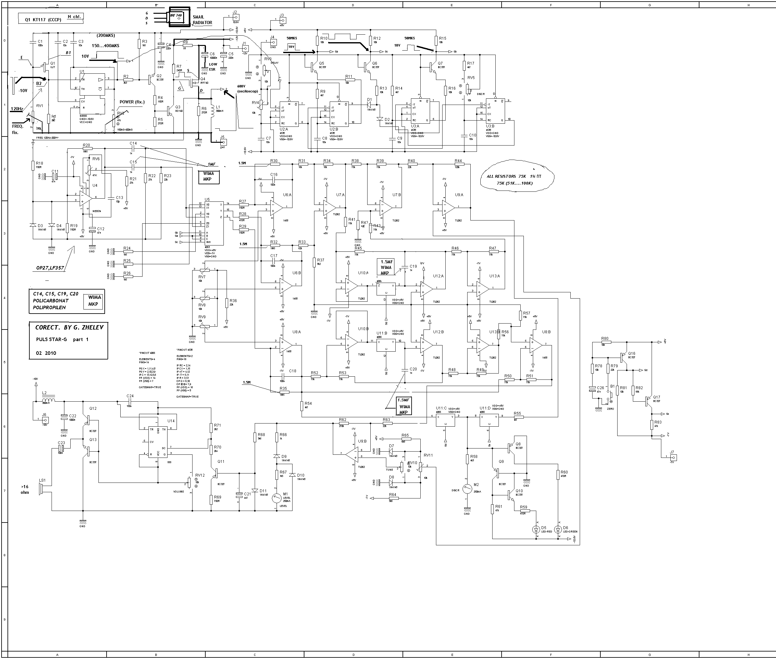

      Mes,the problem for you is Q1 it is not an ujt it is a FET
      • #78
        PS-G
        HI all.
        Q1 IT IS NOT " FET". Q1IT IS UNIJUNCTION TRANSISTOR "N" CANAL !!!!!! ( еднопреходен на български език)
        КТ117 (CCCР)
        ЕRROR !! 2N2646 IT IS " P " CANAL!!!
        MESYNA, Q1 UJT "N" CANAL. ok?

          Hello Friend's
          dear georgi.g.zhelev
          I put the 2n2646 transistor circuit and transistor osilator I worked with and the frequency was about 350h. But when a little rv1 Wind higher frequency was extremely hot and will irf740 and fuel.
          If the channel following is 2n2646. osilator why it worked?
          dear Alexismex I agree with georgi.g.zhelev the comments. I'll guess that the transistor is q1 a ujt.
          Rv10(tune) is when the voice is not heard of any Wind. Without coil and coil. Why? What is your opinion problem?
          Pulsed devices such as the point without the rotor coil when the alarm tune, but this undermines the device does not show this reaction.
          I put tl072 instead mc1458 this is true?
          Please help me
          With respect
          mesyna

            PULS STAR-G
            "PULS STAR-G" COR. + OSCILOGRAMS
            • #81
              PS-G
              MESYNA,see schematic the oscilograms.
              1. freq. 120 Hz
              `2.power 150.....200mks (max)
              3.IRF 740 -smail radiator
              4.IRF 740 Dr. 500...600v (osciloscop)
              5. Q1 (555 pin 2) impuls negativ -10v 120Hz....500Hz ,fix.120Hz !!
              6 OP ampl. 062, 072 ,lf353 ,1458 test the best.
              7. coil 32 turns 2x 0.5 mm email lac BIFILIAR; or 32t , 0,7....0,9 mm em. lac izol. R=07...1.2 ohm !
              GL!

                Hello freind and georgi.g.zhelev
                I was faced with a problem. When the transistor circuit 2n2646 and irf740 put vr1 change and I give for a moment oscillator works in a second and then irf740 limit severely hot and burns as well as r8 All parts Electronic oscillator all the reviews I have no problem but oscillator does not work. Rv1 only after the change to the frequency for a moment and then extremely hot irf740 and burns. I do not know is the problem. Please help me
                With respect
                mesyna
                • #83
                  With respect
                  mesyna
                  Q1, this is problem , 2N2646 "P" ch., change to "N" ch. smail signal .
                  NE555 pin 3, positiv impuls 10v , 150.....400 mks , freq. 120 Hz ,yes or not ??

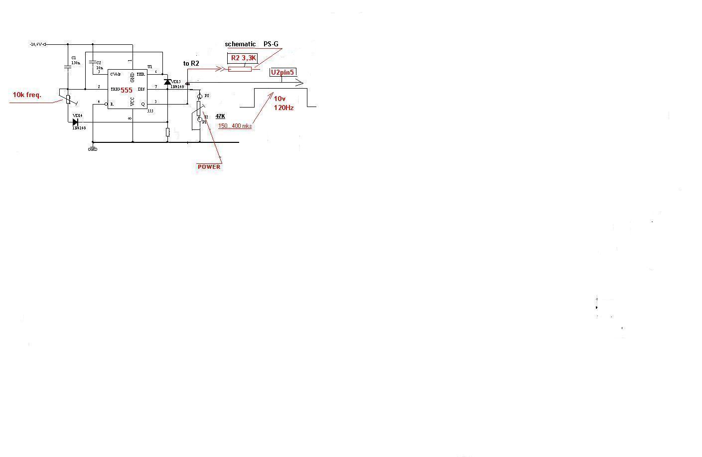

                    • #85
                      PULS STAR-G
                      Hi, all! Hi mesina! SEE SCHEMATIC VARIANT 2( generator 555)
                      BF 245 - FET transistor
                      KT117 - UJT (unijunction transistor N ch.
                      GL

                          MESINA,change schem variant 2,wil work! UJT N- chennal (simolar), i do not know (problem), for 2N1671 no information P ? or N?
                          • #88

                            • #89
                              PS-G
                              POWER SUPPLY ?? ? pin1 -10.6v ; pin 8 GND ; Rx = 51....68 k
                              ok?
                              variant 1 (kt 117) = variant2 ok?
                              GL!
