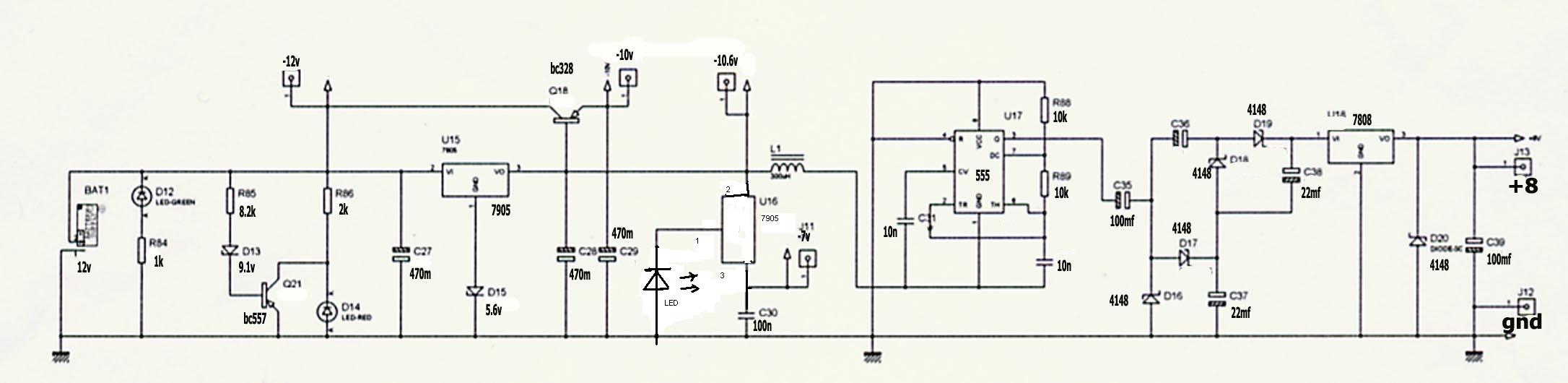

                    • dear georgi.g.zhelev
                      can i replace resistor 68k to all 75k????
                        Voltages required for this work metal detector are
                        -7 V +8 V -10.6 V -12 V -10 V
                        Despite the above schematic of the voltage of 7905 volts and -10 volts -10.6 is reasonable?
                        7905 because the maximum is 5 volts. To do what you do??
                        This can be lm317 circuit lm337 be used instead?
                        In your opinion, my problem is the supply voltage?
                        The voltages required for the preparation of schematic is correct?
                        With respect
                        mesyna

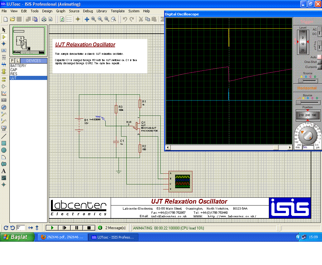

                        • Originally posted by mesy64 View Post
                          Hello Friend's
                          I put the 2n2646 transistor circuit and transistor osilator I worked with and the frequency was about 350h. But when a little rv1 Wind higher frequency was extremely hot and will irf740 and fuel.
                          If the channel following is 2n2646. osilator why it worked?
                          dear Alexismex I agree with georgi.g.zhelev the comments. I'll guess that the transistor is q1 a ujt.
                          Rv10(tune) is when the voice is not heard of any Wind. Without coil and coil. Why? What is your opinion problem?
                          Pulsed devices such as the point without the rotor coil when the alarm tune, but this undermines the device does not show this reaction.
                          I put tl072 instead mc1458 this is true?
                          Please help me
                          With respect
                          mesyna
                            With respect
                            mesyna
                            LM317 this a for positive voltaje input. LM337 for negative voltaje
                            • CHANGE LM337
