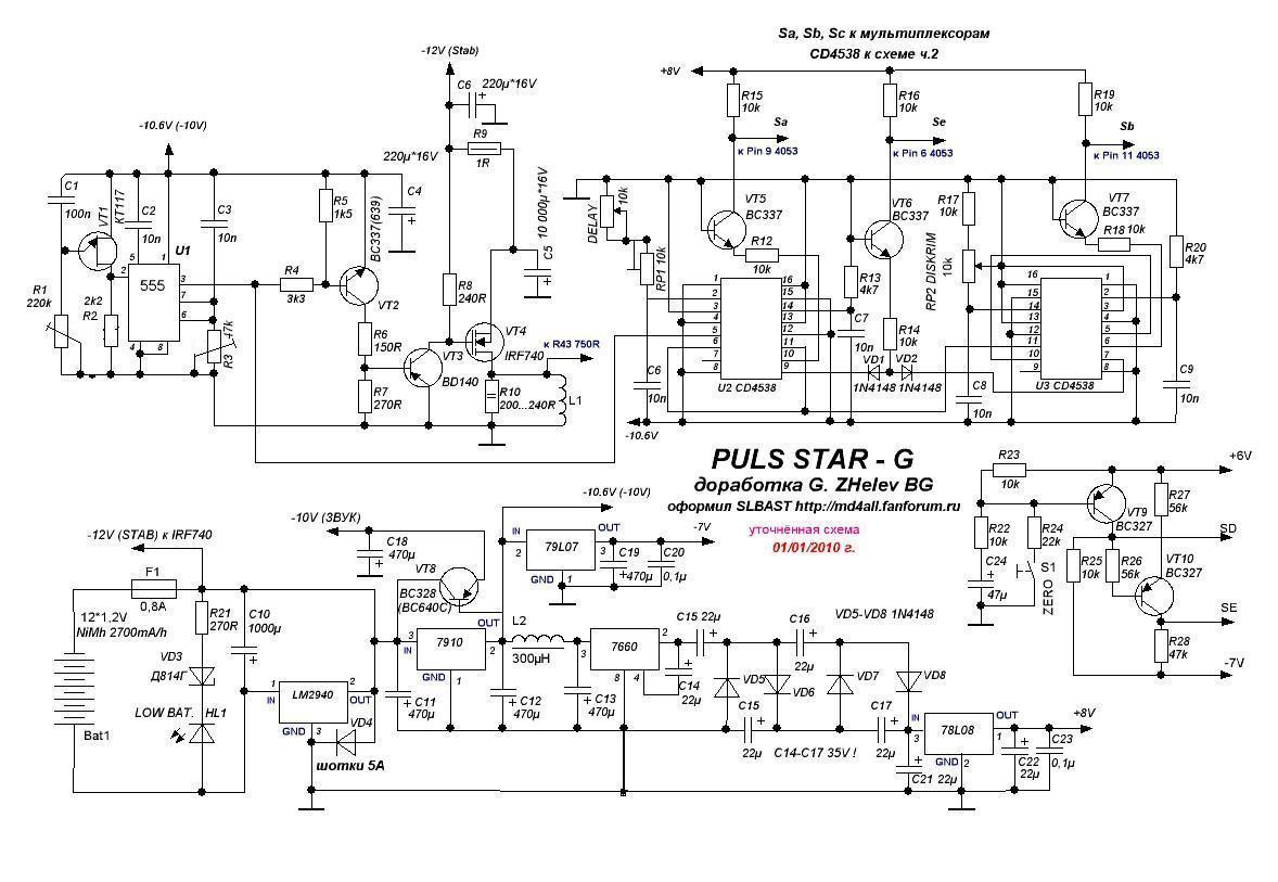

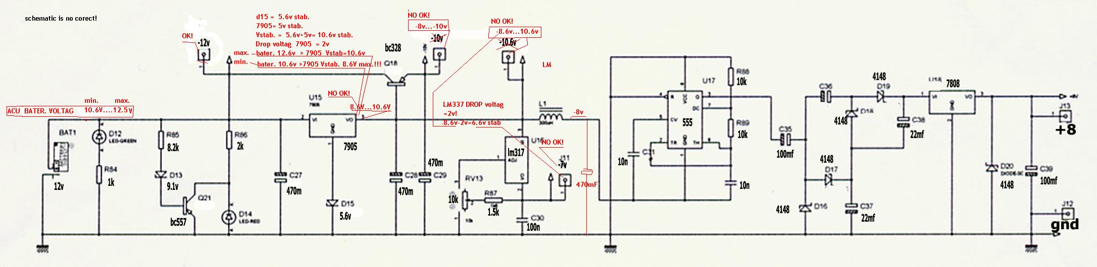

    Hi,dear mesyna! all resistors 68k 1% OK !!!
    voltag: +8v; -7v (or -8v); -10v; -10,6v; -12v
    SHEMATIC POWER SUPPLY IS NO CORECT !!!!
    • PS-G
      SCHEMATIC IS NO CORECT.THIS IS NO MY DISIGNE . MESYNA ,SORRY.

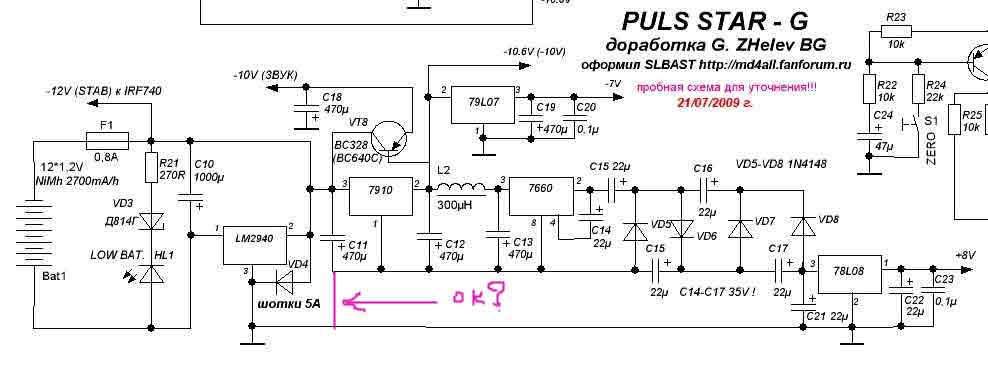

      • Hello Georgi.
        Today i just finish the power supply from your schematic it is ok ,i just have a detail see in red ...all the voltage are good
        Alexis.
        i put also a BC327 instead of BC328 , i think it is allright
        and a 79L06 with two diode to gnd for to have -7V and it is ok
        To morrow i populate the next one...
        • PULS STAR-G
          SCHEMATIC IS 100% CORECT!! copy O1 O1 2010г
          Hi,alexismes! Your shematik is old copy,error to SLBAST. ALL IS OK!!
          Good luck!

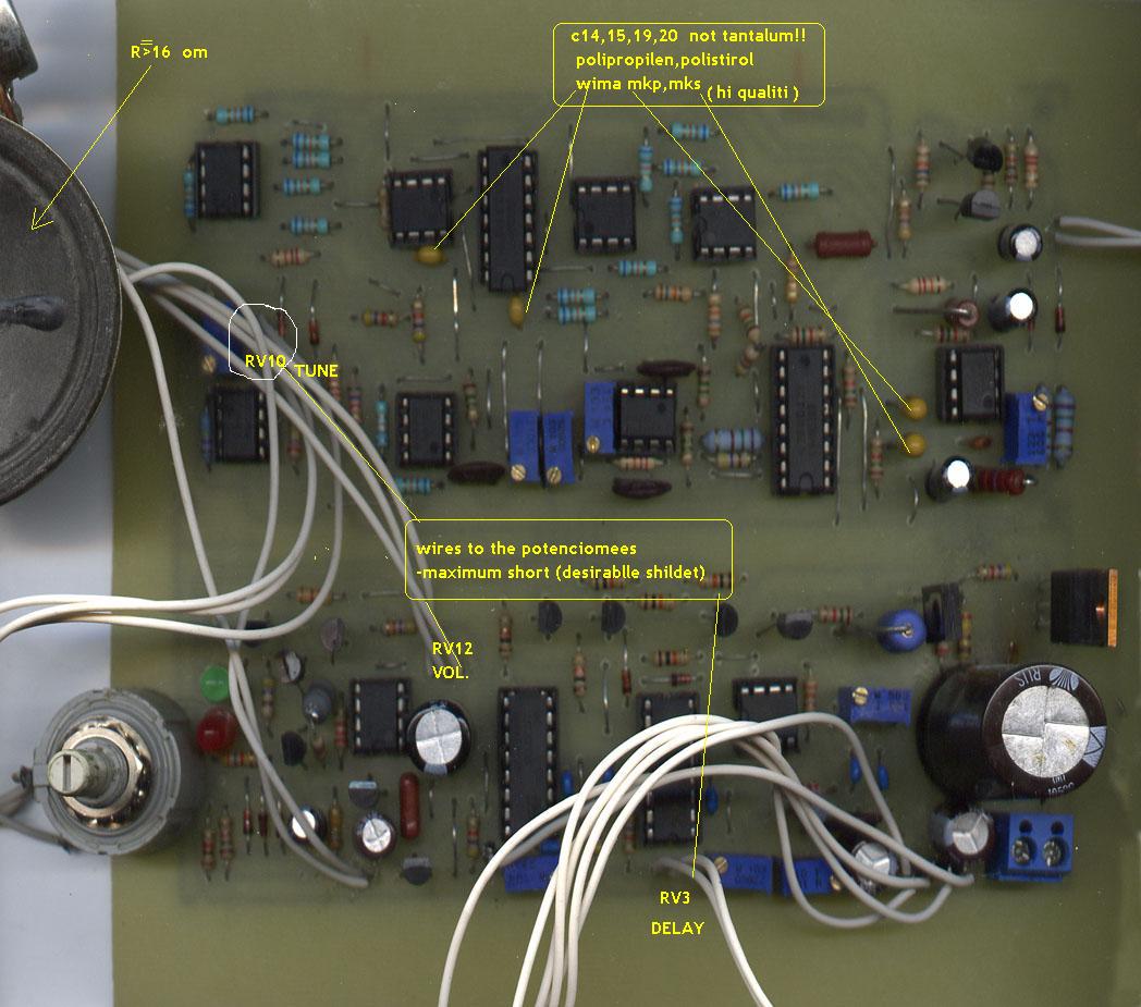

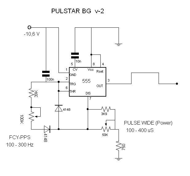

                      • Hello Georgi and friends,
                        Today i finished my second board (timing and front end...555 irf 740, 4538(2) and 4053...)
                        -First i changed to the second version for the 555 with the two diodes 4148...and i checked the timing for the frequencie pulse PPS and for the Pulse wide....after some adjust all is good and working.....
                        -Second i connect coil 300uH, solder the IRF 740 to check if it is ok ...ok good....no heat at all ...
                        -Third I insert in the socket the 4538's and check the oscilograms of Georgi and adjust the presets ...good also...
                        -Fourth i socket the 5534 and ckeck the output ...alwright ...good also , clean output (i adjust the preset to put zero ref )
                        -Fifth i socket the 4053 and check the output X, Y , Z
                        and it is good ....
                        Thank you Georgi for the first part , i beleive it is the more important part ..and it is ok ...
                        To morrow i will populated the amps boards and audio
                        I attach the version 2 , I have used for the 555
