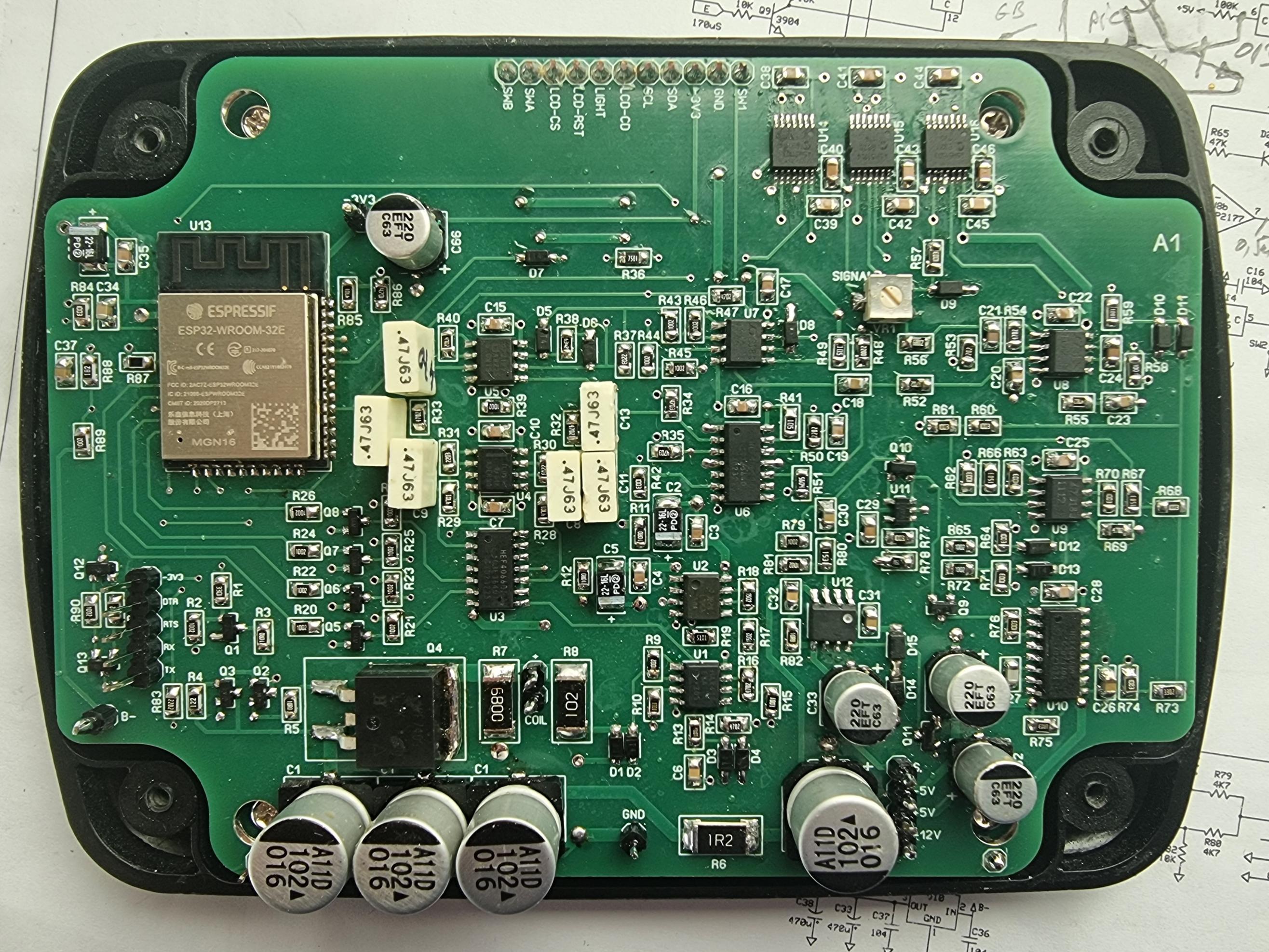

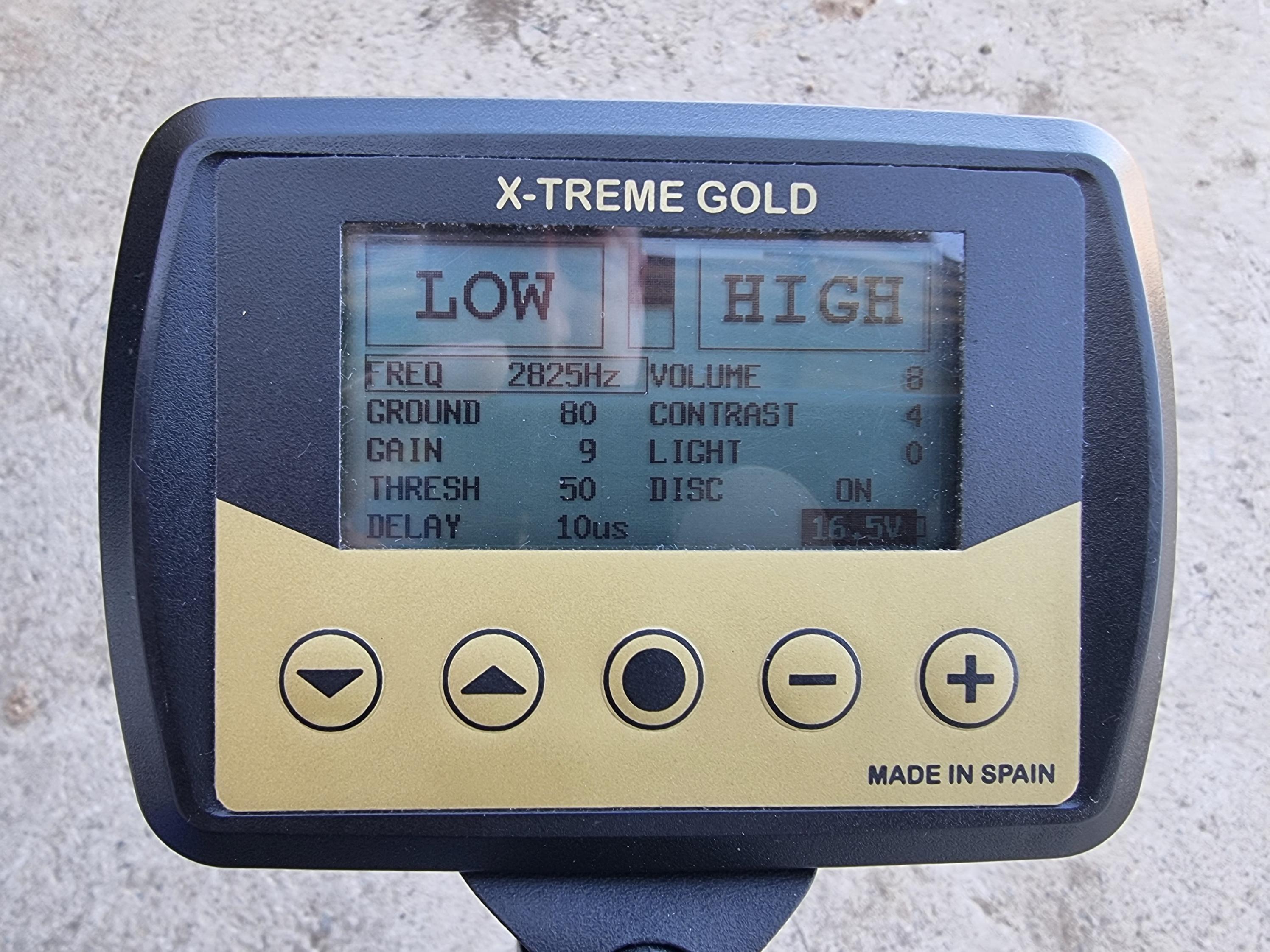

    Hello everyone.
    I have been working on this project for a long time and it is finally finished.
    At the moment it is not a commercial project and I don't know if it will ever be.
    For now I am doing tests and perhaps some improvements.
    The detector has an ESP32 and the software can be updated via WI-FI.
    I am attaching the photos and a video of the tests in my electronics workshop.
    https://www.youtube.com/watch?v=HvJYM3ztgm0
    Best regards,
    Eduardo​

                  I'm really impressed with the build quality!
                  For a "hobbyist" this is too good a job.
                  How did you make the enclosure? Mold casting or...?
                  Which LCD display is it? 128x64 but which controller?
                  Is it easy to get that display?
                  As far as detector performance is concerned, I am not competent enough to judge when it comes to "fast" PI detectors because I have not dealt with them the least so far.
                  But in layman's terms I can say that I really like the behavior.
                  In any case; I'm impressed!

                    The casing is actually two casings put together and trimmed so that the two form a single casing. The front cover is made of membrane sticker made here in Spain. The screen is an LCD type with 256x128 pixels. The rear casing is made of Hammond brand aluminum. The 16.8V/3400mAh Lithium batteries, the power supply, the speaker, the On-Off switch and the battery charging connectors and the headphone jack are housed there. The crutch is made of carbon fiber, it is the Goldenmask brand. The piece that joins the casing to the handle of the crutch is a piece designed by me in 3D and manufactured in a Spanish company with FDM printing technology. That's all for now.

                          Share the schematic so we can know a bit more about the unit.
                            Look good project Eduardo.
                            What type lcd you use?
