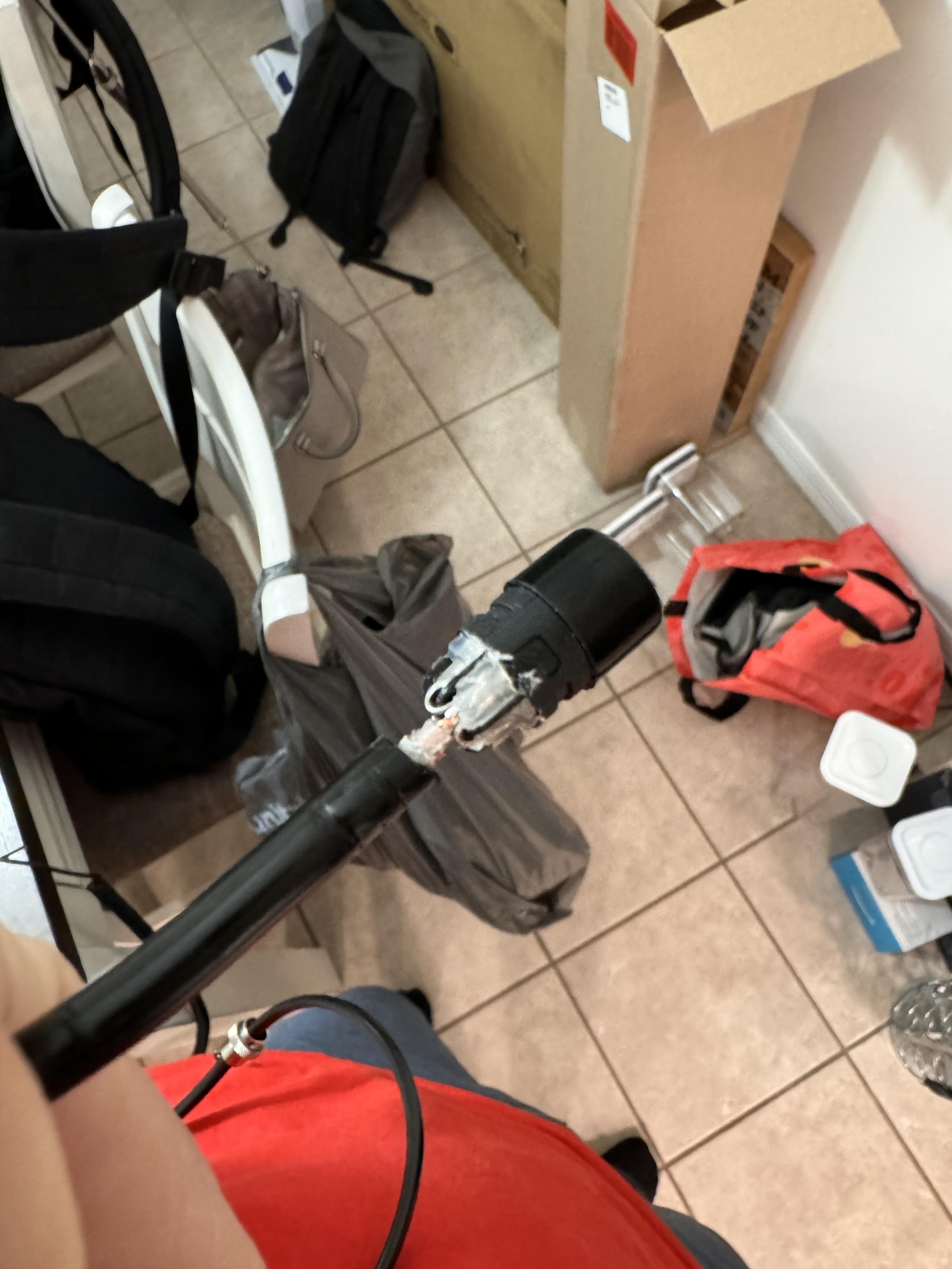

      I’m using a detech coil, 15x10 mono for the gp/gpx series if that matters. Ive got it wired according to the gpx coil diagram with a 5w 470ohm resistor. No coil connected in the picture above.

                I’ll check when I get home. I ended up unbridging the 5 pin connector, I connected 0v to pin 3, RX to 5 and Tx to 1 and that’s what got it to work. Before I had pins 1 and 2 connected and 3 and 4 connected. I tried both with and without the damping resistor and couldn’t tell a difference. this is the coil I’m using. It says it’s a mono loop but then I see it also says it’s a DD configuration.

                  I don't think that coil is a double-D. It's probably a mistake in the advertisement.
                  You could also try making a 300uH mono test coil with some hookup wire to check that the detector is working correctly.
                  After that you should then be able to figure out what's what with the Detech coil.

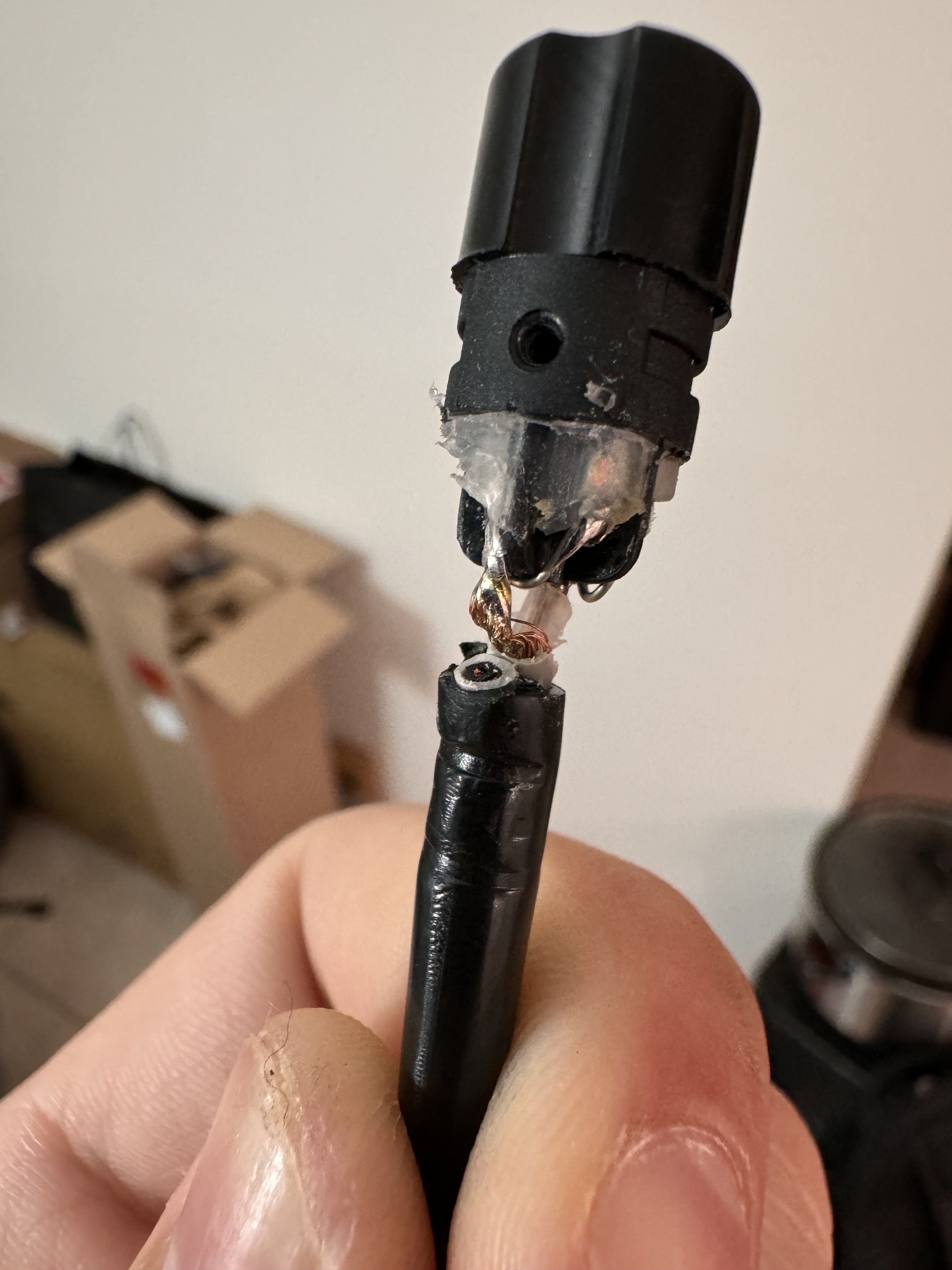

                    So everything checks out on the scope. I didn’t have a dampening resistor installed so I put one on pin 2 to 4 inside the detector. 3 to 0v 1 to tx and 5 to rx. Still something isn’t right. So I pulled all the glue off the plug on the coil to look at the wiring. 1 and 5 are connected but it looks like the drain wire and pin 2,3 and 4 are connected but it’s the insulated wire.
                      Tried hooking pin 1and2 together, and pin 3and 4 with resistor on 2 and 4 and I get no signals. Is that’s wiring diagram for a dd style minelab coil?
                        I don't have wiring details for a MInelab DD coil.
                        As I said previously, it would be a good idea to make up a simple mono coil with hook-up wire to test that the detector is working correctly. After that you may be able to figure out how to connect the DD coil.
                          I agree, simplify the task to one problem at a time.
                            I was hesitant to make a coil as I wanted to use an off the shelf option. But I think you guys are correct, I’ve ordered the material to make a coil and I will report back with my findings.
