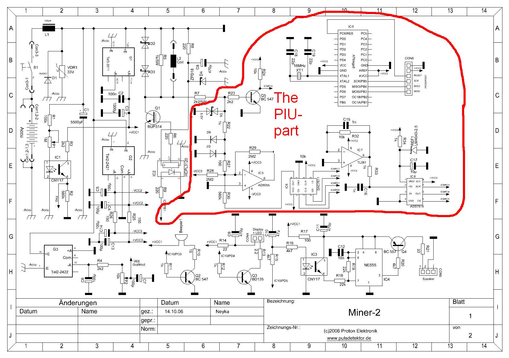

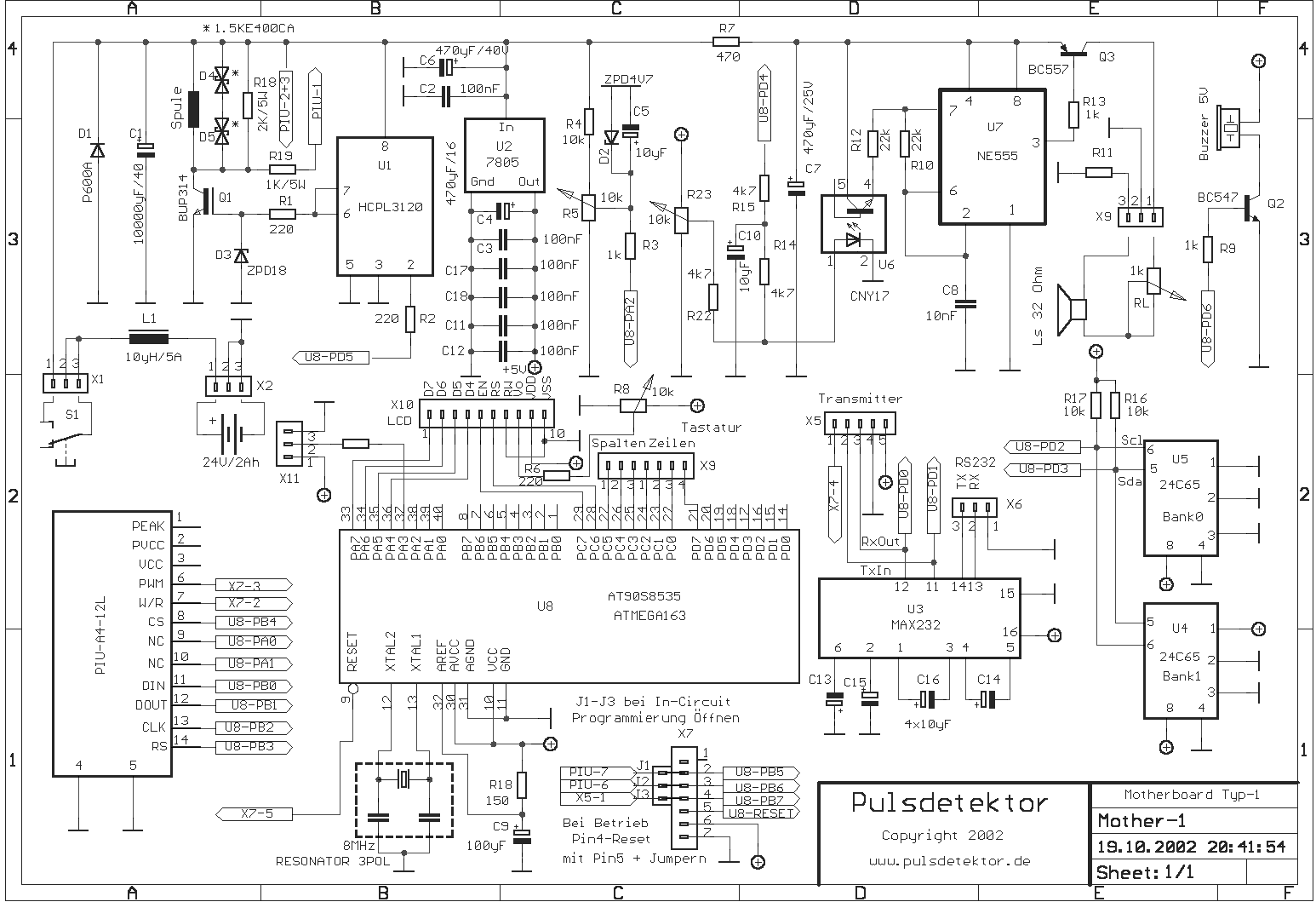

    Hi. Yesterday i saw a schematic for a PI detector that use the PIU-A4-12L.
    I can't find any details about it
    Can anybody help me???
    PIU-A4-12L
    Geo , Pulse isolation Unit , Here is a old copy of schematic that was public posted for a couple of years on www.pulsdetektor.de . I have much more but i can only email to you. I can not post here . Bye Eugene

      I saw the same schematic for Digger. So do you know anything about the PIU-A4_.....
        Pulsdetektor
        Hi Geo,
        I have read your questions about the tiny-project in the
        pulsdetektor-forum, Im sorry, that I could not help you, but I havent built this.
        You don't need a PIU, if you want to built one the new projects fom this site,
        like the Miner-1-4.
        The Miner-projects are have the same features like the old Digger-Projekt.
        Best regards
        Norman
          PIU-A4-12L
          Geo , Here is a good pdf file to Read. for now . Bye Eugene

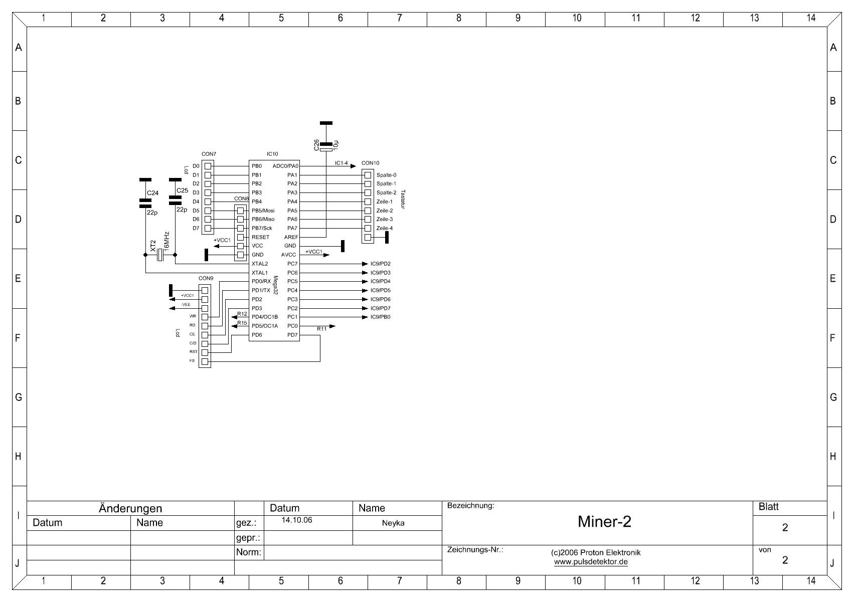

                          here are the circuit from the Miner-2
