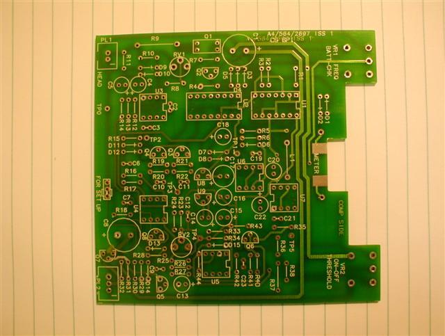

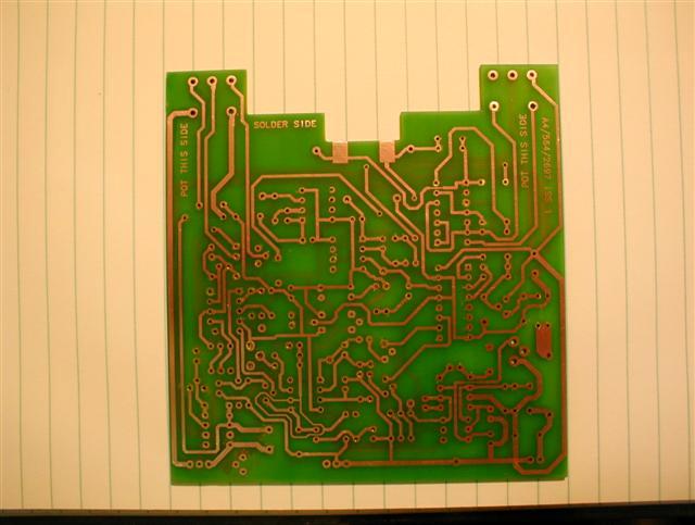

                              Hi again all,
                              Have been busy while waiting to order my oscilloscope ready to try out the mod’s posted by bbsailor and Simonbaker above.
                              It seems there is a bit of interest lately on the forum regarding this detector with a few fresh posts and topics started.
                              By the way, I hope I am not hijacking this thread by posting here instead of starting a new one, if so please let me know.
                              I stripped the components from the pcb to take a couple of photographs of it for the benefit of the forum.
                              Also have been trying out my new pcb software, redrawing the board to post here as well. I have checked, double checked, and checked again the track connections, component layout etc. but as I am a novice at this I would appreciate any comments on my redrawn layout.
                              Yes bbsailor, on your advice above I have started to study Carl’s Hammerhead project and article and I do see the similar nature of both machines. It is a very good read and quite involved really, there are a lot of posts regarding it to go through and take in.
                              Anyways, here are the attached files all, so now I have to put it all back together ready for when I get my scope.
