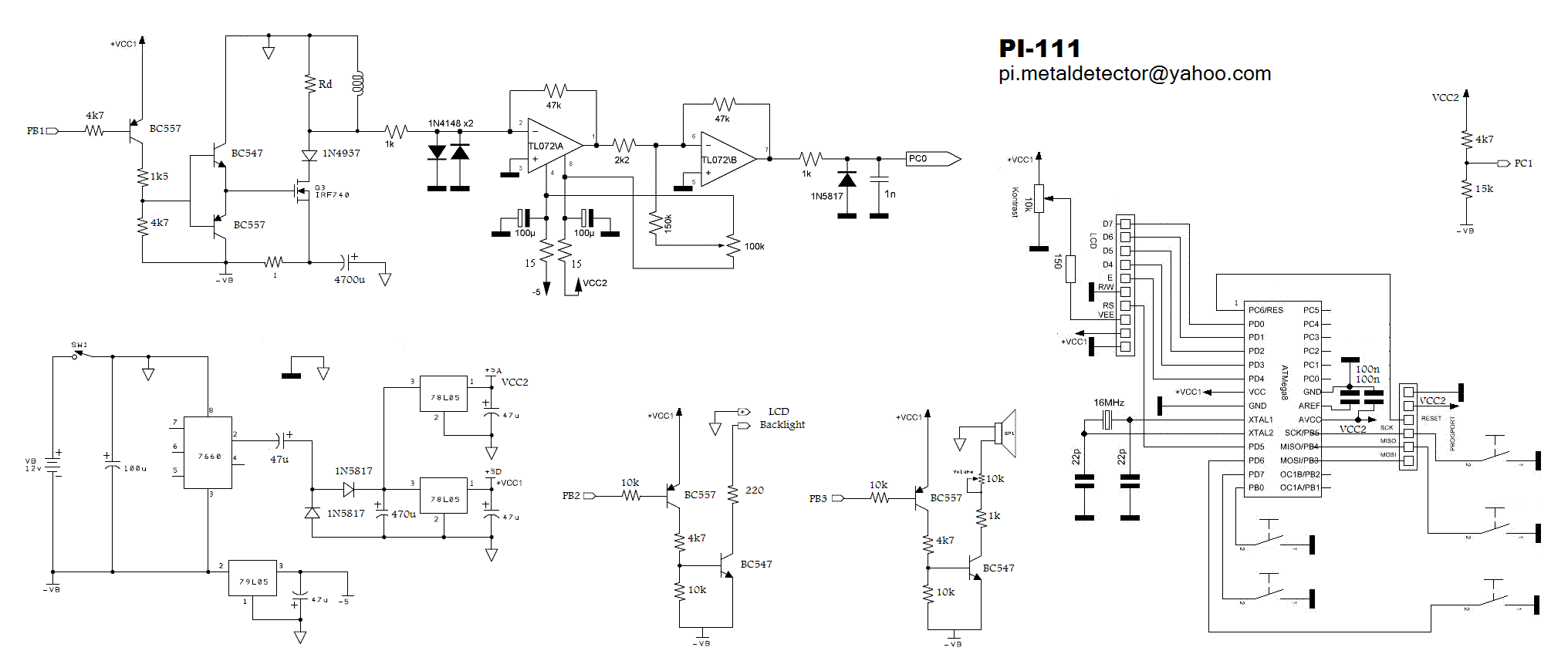

              I suggest using a 2-stage preamp to get faster settling. Also a diode on the FB resistor can help. Finally, use a more generic offset adjustment (like Hammerhead) so you can try out other opamps.
              Might want to sync the 7660 off the micro.
              - Carl
                A 2-stage preamp is a good idea... I gonna use a TL072.
                Best regards,
                1843

                      New Schematic
                      Hi, Here's the new schematic:
                      Thanks to Carl for his suggests. Now the PI's components are even easier to get!
                      Best regards,
                      1843
                      • #41
                        TL072 probably isn't fast enough... use a NE5532 or two 5534's.
                        • #42
                          Would it be TL072 or NE5532 finally!?
                          Please establish final schematic and i will be glad to try to draw pcb for it.
