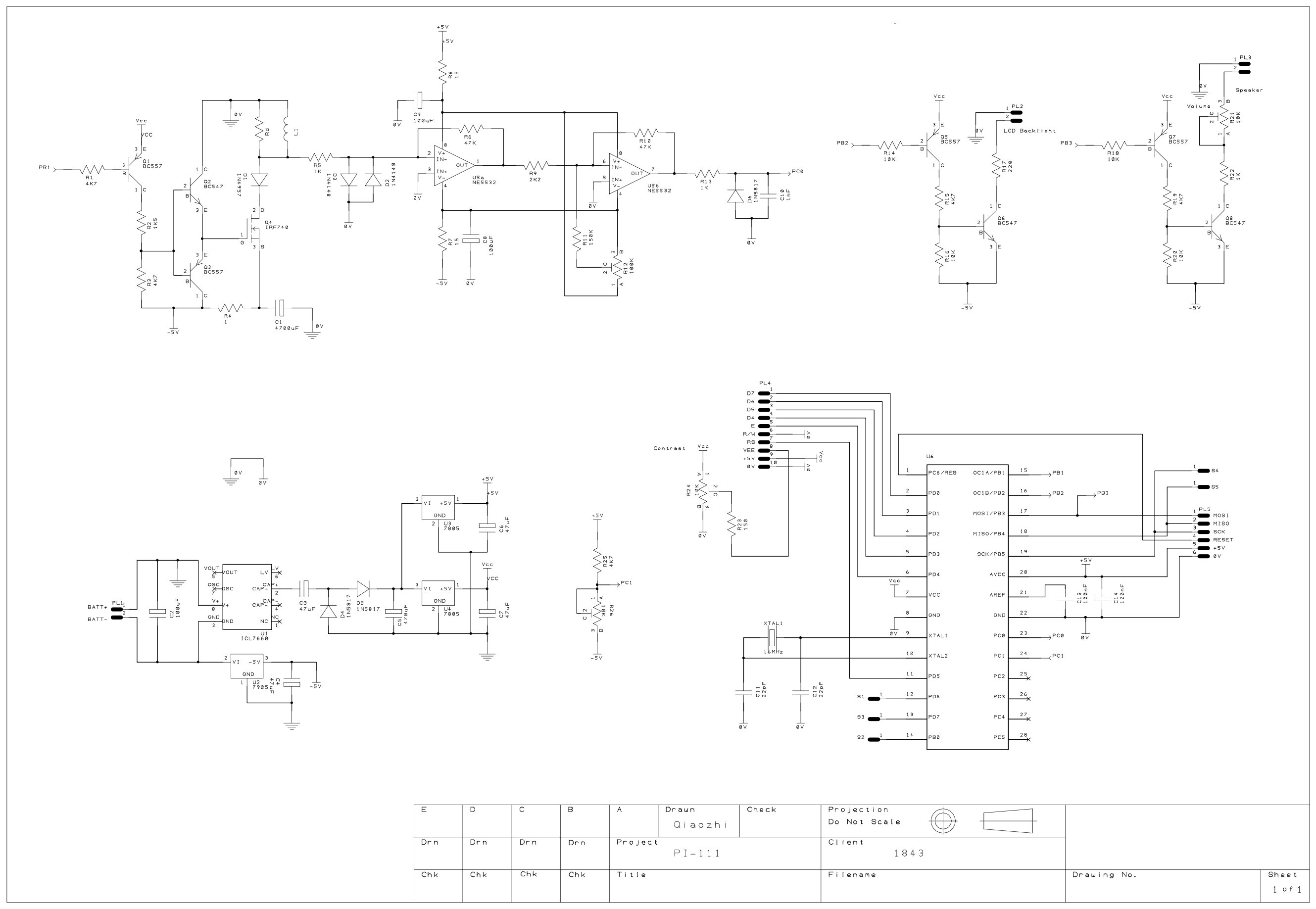

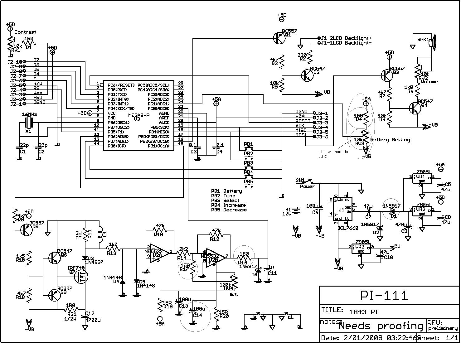

      • #78
        porkluvr,
        Thanks a lot for the schematic.
        There are some errors in the schmatic:
        Best regards,
        1843

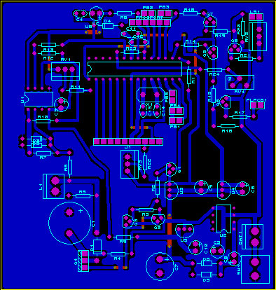

          Thanks to Ivconic and Barry for their nice layouts.
          Best regards,
          1843

              • #82
                Hello,
                to get rid of of the "noise", you have to "correlate" it. Everything, that is deterministic and predictable, that can be eliminated. This counts also to the phase of the disturbing source. "True uncorrelated" noise can not be. Only the band limitting can help in this case (filtering).
                One of the biggest noise sources of the design is the 7660. It is not synchronized to the processing element. The ATmega8's PWM output should synchronize the 7660.
                Next is the ATmega8 itself, but as long as the code is deterministic on every cycle, this can be correlated and eliminated therefore. Some caution to code branches must be made. So that the branch and the not taken branch should take same time period.
                Other noise sources can be the audio part (on target presence) and 50/60 Hz mains hum. As 1843 low passes the amplified signal before digitizing, he eliminates lots of noises. A typical averaging of the signal which achieves obviously good results even the ADC resolution isn't big enough. The other fact is filtering the power supply of the pre-amps (op-amps).
                1843 gave you all a possible way of using the micros internal ADC again. But one sample on every cycle wouldn't be enough and you have to take a moving average of the ADC samples (like boxcar integrators).
                You may ask yourself and think of a bit, why I am investing so much effort in synchronisation of all the parts. The answer is simple: "correlating possible noise sources".
                Aziz

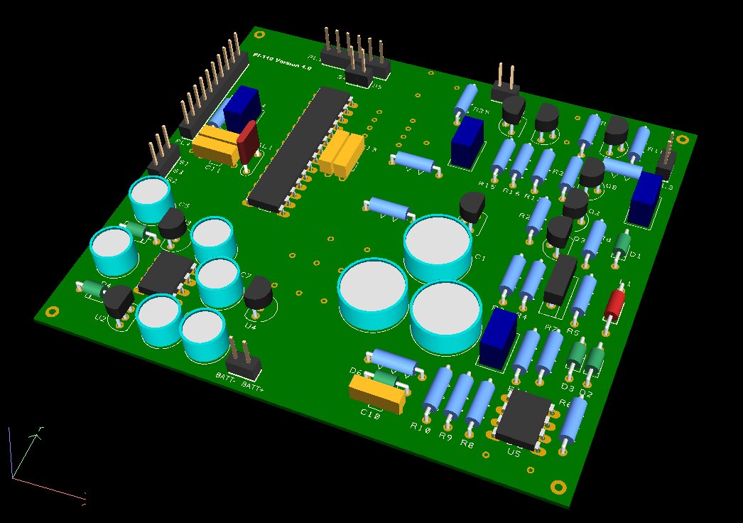

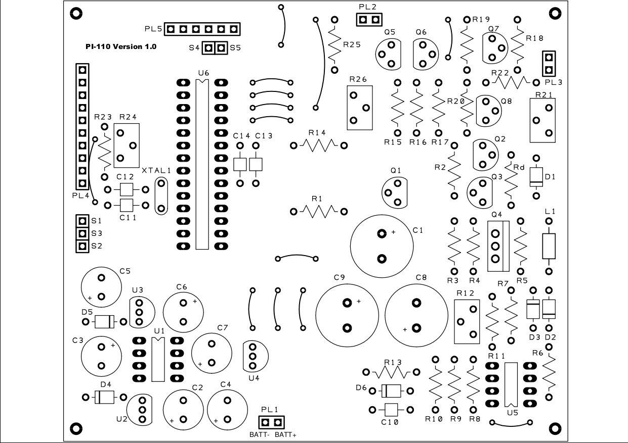

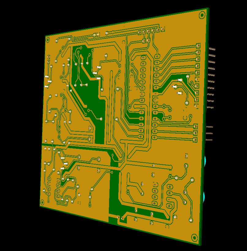

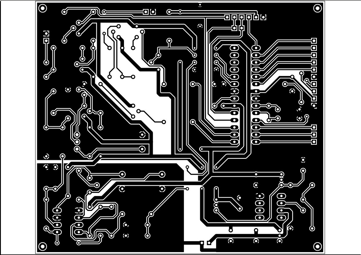

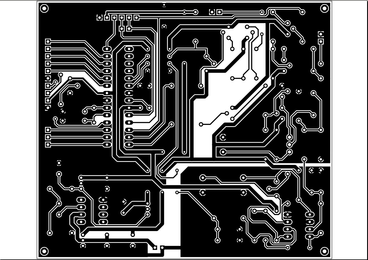

                        • #87
                          Try this ->
                          Hi 1843,
                          Let me know if this is what you're looking for?
                          There may be errors, so please check. The usual caveats apply.
                          • #88
                            Hi Qiaozhi,
                            Your PCB layout really skyrockets my motivation for development the software!
                            There are some minor errors... please see your inbox.
                            Thank you very much!
                            1843
                            • #89
                              Hi ,
                              is this design's TX-off fast enought to get early samples for discrimination tests.
                              what is teorical value?
                              • #90
                                Hi Qiaozhi,
                                Nice work, I'm thinking the pot R26 and volatge into PC1 is going to be a problem as voltage top/bottom is +5/-5....
                                What PCB application do you use just as a matter of interest?
                                Cheers
                                Muntari
