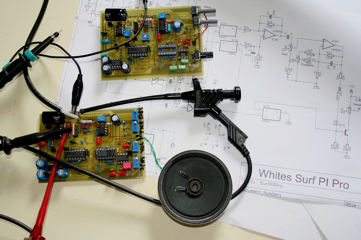

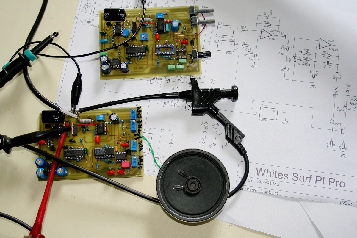

  • Originally posted by ApBerg View Post
    UFO:
    Actually the longboard is cool for putting into tubes etc, but I was surprised that there was not the regular shaped board as well.
    ... made some 'normal' board in Sprint Layout ...the last after Carl gave the Whites Surf Pro schematic on this board.
    Have not made it for real, only as pcb Sprint file, so there can be errors in it !! The potentiometers can work inverse.. there is a extra potentiometer near the 555 and a extra preset delay
    If somebody can check it.. ?
    Best regards
    Ap
    Made 2 different layouts from the Surf PiPro, not bad detectors...
    In the SprintLayout JPG the pins 4093 8/9 chanced place ! ( post no. 188 ) Not ok. but the detector worked !?
    I think the Barracuda is the better DIY project...!

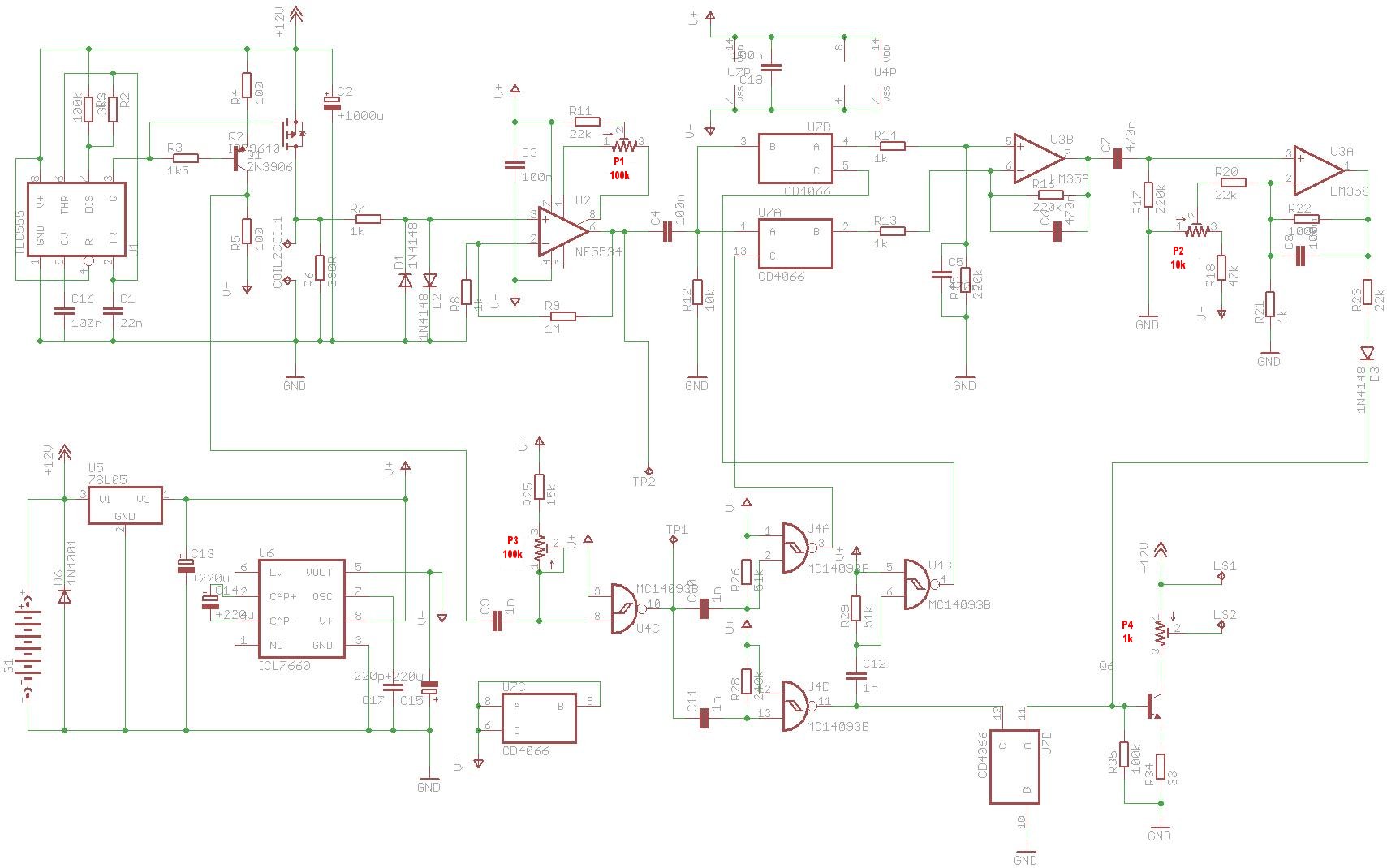

          Dear ApBerg,
          On your photo (post #196) I can see a part of new Surf PI schematic.
          I have noticed SIGNIFICANT difference in resistors and capacitors values
          between the old version of Surf PI (Longboard) and this new version.
          As I can see new version has to be much more sensitive.
          R22 old version 100K new version 220K --- Gain increase
          C6 old version 100n new version 47n --- to keep the same time constant
          R20 old version 22K new version 47K --- Gain increase
          Also on layout in your post #188 I can see different values RC for integrator
          C5,R15,C6,R16 changed from 220K, 470N to 330K, 330N to increase Gain
          but no such changes on last photo (post #196).
          Can you please let us see whole schematic of this new version.
          I think Longboard owners can just upgrade their detectors to new version by changing
          some resistors and capacitors and adding sensitivity pot.
          I would like to upgrade my detectors too.
          Probably Silverdog can upgrade his Longboard kits for this new more sensitive version
          without actually changing layout.
          NEW AND OLD SCHEMATICS. COMPARE IT:

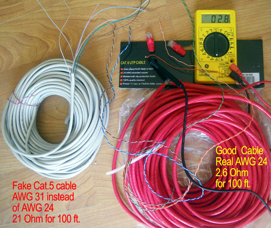

          • Best wire to make a Surf PI coil is wire from CAT.6 UTP Network Cable (24 AWG Stranded)
            You can buy 100 ft. CAT.6 UTP Network Cable on eBay for $12-$16
            then remove wires from the cable and untwist twisted pairs.
            You will have 8 pieces of 24 AWG wire 100 ft. each.
            1. 24 AWG is an original wire size for Surf PI (0.51 mm)
            2. Stranded wire will reduce eddy currents inside the wire and make your coil "fast".
            3. PVC insulation will reduce coil capacitance make your coil "fast" and improve insulation of high voltage impulses.
            4. PVC insulation in network cables is relatively thin so your coil will not be too bulky.
            5. Saving money is OUTSTANDING !!! For $16 you will have 8 pieces of 24 AWG wire 100 ft. each.
            Usually you need 55-60 ft. of wire to make 1 coil. So you can make 8 coils (and spend $2 per coil)
            WARNING: Always check what you want to buy. Many China companies stealing cooper from cables
            and using thin wires instead of AWG 24 even if you can see it marked as AWG 24.
            To be sure that wires are good do not buy cheapest cables, ask seller about quality.
            Also you can check resistance of the cable. It has to be 2.6 Ohm for 100 ft.
            weight of 100 ft. Cat.6 network cable with proper wires is approx. 2.6 pounds because cooper is heavy. Light weght cables are fake.
            Once I have purchased fake Cat.5 cable for $8 on eBay. (LEFT ON PICTURE)
            Wires were approx. AWG 31 instead of AWG 24 and even not twisted pairs. resistance was 21 Ohm. Avoid to buy such fake.
            Link-depot CAT.6 cable I have purchased for $16 was ABCOLUTELLY PERFECT (right on picture)
            http://www.ebay.com/itm/120872033740

              That looks like 8 core alarm cable on the left about third of the price if not less
              • Probably they put RG45 network connectors on 8-core alarm cables then sell it as Cat.5.
                Network cables. Never tested it in my home network. Do not expect it will work good even for network connection.
