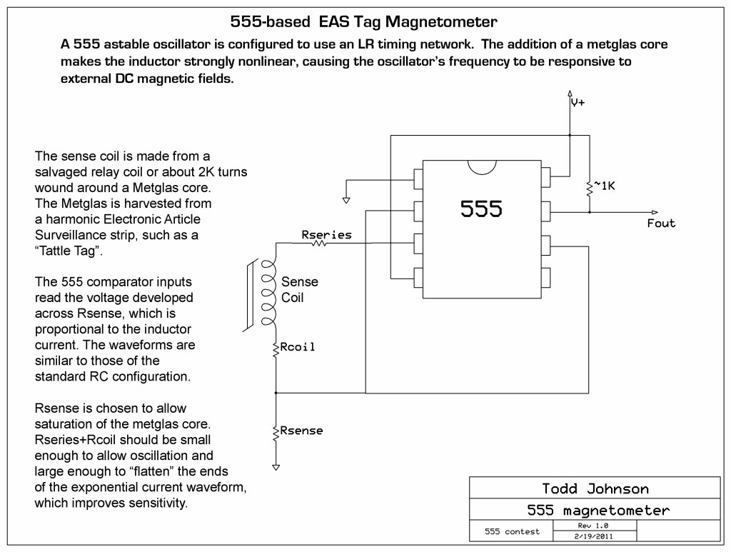

              • Discrimination of ferrous targets in PI detector.
                OK. Here some useful info.
                Quote:
                "SSP-2010. This is an unique system, combining PI detector and magnetometer, allowing the discrimination of the unwanted ferrous objects no matter their size and ageing in the ground."
                "Detech Ltd is the first company in the world, applying search coil with built in magnetic sensors in the middle sector. This allows perfect discrimination of the ferrous objects by the PI detectors."
                http://www.detech-metaldetectors.com/about-us.html

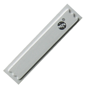

                So I have found easy to build magnetometer on 555 timer.
                To build one you have to find magnetic security strip
                http://www.ebay.com/sch/i.html?_nkw=...ic+Ultra+Strip
                in one of your books, drugs or electronic goods. Remove Metglas strip
                from it and use it as a core for your magnetometer coil.
                (there is 2-3 strips inside the tag but only one is Metglas, others are magnets)
                I did not tried it yet but it looks very promising.

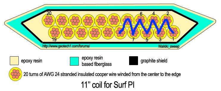

                  Should I wind my coil in a flat possition like the one on the picture or it doesn't matter?
                  • Coil for Surf PI

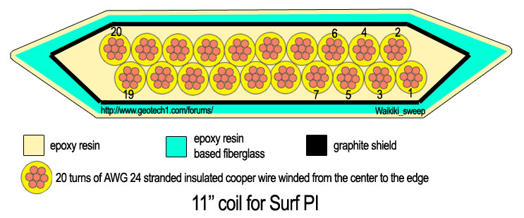

                    In my beliefs it is the best shape for PI coil to search in water.
                    • How did you physically hold the wire while you wound the coil so you could get the zig zag pattern ?
                        To make such coil you need that tool for winding spiral coils (two plates with spacer between) but you have to make spacer a little bit thicker.
                        Let say 1.7 of wire diameter. Sure you will not have ideal zigzag but something very close to it.
