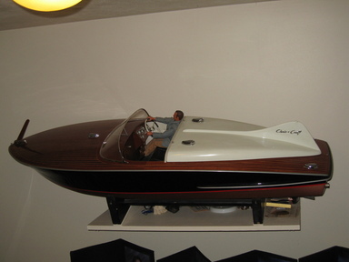

                Funny u mentioned remote controlled boats. When my uncle Frank passed. My Aunt gifted me one of his boats. She's a beauty. It's a CrisCraft speedboat from the 50's It's 58 inches long with a gas engine and 2 props. Unfortunately I never saw it running.

                  Very nicely built Cobra. Those larger gas burners are sure show stoppers.
                  I tried to get a RC race gas class of Classic Mahogany runabouts started at one point,
                  but, the cost was out of reach for many as the boats would have to be custom built.
                  So the Crackerbox class was developed. I helped establish this class thruout the US back in the early 90's. We had Thursday night Crackerbox races with revolving trophies. THey were a blast to drive, you actually had to drive them, come into a corner too fast, catch some air over a wave and your airborne....challenge to keep them on the water. Watch the second video and you'll see what I mean.
