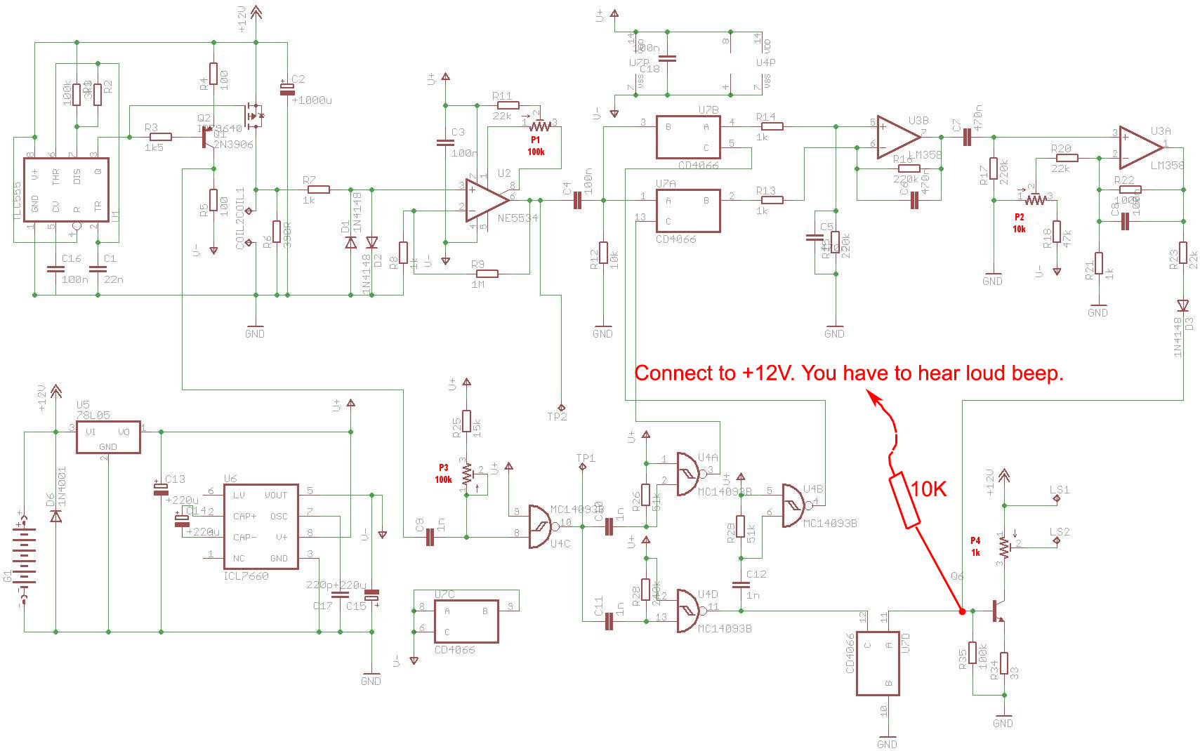

  • Check power consumption it has to be 55-75mA.
    Get a $0.25 coin and check a voltage changes if you put it on coil
    Output of Preamplifier NE5534 PIN 6 (for my machine output -0.1V change for a quarter ($0.25) and -0.5V change for a pliers if I put it straight on the coil.)
    Output of Intergator LM358 PIN 7 (GO HIGH from 1-2V to 3.75V)
    Output of LP filter LM358 PIN 1 (VOLTAGE JUMPING UP DOWN)

    Couple years ago I remember that was a mistake in resistors numbering so 22K and 100K (or so) were switched near sound amplifier and sound was low. Check is PCB matching to schematic for R18,R20,R22,R23.
    • All the resistors, diodes, capacitors etc all check out ok and all the soldered joints are clean and electrically isolated where they should be.
      Although when I was taking the voltages on IC 7660, I did bridge the heatsink on Q2 and the small link adjacent R16 with my fingers and the feeble squeak on the speaker went to (well almost) a deafening roar. This "roar" then responded to the volume control exactly as I would have expected the volume control to work. Sound up and down when the knob was twiddled back and forth. Is this indicative of something misplaced or just a quirk of the board?
