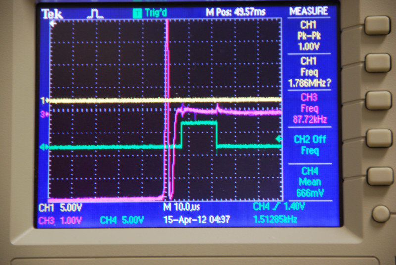

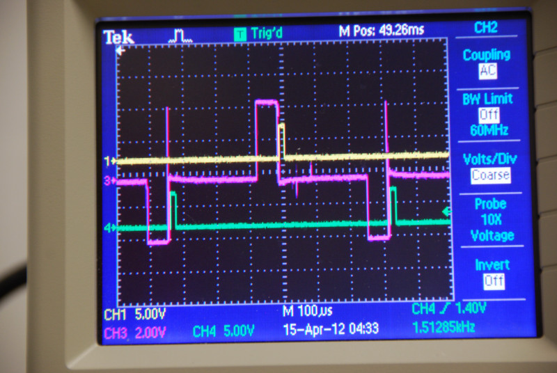

            Here is a scope shot of one I been playing with
            sampling at 8us, preamp output
