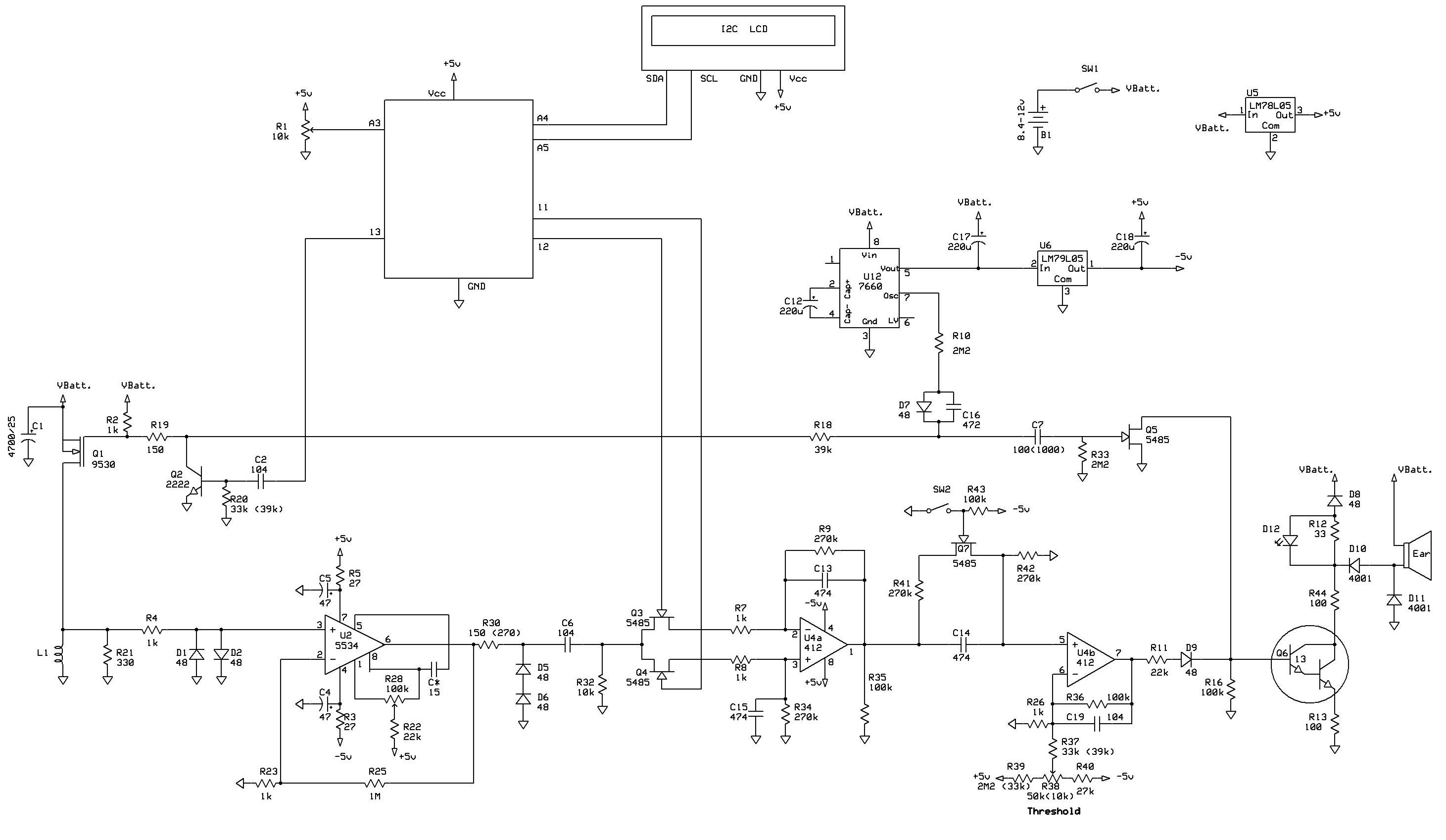

    This is the supporting circuit, explaining the code:
      Pay attention on this: "LiquidCrystal_I2C lcd(0x27, 2, 1, 0, 4, 5, 6, 7, 3, POSITIVE);"
      And the value "0x27".
      It is the address of adapter used to drive parallel LCD16x2 via I2C.
      Not all similar adapters are having the same address.
      You'll have to find out the proper address of I2C adapter you'll use.

        Nice but What Processor???
        The processor block in the schematic is blank.
        I used a PIC16F88 for my Hammer Head which does what yours does.
        A processor is a great way to go for PI detectors instead of all the timer chips and allows easy changes to timing.
          Atmega328P. Pinout is for Arduino UNO, Mini Pro, Nano...
          Arduino IDE is the compiler.
            Output Transister a MPSA 13 ?
              I believe so. I had MPSA14 at the time.
              BC517 will do the same.

                  "...value = analogRead(A0);..."
                  And on schematic is A3 used for pot reading.
                  So...
                  Correct in code:
                  value = analogRead(A3);..."
                  Reason for this is because i had "trillion" of versions on each of my works i did so far.
                  Sometimes you learn through the work. Sometimes you make skim decisions and later you forgot to correct in documentation.
                  But it is not a problem at all. Everything is later easy to adjust in code.
