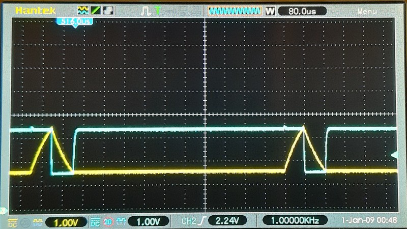

    The analog comparators in popular AVR controllers Atmega328P, Attyin85 etc. don't have any hysteresis which makes them quite useless (bouncing output on slow/noisy signals).
    The solution I present here uses a few external resistors and a simple interrupt routine. No RAM is used and the overhead is negligible if the assembler ISR is used.
    The exmple code implements a relaxation oscillator experiment that can be set up very quickly.
    Arduino IDE instructions:
    - create a new sketch.
    - delete all the text in (sketch name).ino
    - Click the tree dots (top right) and then on "New File"
    - Name the file as "main.c" and paste the code listed below.

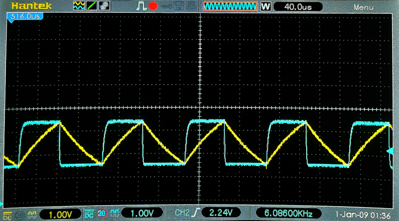

    Brief explanation: The comparator interrupt is enabled on both edges (toggle). The interrupt handler sends the comparator state to pin PB0 as either a low level (comp. low) or a high impedance level (comp. high). This output is connected to the comparator "-" input (AIN0 - pin 6) via a resistive feedback network. The signal (a charging/discharging capacitor in this case) is fed to the comparator "+" input (AIN1 - pin 7).

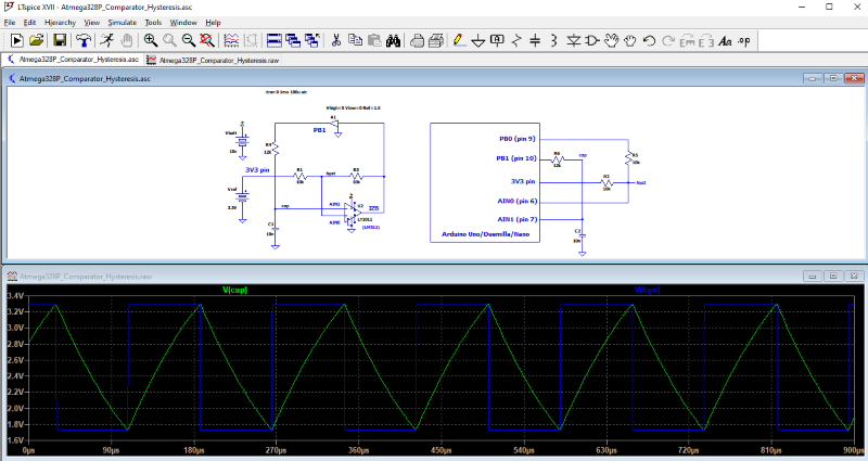

    The attached LTSpice file contains the equivalent electronic circuit using an open collector/drain comparator such as the LM311. The schematic of an Arduino setup is in the same file.
    I'm using this technique to design a minimalistic PI that I will be disclosing in further posts.
    Atmega328P_Comparator_Hysteresis.zip
    Click image for larger version  Name:	hysteresis_setup.png Views:	0 Size:	82.8 KB ID:	418106
    Click image for larger version  Name:	scope.png Views:	0 Size:	386.7 KB ID:	418105

    In this second experiment the charge in the capacitor will be held for a period of time at the lower threshold of the comparator.
    The code uses Timer1 to release the capacitor from the hold state every millisecond.

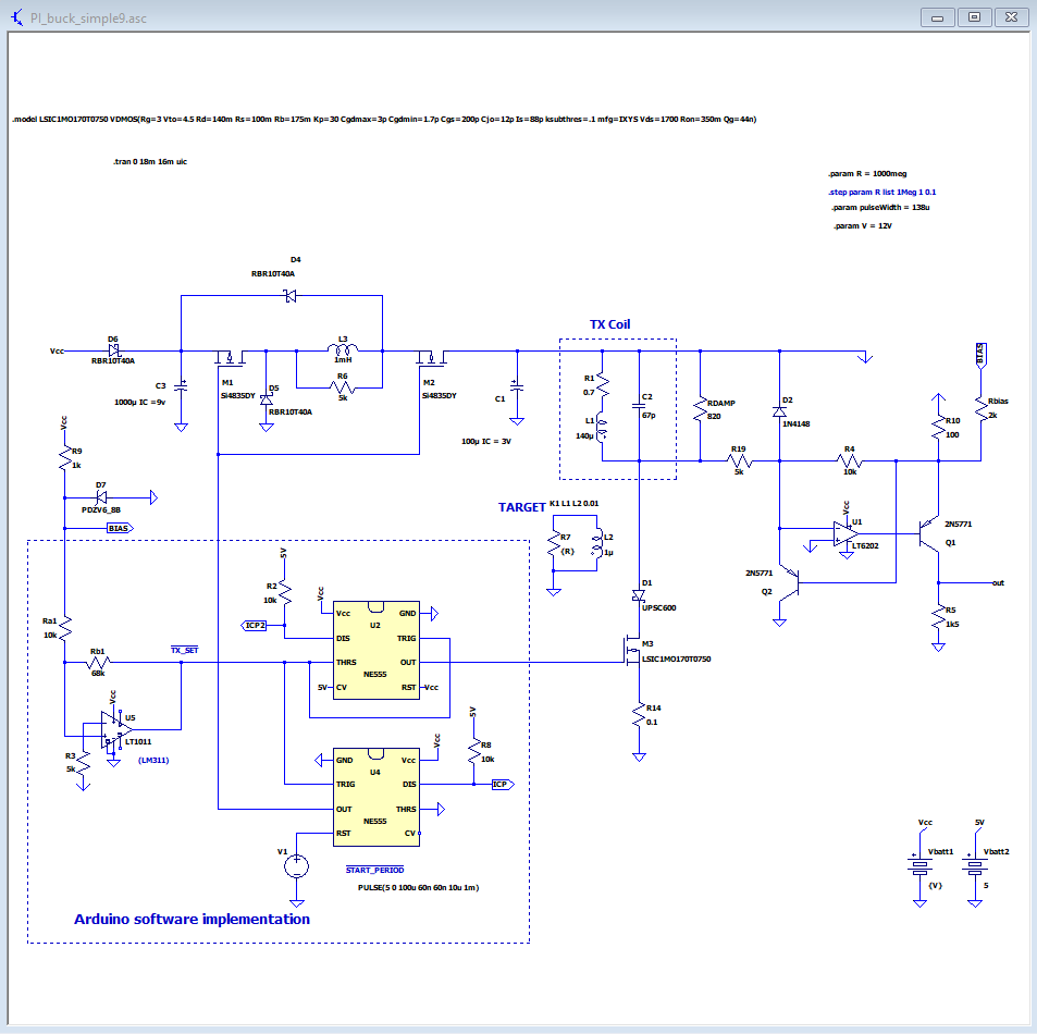

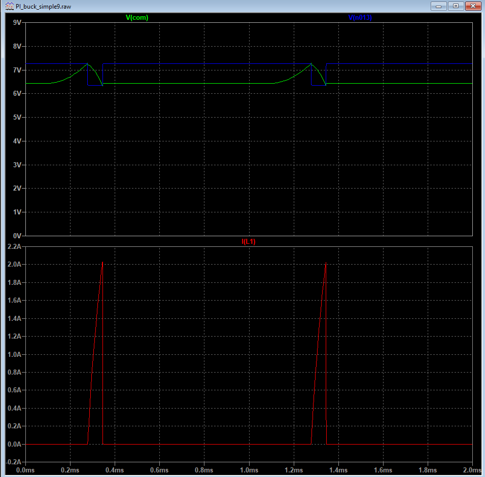

          Here's the schematic of the PI driver and preamp that motivated this work.
          C1 is charged to a given voltage through a buck converter for efficiency, then discharged to a second lower voltage through the TX coil, then put on hold.
          Ths hold voltage provides the analog reference for the preamp.
          The amplified signal is then referred to ground before being passed to the ADC fo an Arduino board.
          Gain is low, around 30, for direct sampling.
          The driving logic is to be replaced by the internal comparator of an Atmega328P (Arduino Uno/Micro) and associated code.
          By looking at V(com) in the plot you will immedialtely understand the relationship with the two experiments above.
          Click image for larger version  Name:	PI_buck_schematic.png Views:	0 Size:	47.8 KB ID:	418146
          Click image for larger version  Name:	PI_buck_plot.png Views:	0 Size:	30.2 KB ID:	418148

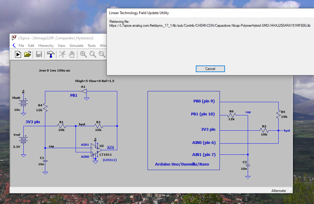

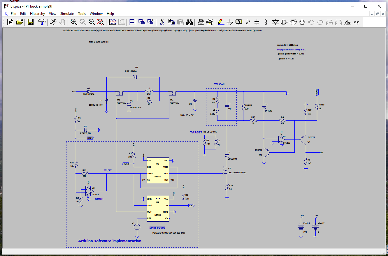

            When I try to open the simulation in LTSpice it fails with a DDE error, and a whole bunch of missing files. I'm not sure what these are, but they might be Visual Basic or Javascript.
            Is this because I'm trying to open this in LInux, or are there some files not included in the zip?
              Must be the Linux, it opens up fine for me (Win10).
              I just installed the latest Ltspice version and it opens up fine.
              (boring update in progress though)
                What about the simulation file in post #5, does it open?
                  Opens up here too:
                    OK - I've discovered the problem.
                    If you right-click on the asc file and send it to LTSpice, you get a DDE failure; but if you select the asc file from within LTSpice then everything works as expected.

                      void measure_timing(){
                      // PB1 = OC1A = Arduino Pin 9 as outputs the trigger signal
                      DDRB |= (<< PB1);
                      // PB0 is used as the comparator output.
                          // Open collector output is simulated as follows:
                          //  - write port bit to 0 permanently
                          //  - output low: conf. pin as output DDRB |= (1 << PB0)
                          //  - output high impedance: conf.pin as input DDRB | ~(1 << PB0)
                      PORTB &= ~(<< PB0) ;
                      //Connect comparator output to capture input of Timer1
                      ACSR |= (<< ACIC);
                      DIDR1 | (<< AIN1D) | (<< AIN0D); // disable digital on comp. inputs
                      ACSR |= (<< ACI); // clear interrupt flag
                      ACSR |= (<< ACIE); //interrupt enable (on toggle by default)
                          // Timer 1, CTC mode, OCR1A controls resolution
                      TCCR1B |= (<< WGM12);
                      // set the TOP value
                      OCR1A =  TIMER1_RESOLUTION;
                      //enable interrupt at OC1A compare match
                      TIMSK1 |= (<< OCIE1A);
                      TIFR1 |= (<< OCF1A); // clear compare flag
                          // start timer 1 no prescaling
                      TCCR1B |= (<< CS10);
                      void apply_timing(){

                      ISR(ANALOG_COMP_vect) {
                      // Send comp output to PB0 as open collector signal
                      if (COMP_OUTPUT_LOW) {
                      STATE_OUTPUT_LOW;
                      comp_fallingEdge ICR1;
                      TCCR1B |= (<< ICES1);     // prepare Tim1 capture on positive edge
                          else {
                      STATE_HIGH_IMPEDANCE;
                      comp_risingEdge ICR1;
                      TCCR1B &= ~(<< ICES1);     // prepare Tim1 capture on negative edge
                      edgesReady true;
                            Click image for larger version  Name:	image.png Views:	37 Size:	275.3 KB ID:	418151
                            Errata:
                            These connections in the schematic are wrong
                            PB0 should be pin 8 (not pin 9)
                            PB1 should be pin 9 (not pin 10)
