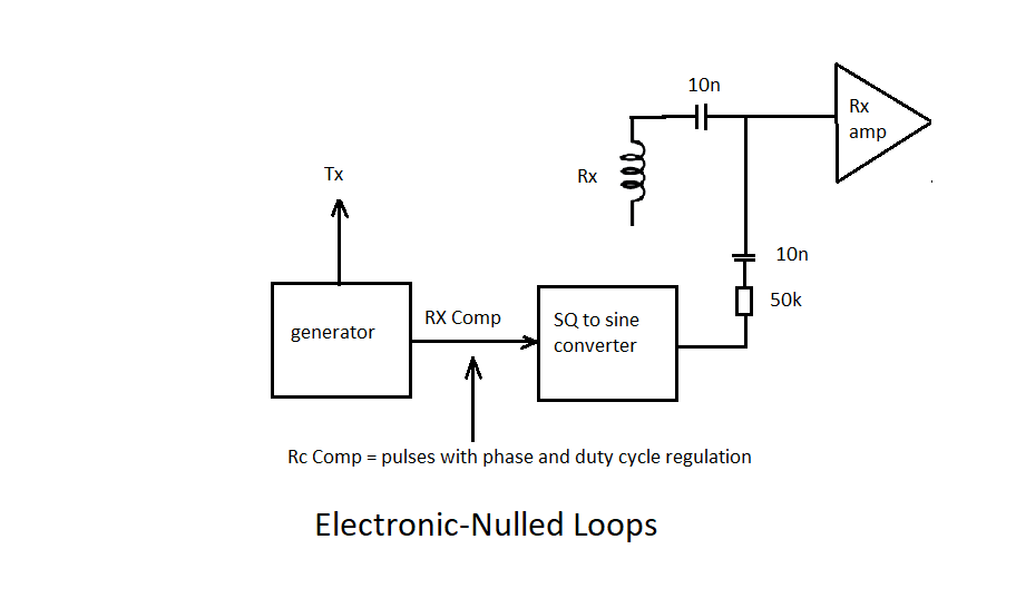

                        Here is my concept of coil nulling.​
                        Click image for larger version  Name:	nulling.png Views:	0 Size:	15.6 KB ID:	418221
                          Please see my post regarding an asymetrical pulse pattern generator.
                          If your waveform was represented by a single bit in a 360 byte array then rotating it one position up or down within the array would move it by +/1 degree.
                          ie. 180 hi then 180 lo for say bit0 repeatedly clocked/indexed out at whatever rate your processor can handle reliably.
