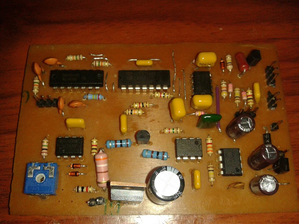

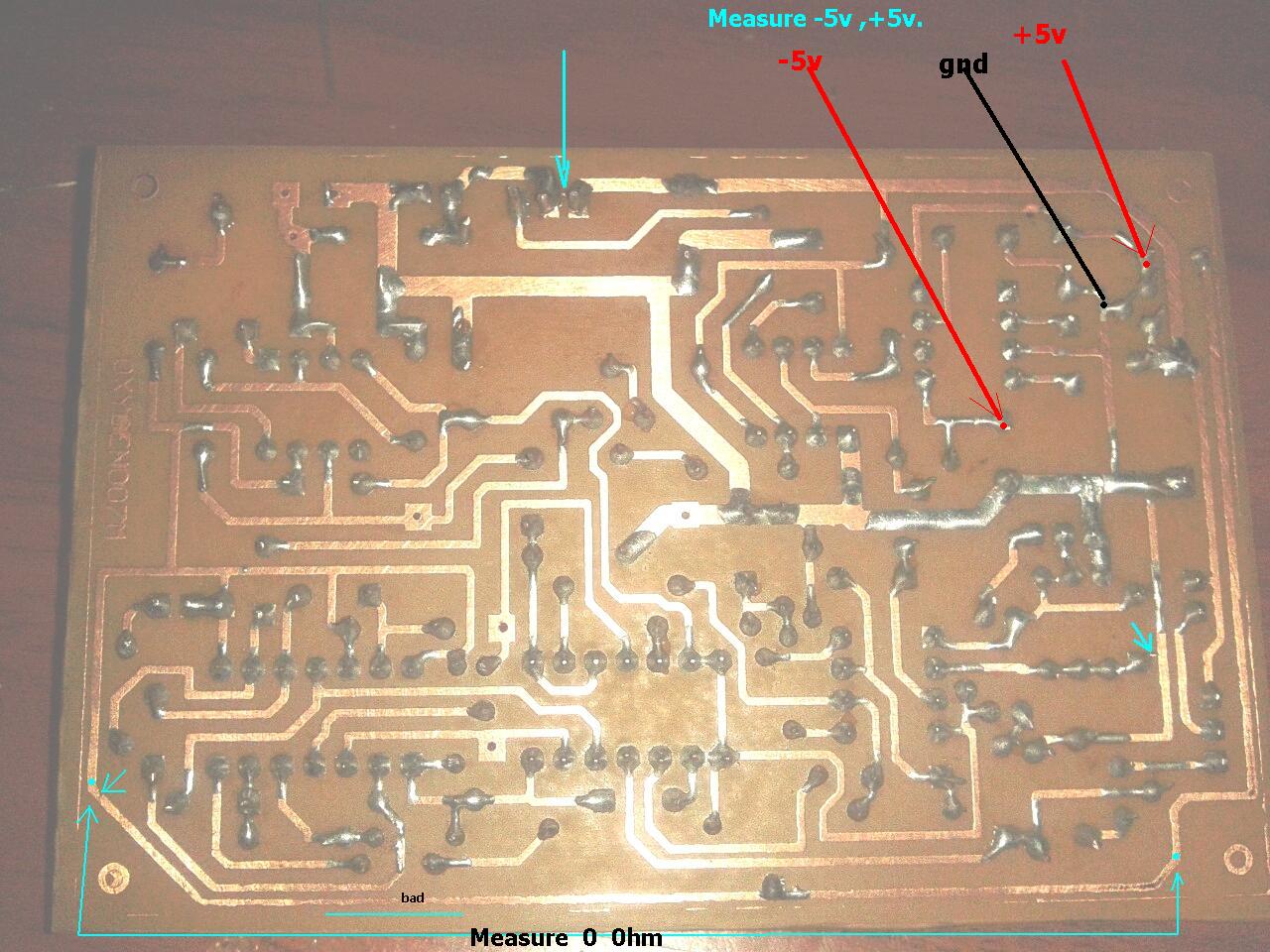

              • #52
                Hi eessoo
                -first re solder with a random suspect.
                -Compared to the work of all the components and their values ??and installed in its place, especially in the area u2,u6.
                -Measure -5v ,+5v.
                - solder,, this is good with very high quality.
                you will
                best time
                j.

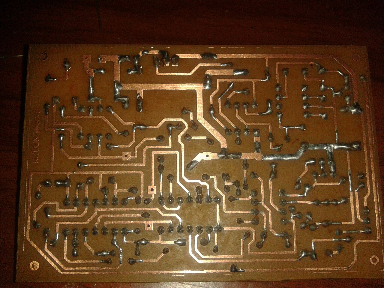

                • #53
                  i will make another one with better solder
                  • #54
                    i did another one but with the same problem
                    and U6 get a little hot
                    how can i test it to find the problem?

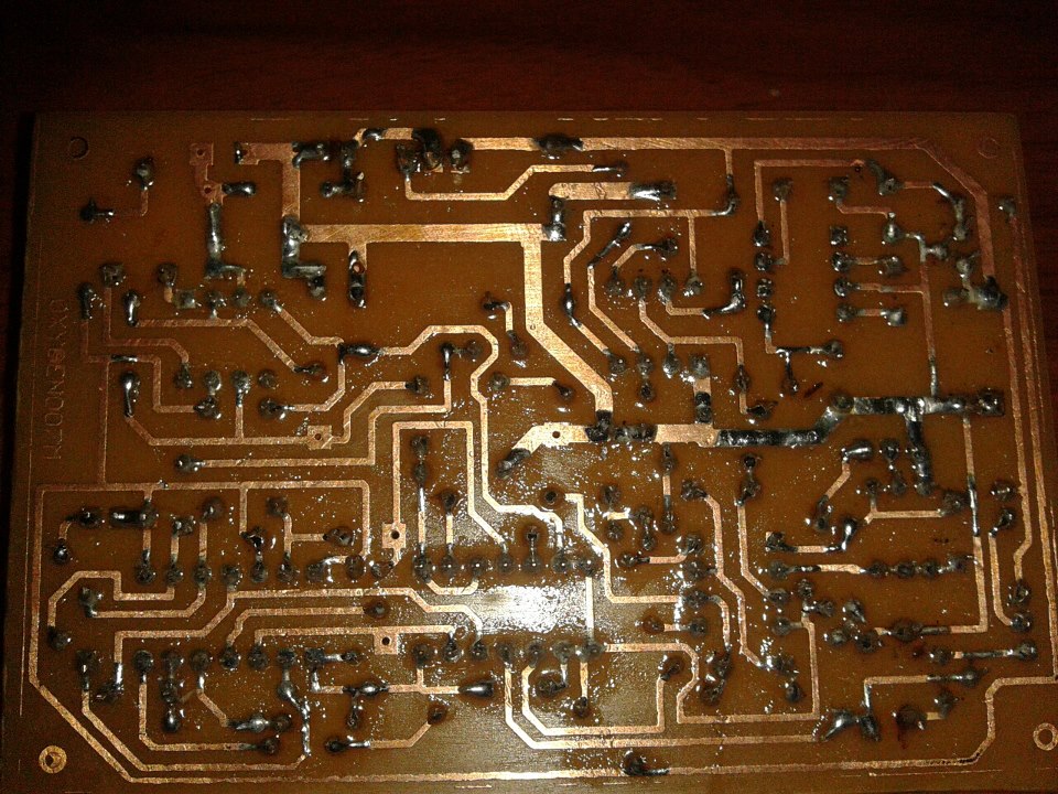

                    • #55
                      It would not hurt to clean the flux off your board. Use isopropyl alcohol, methyl alcohol, Everclear etc.
                      What is that flux made from? If it is rosin flux, it should be soaked in alcohol and scrubbed over and over if it has sat on your board for more than a few hours. Make the board spotless. Some kinds of flux must be removed with distilled water. Use whatever it takes.
                      Even if it's 'no-clean' flux it should be removed, but then don't worry about it being "spotless".

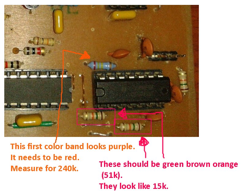

                      You need to replace those 15k resistors with 51k.
                      • #56
                        the blue resistance read 238k
                        and u are right about the 51k resistance i thought it was 15k

                        • #57
                          i used alcohol and tooth brush to cleaned it
                          should i remove the ICs and clean under them?
                          • #58
                            All clean now
                            • #59
                              Pay attention to the U6 = ICL7660, see http://www.geotech1.com/forums/showp...9&postcount=69
